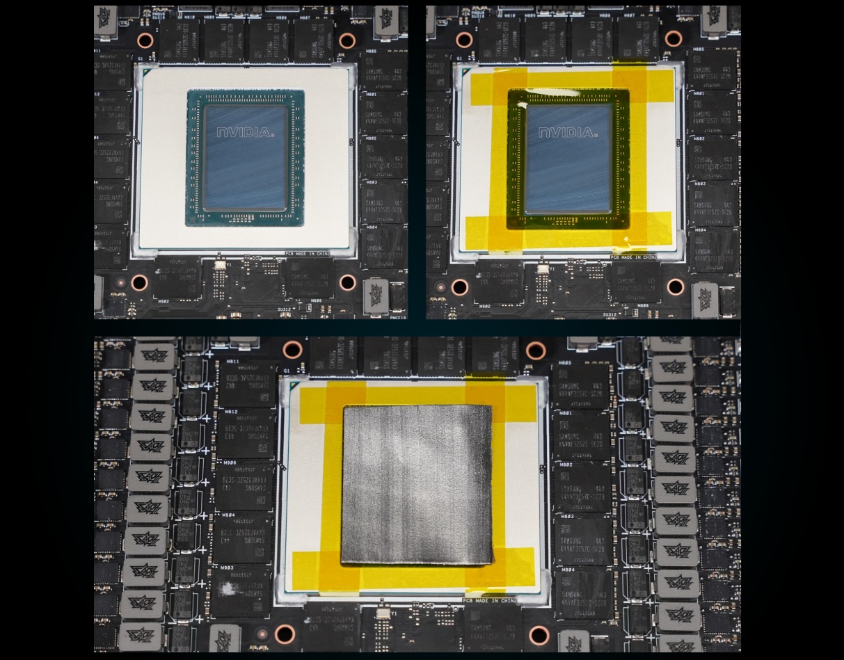

Below are some installation instructions for Thermal Grizzly’s RTX 5090-specific thermal pads. Above are some images showcasing the installation using an ASUS ROG Astral graphics card.
The following images demonstrate how to use it on a graphics card, using an ASUS GeForce RTX 5090 Astral as an example. First, the graphics chip and the surrounding area must be thoroughly cleaned and degreased (e.g., with isopropanol). After cleaning, the Kapton Insulation Sheet is applied. The Kapton strips should be aligned along the edges of the chip and carefully adhered. The Kapton strips must not be placed on top of the graphics chip!
Once all four sides next to the chip have been covered, the KryoSheet can be applied according to the instructions (steps 3 and 4). If the adhesive side of the Kapton Insulation Sheet has come into contact with the chip during application, it is recommended to clean the chip again before proceeding. Cutting the KryoSheet to size is not necessary.
