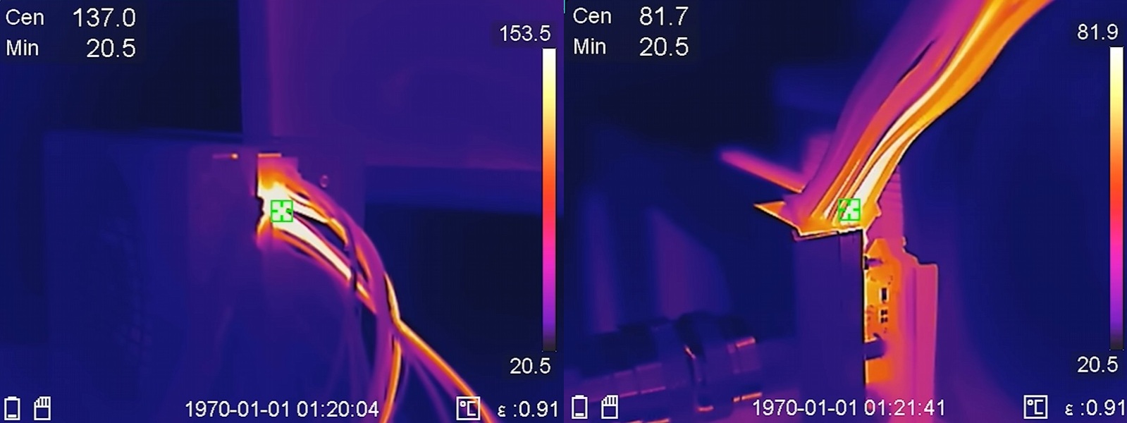

In his video below, der8auer found that his RTX 5090 Founders Edition (FE) GPU exhibited similar issues to the user with a melted power connector. GPU power was being drawn primarily through two of the cable’s six 12V wires. This meant that most power was not being split evenly across the cable, causing specific wires to overheat.
Below, we can see der8auer’s power cable through a thermal imaging camera. Note that only two power cables are getting hot. Furthermore, the PSU side of the scale is reaching 153 degrees Celsius.
Der8auer believes that prolonged use of his GPU under this load condition would eventually lead to his power cables melting. Because of this, der8auer ended his testing before those could occur.
Note that this problem only occurs because power is not equally distributed across this GPU’s 6 12V cables. Equal power distribution would prevent individual cables from becoming hotter than the others.
(Thermal Images from der8auer (PSU side Left – GPU side Right)
