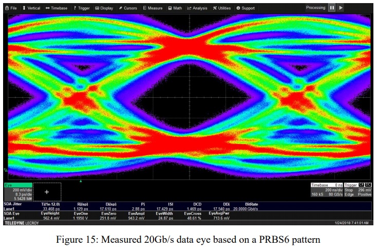

    While the preceding results demonstrate full DRAM functionality up to as high as 16.5Gb/s, it is possible for the overall performance of an architecture to be capped by timing limitations in the memory array itself. To determine if this GDDR6 interface could extend beyond the 16.5Gb/s range, the device was placed into a mode of operation which exercises only the I/O while bypassing the memory array.
The oscilloscope measurement presented in Fig.15 (below) confirms that when bypassing the memory array, and with a small, but helpful, boost in I/O supply voltage, it is possible to push Micron Technology, Inc.’s GDDR6 I/O as high as 20Gb/s.
