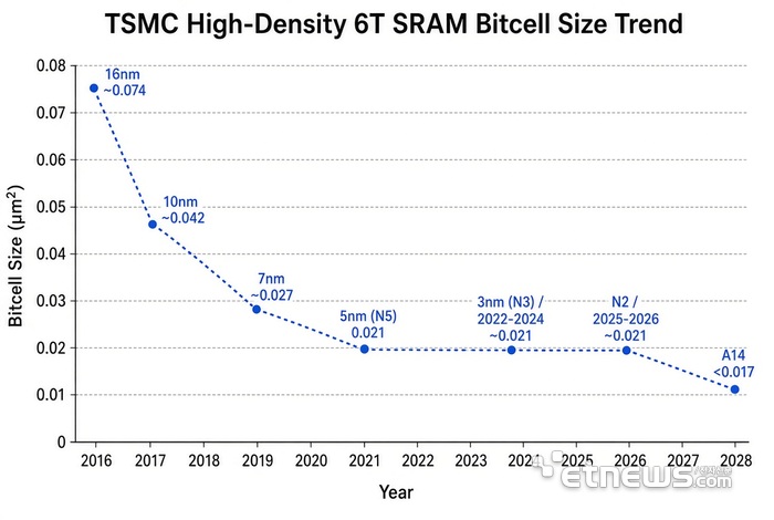

TSMC’s recent lithography nodes have suffered from a major scaling issue. SRAM scaling has stagnated for years, with 5nm, 3nm, and 2nm all having a bit cell size of around 0.021 µm². Now, according to a report from ETNews, TSMC plans to resume SRAM scaling with its upcoming A14 node, which is great news for cache-heavy chips.
With A14, TSMC will reportedly bring SRAM cell sizes down to less than 0.017 µm². That’s more than 20% smaller than the SRAM sizes of prior nodes. This should put TSMC ahead of Samsung and Intel, who are unlikely to announce smaller SRAM cell sizes with their competing 14 Angstrom technologies. TSMC will reportedly officially unveil this advancement later this year.
(TSMC SRAM density chart – via ETNews)
