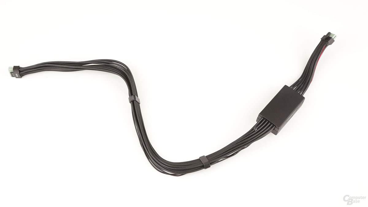

Cybenetics has created a prototype “anti-melt” 12V-2×6 power cable that’s compatible with all 12V-2×6 and 12VHPWR graphics cards. This cable replaces native 12V-2×6 power cables and features an in-line box that measures current and cable temperature. Using this data, this cable has safety features that can save gamers from a cable-melting scenario.
For extended violation of current or thermal limits, a buzzer will sound to alert users. Then, after a configured delay, your display will go dark when your GPU stops receiving power through the connector. This prevents damage to the cable and graphics card by halting the GPU’s use before heat can built up to dangerous levels.

Highly compatible, and it works with and without software
This cable can be used with any PC that has a 12V-2×6 graphics card and a power supply that features a native 12V-2×6 power connector. This means that this cable is incompatible with PSUs that use alternative cables to fuel 12V-2×6 power cables.
Using the optionalUSB Type-C cable, users can configure their power cable’s protective settings and set its limits. Users can set their over-current and over-temperature thresholds. They can also set the length of their buzzer warning and their protection “kick-in” time.

Adjustable protection thresholds
For Nvidia’s RTX 5090, an over-current trigger point of 10 amps is recommended, and an overtemperature trigger point of 80 degrees Celsius is considered sensible. Users can log their amps and temperature data and log them as Excel files.
