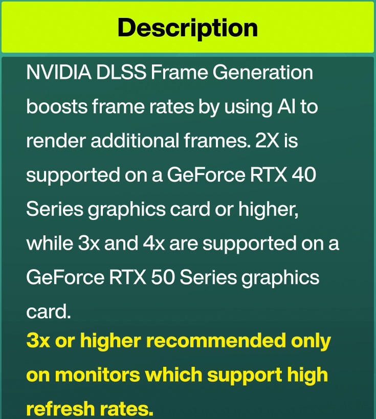

At launch, Forza Horizon already supports DLSS 4.5 Super Resolution. That means that DLSS Overrides for DLSS Super Resolution will have a limited impact. For Forza Horizon 6, at least at launch, DLSS Overrides are most useful for enabling higher Frame Generation modes. However, it is worth noting that Playground Games only recommends high levels of Frame Generation when using “monitors which support high refresh rates”. Frame Generation cannot make up for solid baseline game performance; it can only deliver additional motion clarity with AI-generated frames. As always, Frame Generation should only be used when a game already runs at a decent framerate (around 60 FPS or higher).

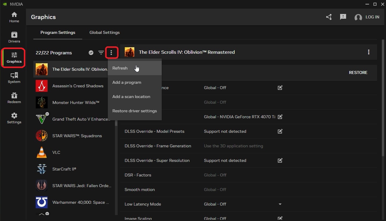

The first thing gamers need to do is navigate to “Graphics” and find Forza Horizon 6 as an installed program. If it doesn’t appear on your list, click the three-circle icon and then click “Refresh”. This should make the game appear on your list if it is installed.

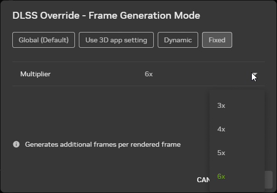

Once you find the game, you can then navigate to “DLSS Override – Frame Generation Mode”. Once you click there, a menu will appear. Within this menu, you will be able to set a DLSS Override for Forza Horizon 6, which will override the game’s selected setting. Up to 6x Frame Generation is available on RTX 50 series GPUs.

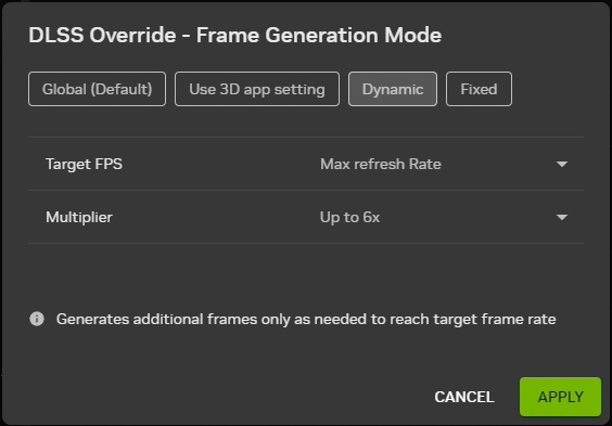

DLSS Dynamic Frame Generation can also be used with this menu, an option that is not available in-game.

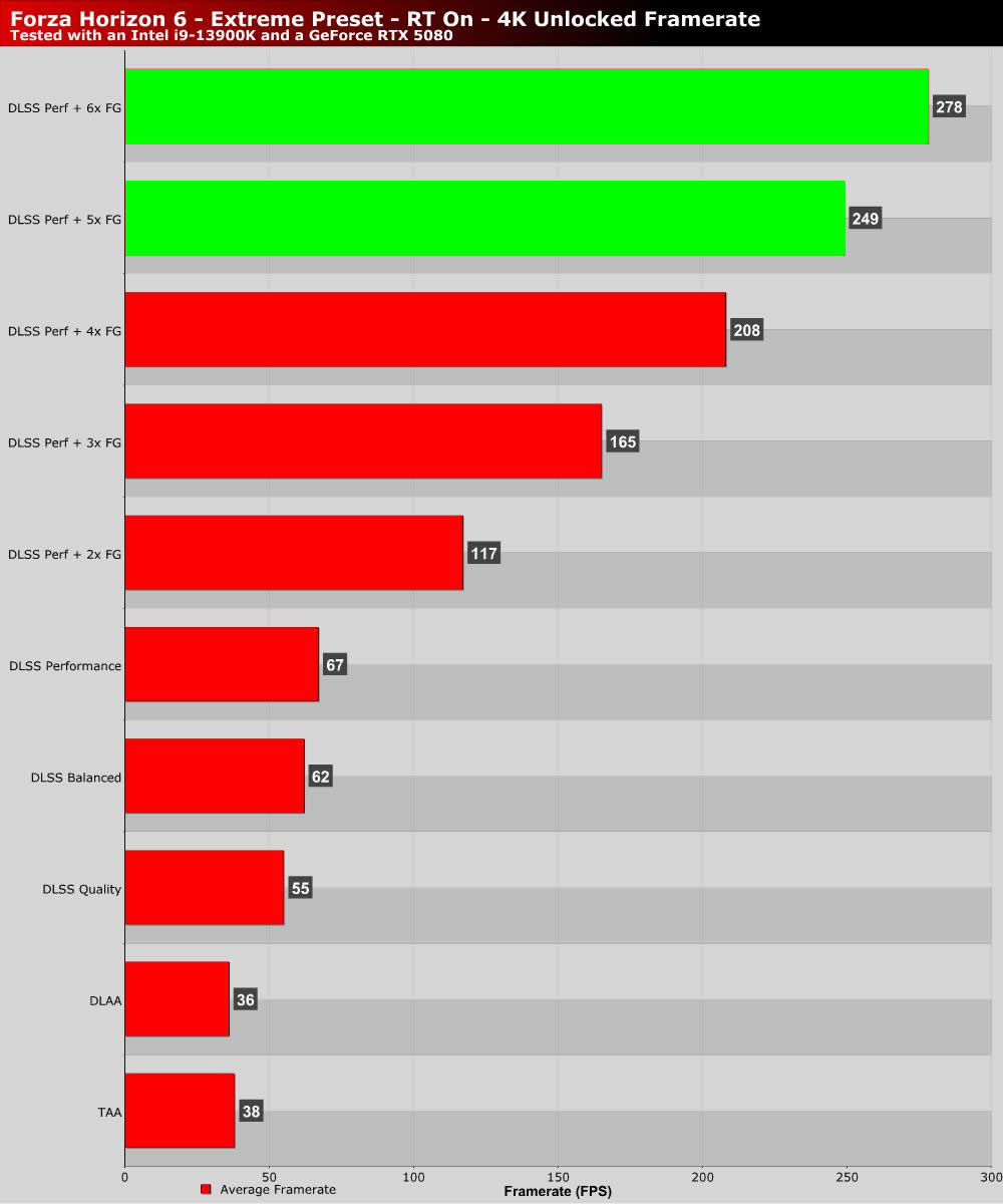

We’ve tested Nvidia’s DLSS modes in Forza Horizon 6, including the 5x and 6x Frame Generation modes that DLSS Overrides enable. Even at 4K Extreme Settings with Ray Tracing enabled, an RTX 5080 can easily max out a 4K 240Hz monitor when using DLSS Frame Generation. It’s almost like Nvidia is daring monitor manufacturers to create faster displays.
For most users, DLSS 5x and 6x modes are excessive. That said, these options make it much easier for owners of ultra-high refresh rate monitors to push their displays to the limit. Remember, 1440p 540Hz OLED monitors already exist, and most modern games cannot run anywhere close to the frame rate limits of these displays without Frame Generation.
