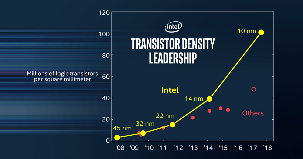

       The minimum gate pitch of Intel’s 10 nm process shrinks from 70 nm to 54 nm and the minimum metal pitch shrinks from 52 nm to 36 nm. These smaller dimensions enable a logic transistor density of 100.8 mega transistors per mm2, which is 2.7x higher than Intel’s previous 14 nm technology and is expected to be approximately 2x higher than other industry 10 nm technologies.

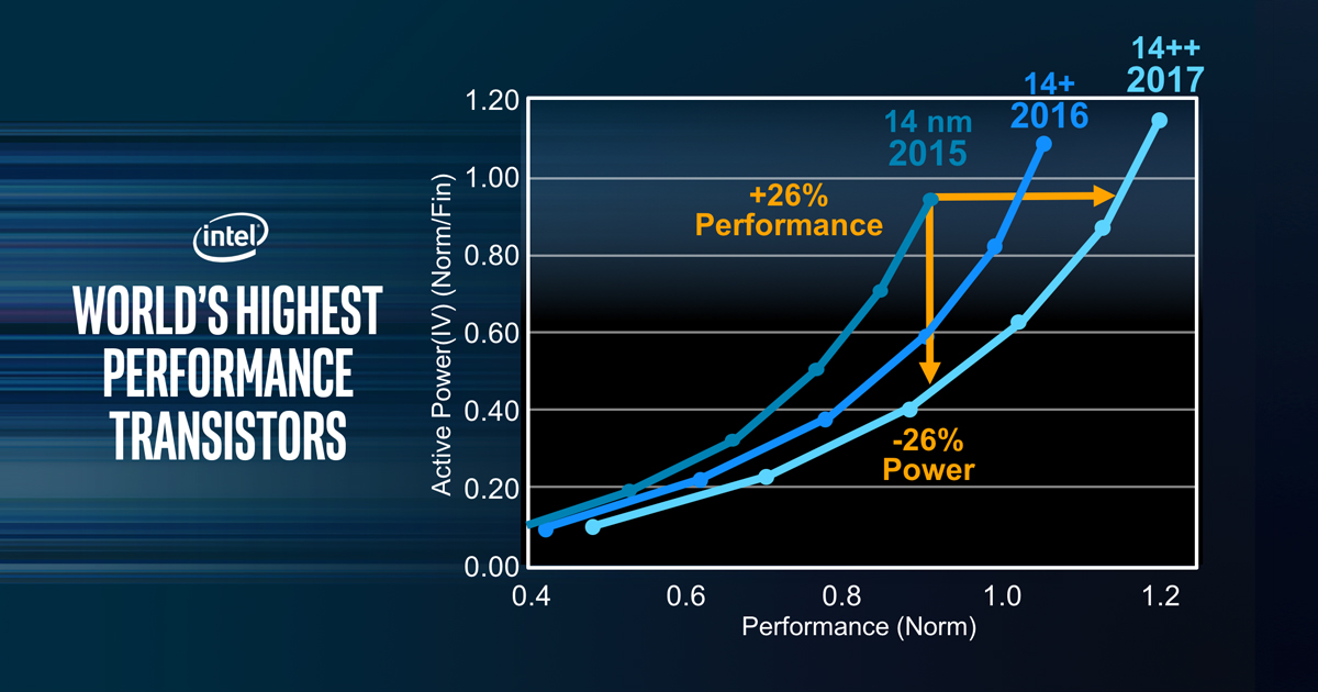

Intel’s 10nm manufacturing process has so far not yielded the performance results that Intel wanted, with their 1st generation node offering either a 25% performance boost over 14nm or 45% lower power draw. Compare this to 14nm++, Intel’s 3rd generation 14nm node, which offers a 26% performance boost or a 26% reduction in power draw when compared to 14nm.
This makes Intel better off using 14nm++ for now, as 10nm would not yield any performance gains over 14nm++, a node which likely has higher yields and manufacturing capacity. Intel’s baseline 10nm process will be superior for low power designs, but not for high-end products.
Intel already has already created their 10nm+ node, which will offer a 15% performance boost over 10nm, with up to a 30% reduction in power, which is more than enough to make it a suitable replacement for 14nm++.
     Intel’s 10 nm process delivers up to 25 percent better performance and 45 percent lower power than the previous 14 nm technology. A new, enhanced version of the 10 nm process, called 10++, boosts the performance an additional 15 percent while reducing power by another 30 percent.

Intel right now are the only major Fab that properly scale their node naming schemes with their process node sizes, giving them what could be defined as the “best” processing technology in terms of transistors per unit area.
