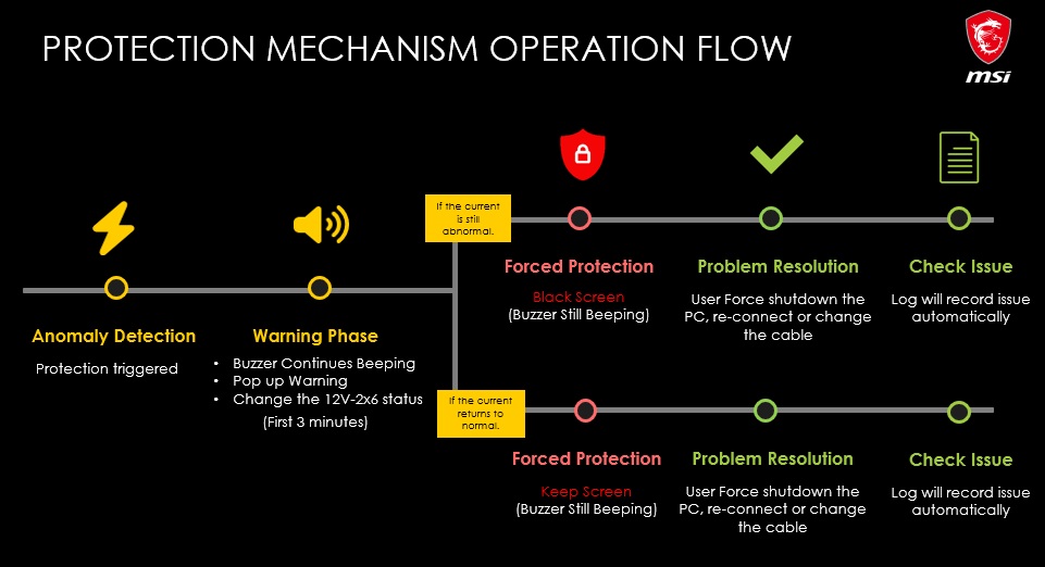

Below is a chart for how Safeguard+ works when an unbalanced electrical current is detected.

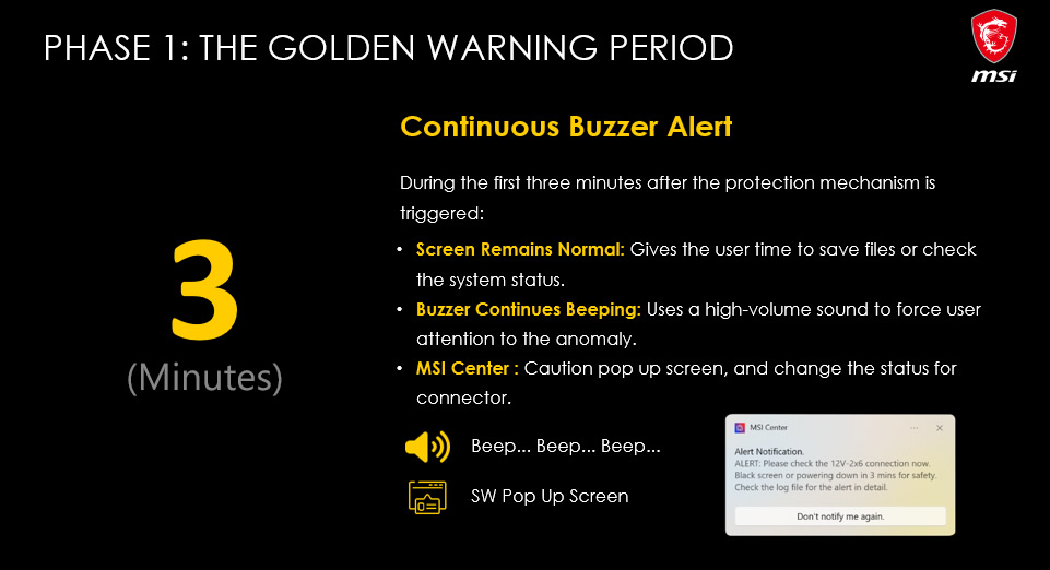

Phase 1
When protection mechanisms are activated, the system will run as normal, but users will see a pop-up alerting them to the error. Additionally, their PSU will start to beep. These two actions should prompt users to save their files and check their system status. This stage lasts for three minutes.
It is worth noting that this alert happens when the error is detected, not when heat buildup occurs. This means the error is detected before excessive heat buildup occurs. This gives users time to save their work before their system shuts down.
Software and hardware warnings and protection
Below, we can see MSI Center measuring the current draw from each cable on a 12V-2×6 power cable. If abnormalities are detected, a warning will be displayed to users. This data is logged for future reference, should users need it.
Phase 2
After three minutes, your PSU will enter a forced protection state. Power delivery to your graphics card will cease unless the power anomaly ends. This will cause your screen to go black. Your PSU will continue bleeping during this stage.
Phase 3
After their system enters protection mode, users should power it down using a forced shutdown. After this, users should check the condition of their system. The user should reconnect or replace their 12V-2×6 cables if necessary.

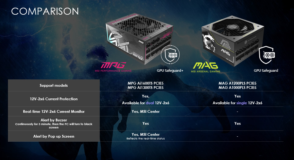

MSI GPU Safeguard+ VS GPU Safeguard
With their MPG AI1600TS PCIe5 and MPG Ai1300TS PCIe5, MSI offers its GPU Safeguard+. This means that they have 12V-2×6 current monitoring and protection, a buzzer alert, real-time 12V-2×6 current monitoring, and a PC pop-up alert if issues are detected.
MSI’s MAG A1200PLS PCIe5 and MAG A1000PLS PCIe5 PSUs only feature 12V-2×6 current protection and a buzzer alarm. Both sets of PSUs power off GPUs after three minutes, offering a similar level of protection. However, only GPU Safeguard+ PSUs have added MSI Center support, real-time monitoring, and analysis features.
