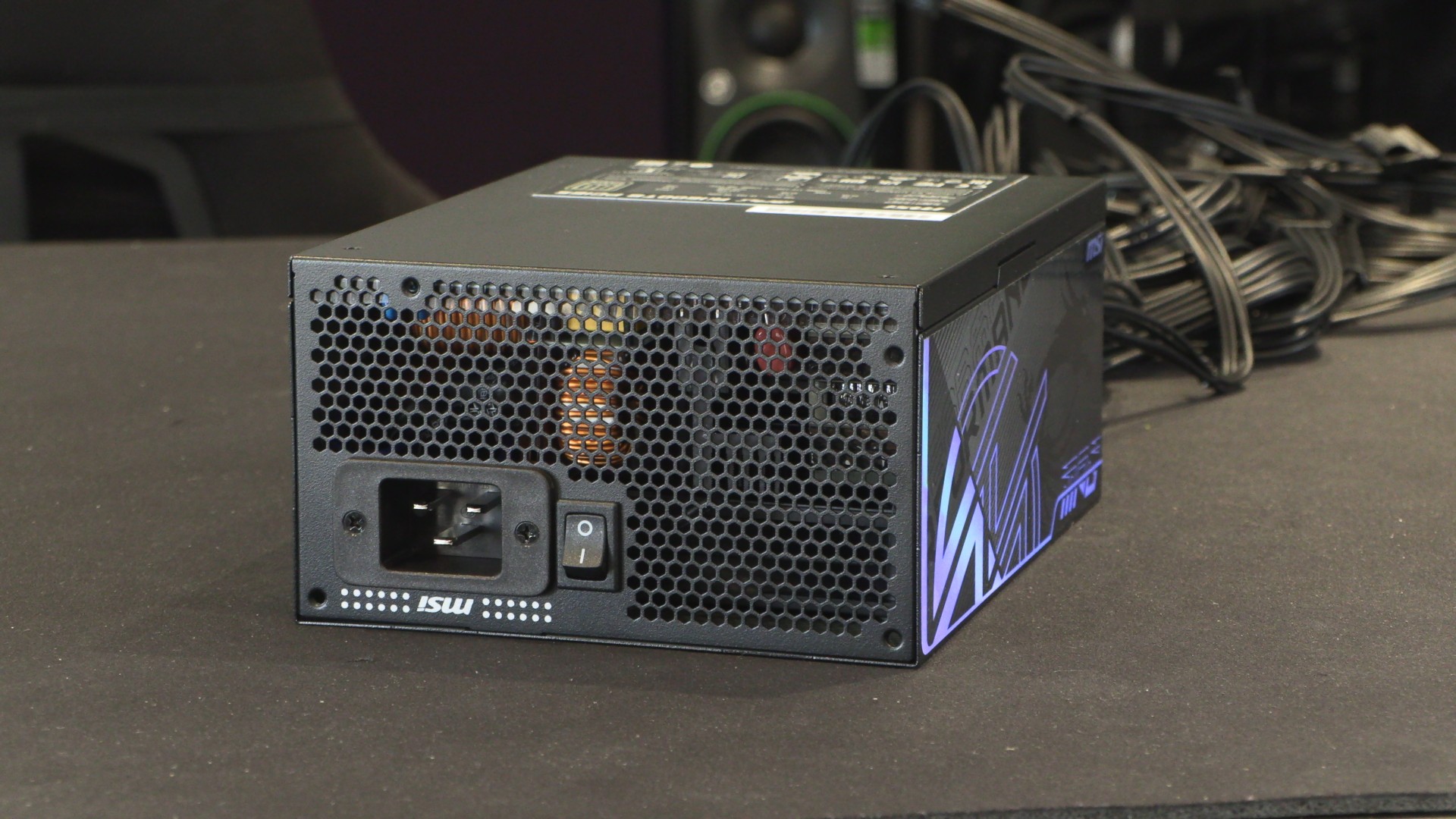

Note that this PSU does not use a standard “kettle lead” like most normal PC power supplies. This PSU uses a chunky C19 connector, which from the outset shows that this PSU means business.

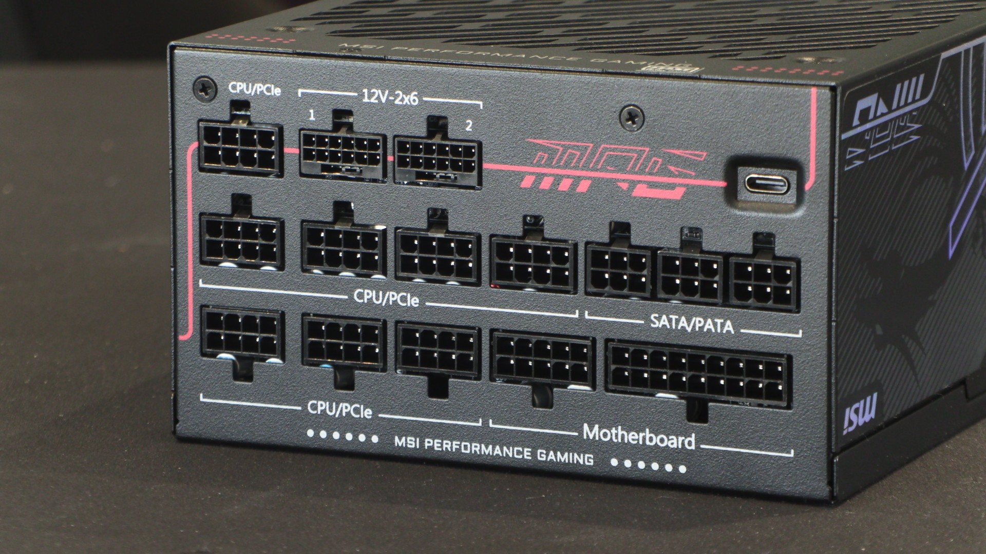

As is becoming more common these days, MSI’s MPG Ai1600TS PCIe PSU features dual 12V-2×6 outputs. Is this a telltale sign that we will see more GPUs with dual 12V-2×6 power connectors? Perhaps. Or maybe Nvidia has a scheme to re-implement SLI for today’s gaming workloads? Jokes aside, the second 12V-2×6 output is there if you need it.
To enable system-level PSU monitoring and control, you will need to install MSI Center and connect your PSU to your motherboard using the USB Type-C connector pictured below.

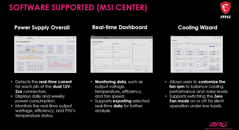

MSI Center Software – Monitoring and control
Using MSI Center, users of this PSU can monitor their PSU’s power input, power output, and the condition of the PSU’s 12V-2×6 power connectors. Voltages, temperatures, and efficiency levels are monitored, and this data can be exported for additional analysis.
Using this software, users can define custom fan curves and enable a zero RPM fan mode for low load conditions. Users can also monitor their PC’s daily and weekly power consumption. If you like data, you will love MSI Center.

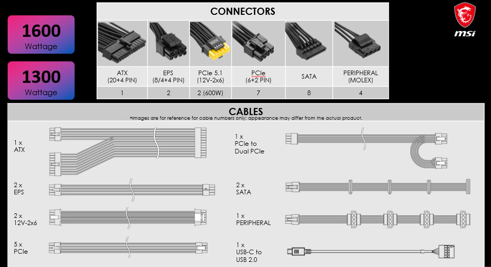

All cables with this PSU are black and embossed, giving each a braided aesthetic. Both the 1600W and 1300W versions of this PSU ship with the same modular cable options. This includes a single ATX 20+4-pin motherboard cable, two EPS/CPU 8/4+4 cables, two dual-colour PCIe 5.1/12V-2×6 cables, seven PCIe 6+2-pin connectors (across 6 cables), two SATA power cables with  four connectors each, and a single Molex/peripheral cable with four connectors. A single USB Type-C to USB 2.0 cable is provided for MSI Center connectivity.
