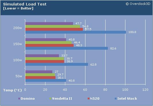

Simulated Load Test
For the simulated load tests the coolit was run at it’s highest setting, to keep it on par with the other coolers tested who had their fans run at full whack. The points of 50, 100, 150 and 200 watts were used and ambient temperature throughout testing was 20°C (+/- 0.5°C).
These results speak for themselves. The Domino running at full has outperformed everything tested so far on the load simulator by a good margin. the most impressive being under 50°C on the 200w test.
