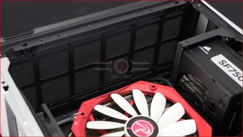

Cooling-wise, users of the Era ITX will also be heavily restricted, as the case’s limited width and rear-mounted 80mm fan will limit this case’s users of AIO water cooling or top-down coolers like Noctua’s L12 series or OEM coolers like AMD’s Wraith series. We used Raijintek’s 140mm Pallas cooler for this review, but this heatsink would be a tight fit if we hadn’t used an SFX power supply.
We also tried to mount be quiet’s Dark Rock TF cooler into this case, but it proved to be too large. This makes careful CPU cooler selection a must for the Fractal Era ITX.

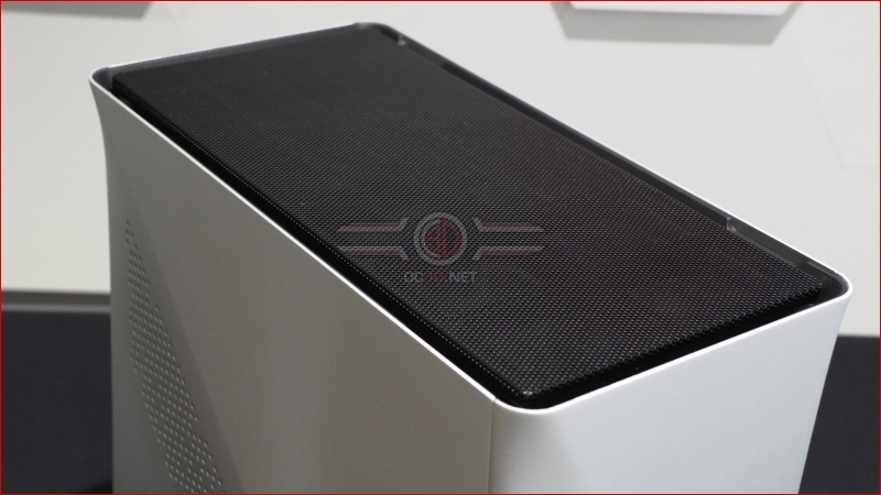

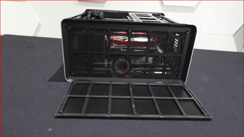

At the top of the Era ITX, users should see a Nylon meshed section which will help keep dust out of the enclosure. All dust filtering in the Era ITX is made using a nylon mesh, offering up to 2x more airflow than standard plastic mesh.
A magnetic top mount for this mesh makes it incredibly easy to remove and clean when necessary. Similar filters are found on the bottom of the Era ITX and on the enclosure’s side panels.

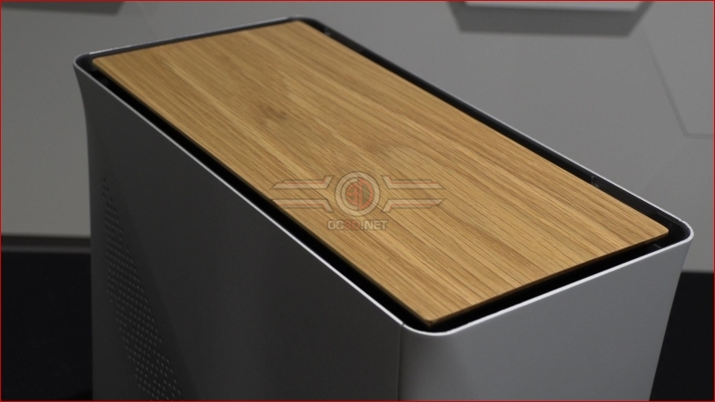

The Silver version of the Era ITX that we received came with two top panel options, a White Oak panel and a Black Mesh panel. The White Oak panel is designed to be aesthetically pleasing, while the mesh panel is designed to enable increased airflow within the Era ITX.
Personally, I would have liked to have seen this Oak Panel option come with some spacers to give the Era ITX a little more room to breathe. While modders can add this option themselves if they wish, it would have been nice to have seen Fractal do this themselves. That said, they did provide a mesh option, which is enough to address the top panel’s airflow concerns.
Other versions of the Era ITX come with a tempered glass top panel or a Walnut wood panel, depending on your chosen case colour.

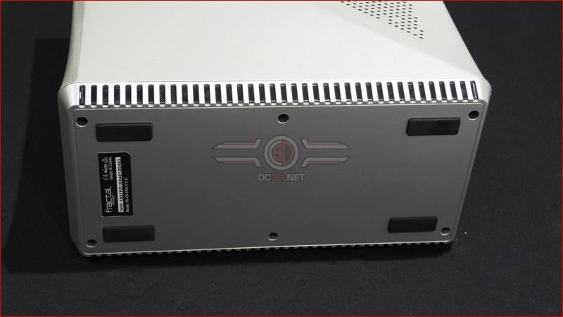

Moving to the base of the Fractal Era ITX, we can see that the bottom of the case only has vents on the side of the enclosure, something which will limit potential air intake.
If given the option, we would have added longer feet to the base of this enclosure and added mesh to the bottom of the chassis. If possible, we would also have found out if it were possible to have a graphics card within this system and a set of 140mm fans, as this could deliver considerable improvements to this ITX case’s airflow, even if the 140mm fans were low profile models.
These kinds of limitations are common for ITX case designs, and there is no reason why a skilled modder couldn’t open up the bottom of this case to enable more airflow. Fractal’s Era ITX design clearly called for a smooth bottom, but we can see this design decision being a huge bugbear for some users.
When using an SFX power supply, Fractal’s Era ITX has enough space for a 240mm radiator or dual 120mm radiators, allowing the case to deliver high-end cooling to your CPU or provide 120mm liquid cooling options for both your CPU and graphics card. That said, liquid cooling a graphics card in this case will require long AIO tubing runs and careful tubing routing.
