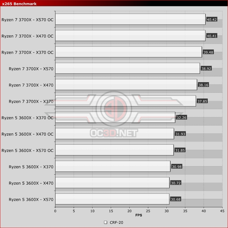

x265 – Zen Comparison
We love graphs like this. It backs up our experience which was the basis for testing the way that we do. We knew that the Ryzen 5 3600X would work well on the X370 motherboards but that the Ryzen 9 3900X would ask too much of them, and therefore we’ll include the Ryzen 7 3700X to see how flexible the X370 is. Sure enough the X370 is more than capable of running the Ryzen 5 3600X flat out, but the needs of the Ryzen 7 3700X are enough that it is in chronological order, newest to oldest.
