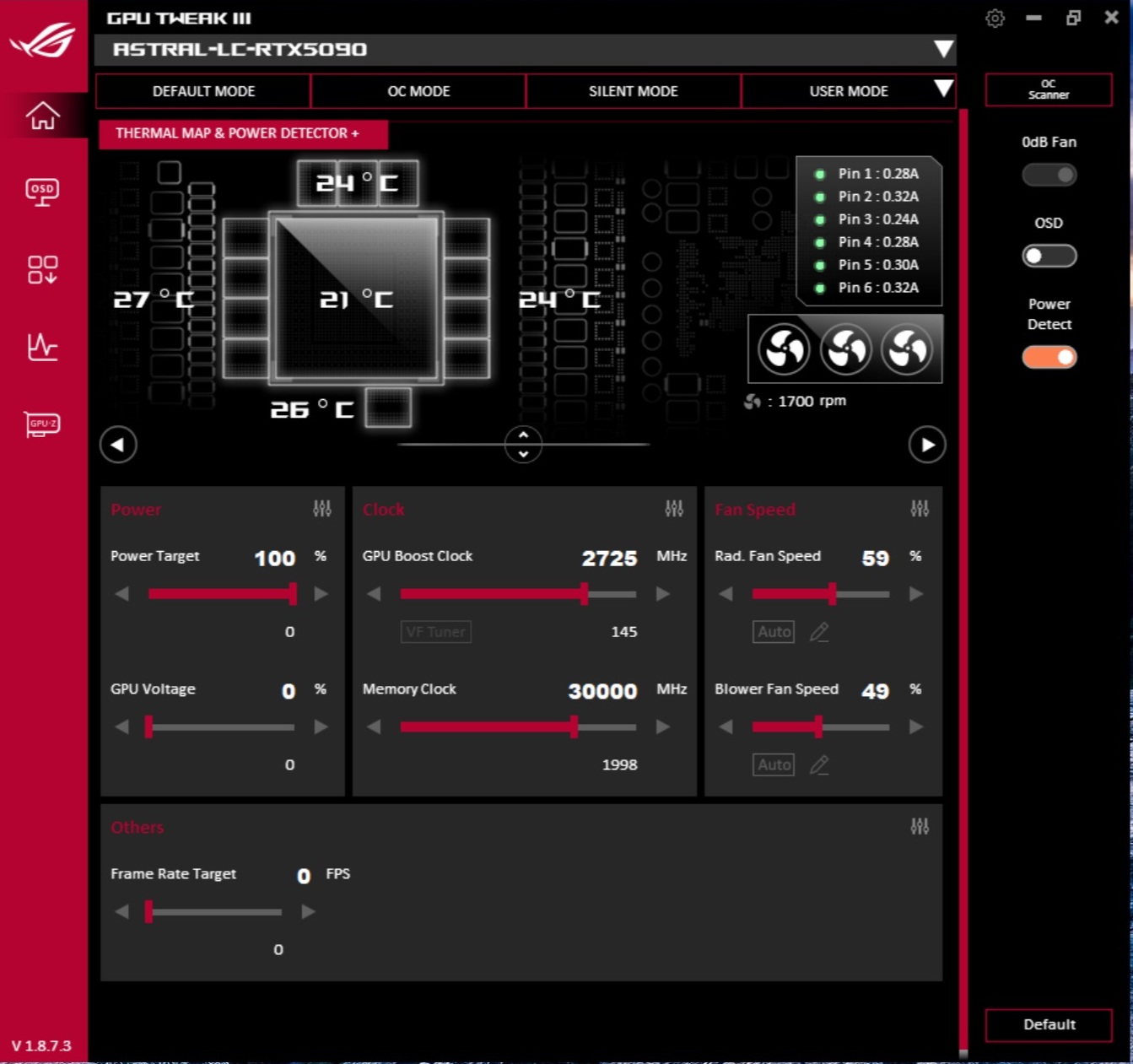

However, once the Amp draw passes 9A then the wear is most likely to cause issues. The ASUS GPU Tweak III software will now point out which pins are the problem. Here can can clearly see which of ours are more worn than the others.

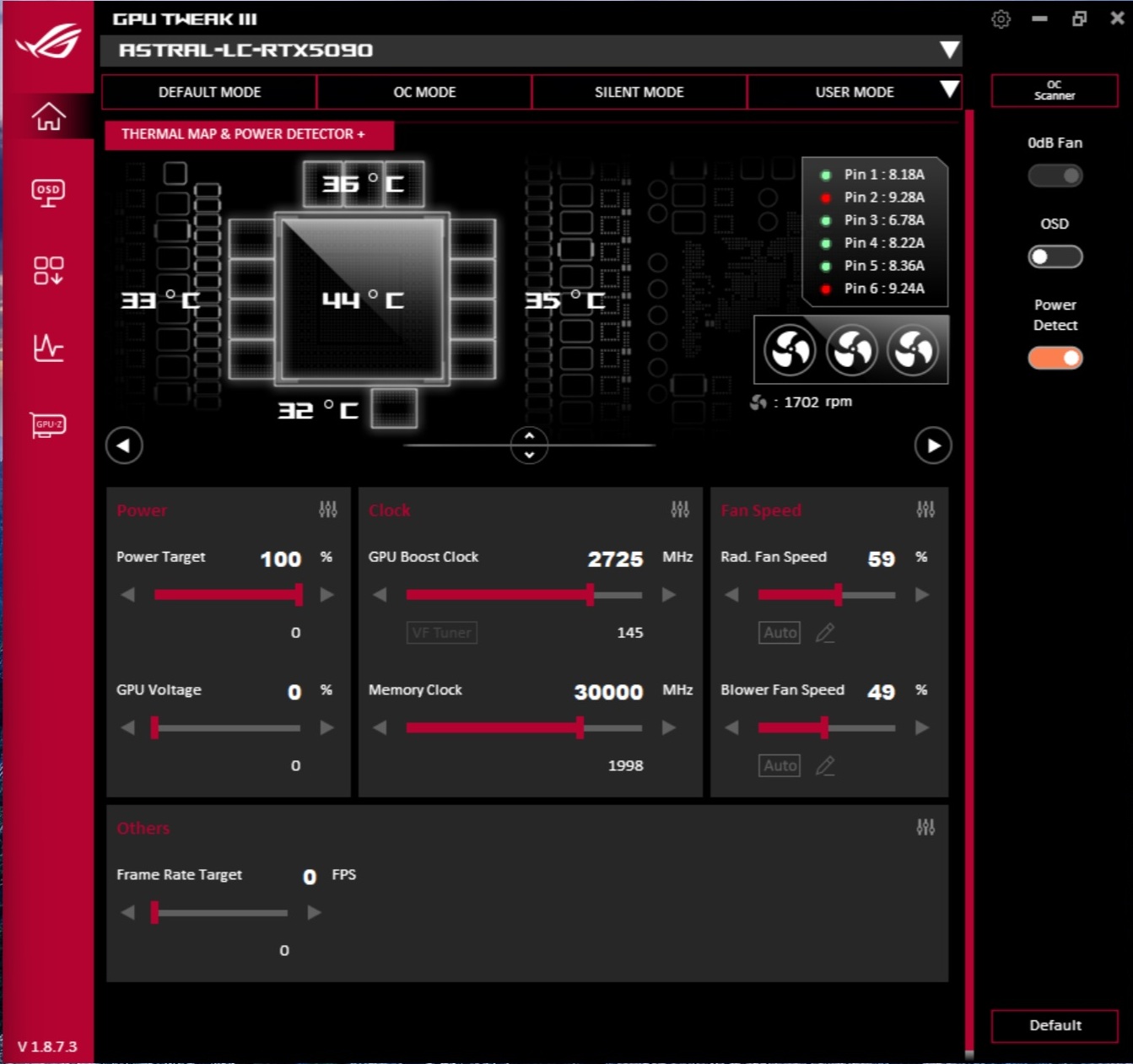

As the card clicks through it’s power demands until it hits the peak, we gain another pin problem. We’re stunned at how useful this feature is. Anything that can save a melted cable will also save your GPU. At this price, we want it saved.

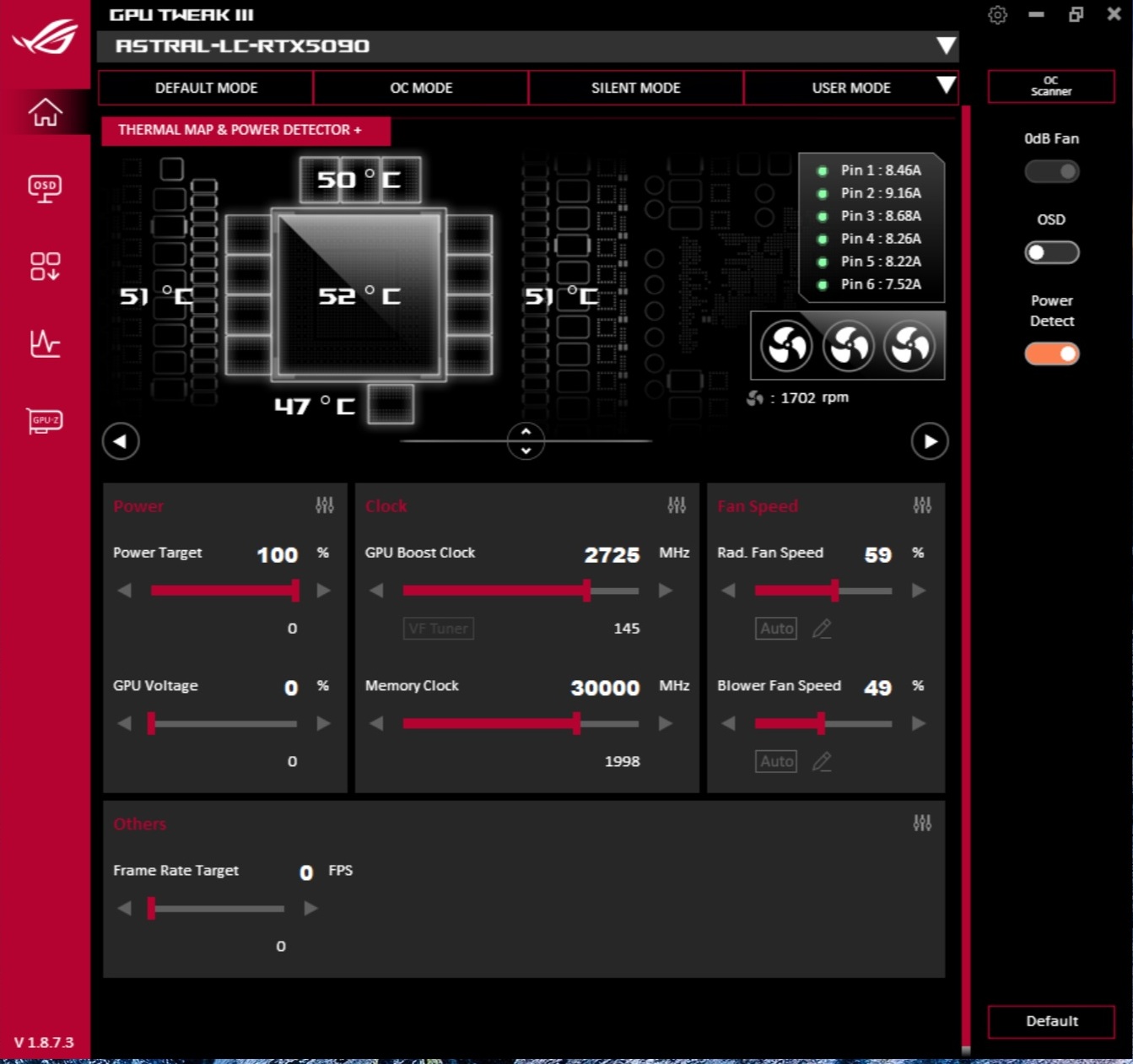

The second of our two cables is newer and thus has been abused less. As you can see the total Amp draw is where the problems occur. At 9.2A we have a red pin, but the image below with it dropped to 9.16A it’s okay again. Think of it like when you go to the dentist and they point out a small hole that will need filling but not today. Above we need to replace it immediately. Below we’ll be okay for a little bit but it would be prudent to get a new one.
