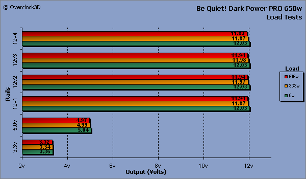

To provide our readers with the most accurate results, Overclock3D uses a custom built PSU load tester on all reviews. This not only gives much more reliable results than the testing methods employed by other sites, but also allows for all current and future review results to be compared side-by-side. The following table shows the load (in watts) that was applied to the Dark Power PRO 650w during testing.
A common practice among some manufacturers is to “over-volt” the rails on their PSU’s. This often leads end-users to believe that they have purchased a high quality PSU just because it can maintain voltages above the rated outputs (3.33v, 5.00v & 12.00v), when in reality the manufacturer has simply set the idle voltages as high as possible just to compensate for fluctuation under load.
From the graphs above, it is clear to see that Be Quiet! is not one of this companies. With idle voltages almost exactly on their ideal levels across and very little fluctuation under full load, the Dark Power PRO performs just how a high quality PSU should.
