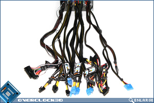

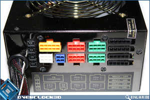

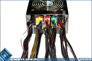

While most manufacturers tend to hard-wire the ATX and 4/8-Pin CPU cables into their modular PSU’s, be quiet! have decided to only hard-wire the 24-Pin ATX connector. This may seem slightly strange at first, but as the unit supports both P4-12v, EPS 6-Pin and P8 (Server style) motherboard connectors it helps to cut down on additional cable clutter.
2 x cable for peripherals 600+150+150+150mm ( 4 x HDD )
1 x cable for peripherals 600+150+150+150mm ( 3 x HDD / 1xFDD )
2 x cable for SATA connector 600+100+100+100mm (4 x SATA) include 3.3V

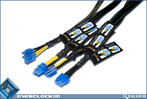

4 x cable for PCIe connector 600mm with 8pin to 6+2pin
1 x cable for P8 connector ( 8 pins ) 600mm
1 x cable for P4 connector ( 4pin ) 600mm
1 x cable for Motherboard ( Molex 4pin ) 600mm
1 x cable for mainbord ( Dualboard ) EPS 6pin 600mm
4 x cable for case fans ( controlled by PSU ) 700mm ( 1 x Molex / 1 x 3pin )
1 x cable for peripherals 500mm ( 1x HDD )
2 x cable for SATA 500mm ( 1 x SATA )

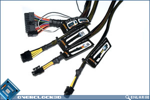

Similarly, the ATX connector can also be converted from the latest 24-Pin standard down to 20-Pin for older motherboards by simply removing a 4-Pin connector block.
