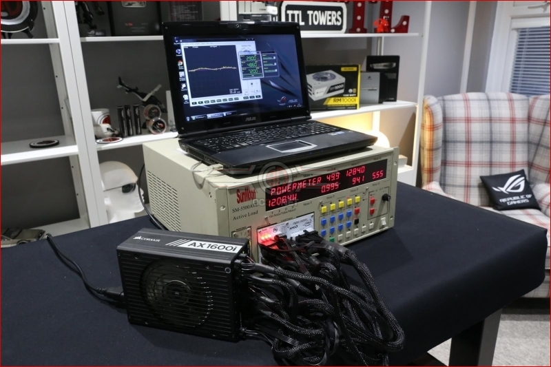

When testing new power supplies, we use our dedicated SunMoon test equipment, one of the most expensive (if not the most expensive) tools in the companies arsenal. Here we can see exactly how well a unit can function, looking at its efficiency and power stability, giving us an in-depth look at the performance of power supply than directly loading it up with high wattage hardware and seeing if it runs.
In our video review (next page), Tom will show you this unit in operation, though please note that this piece of equipment is only rated to test power supplies at up to 1200W, making us unable to place the AX1600i under full load. Even so, we will be able to showcase the performance of this unit at these lower wattages to offer the best analysis we can with the tools we have available.
