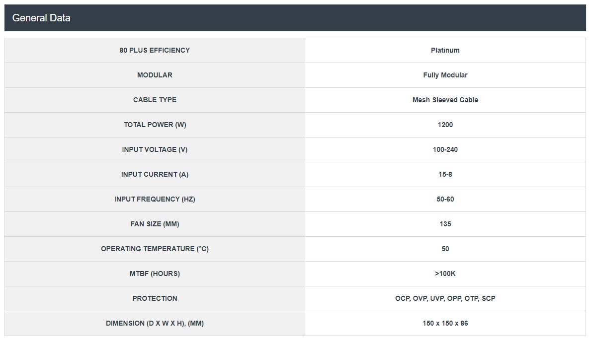

The Enermax PlatiGemini 1200W is an 80+ Platinum Rated power supply with a semi-fanless design, ATX 3.1 and PCIe 5.1 certification, and 100% Japanese capacitors. At up to 60% loads, this power supply will run with its fan disabled, and only activate it under higher loads. This PSU also has a Cybenetics Platinum efficiency certification.
This power supply is designed to handle power surges of up to 235% for short durations. This is much higher than most older PSUs, as this high power surge/excursion threshold was mandated by the new ATX 3.1 standard.
The PlatiGemini ships with fully modular cables, all of which are sleeved. This PSU also ships with a 27-piece cable comb kit, which will allow users to keep their cable management in order and make their PSU cables look incredibly neat.
