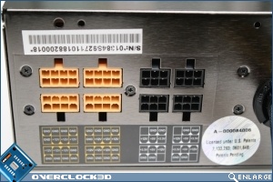

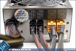

As I already mentioned over on the previous page, the Z1000M comes complete with eight modular headers that are split equally between the PCI-E and SATA/Molex connectors. This is just a tad on the low side for a 1000W PSU with most of the competition managing around 10 connectors. Still, unless you’re planning a Tri-SLi Watercooled system with a tonne of hard disks, the eight headers should be more than adequate.

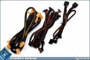

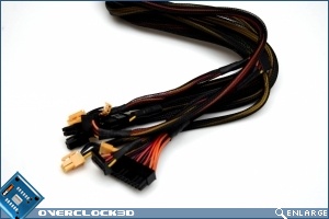

All of the cables on both the hard-wired and modular front are sleeved in a black mesh right up to the end of each connector and finished off with black heatshrink. While this certainly isn’t as fancy as the flat style modular cables on a lot of Corsair’s PSU’s, it gets the job done and the quality of the finish on each cable is very high.

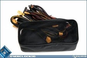

Moving on to the number of connectors included with the Z1000M reveals some rather shocking results. Only three, yes count them…1…2..3 Molex connectors on a single modular cable have been provided in the cable bag. This is in contrast to the whopping 12 SATA connectors (3x Hard-Wired / 9x Modular) provided with the unit. Now I understand that OCZ probably want to shift a few of their Solid State Disk Drives, but guys this isn’t the way forward!
Anyway, on a more serious note after contacting OCZ with these findings they have made alterations to their retail units to include an additional two Molex based modular cables in the bag. This brings the total number of Molex connectors up to 9. Much, much better guys. It’s always good when a manufacturer acts upon our findings.

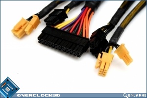

On the hard-wired connector front the Z1000M is fitted with a 24-Pin ATX connector which cannot be reduced down to 20-Pin for older motherboards. The EPS-12v connectors however, comes in both 4+4 and native 8 Pin formats which permits use on older motherboards and more power hungry dual-connector motherboards such as the high-end eVGA range. For the PCI-E connectors OCZ have gone for a native 6-Pin format with an additional 2 pins tagged on the side to enable use with all current graphics cards.

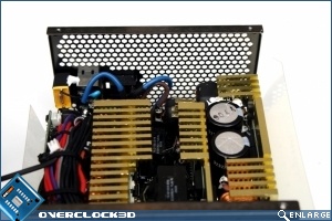

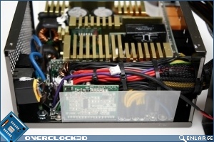

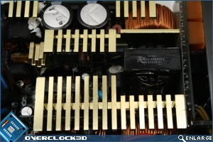

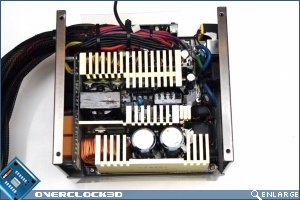

Removing the four small screws on each corner of the fan area and lifting off the lid reveals the Z1000M’s internals. Although I certainly wasn’t expecting oodles of free space inside the unit given its diminutive dimensions, it has to be noted that everything appears to be quite cramped. While this would normally send alarm bells ringing regarding potential heat issues, the three rows of gold coloured aluminium heatsinks attached to the PSU’s mosfets are designed in such a way that they can effectively make use of the PSU’s cooling without obstructing airflow to the components beneath.
Going in for a closer look at the some of the components we can see that OCZ have used a single transformer to deliver the majority of the 1000W that the unit provides. However, as is common on most PSU’s a second much smaller transformer can also be spotted nearby. This one has the job of delivering the 6A output of the 5VSB rail when the PSU is in standby.

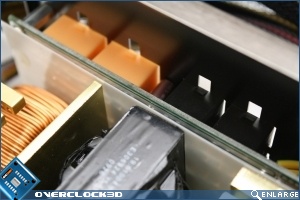

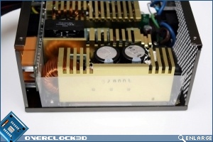

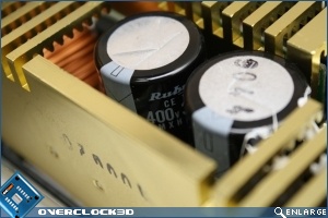

The capacitors used on the primary (high voltage) side of the unit are manufactured by Japanese company Rubycon, and while not quite as well known as the likes of Nippon Chemicon, still promise great performance and longevity. Obtaining the specs of these capacitors was certainly no easy task due to their orientation and surrounding components, but from what I could just about make out (without cracking out the soldering iron) are rated at 400v / 330uF / 105c.

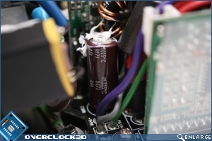

Over on the secondary side it’s time for me to eat my words as OCZ has has splashed out on an array of Nippon Chemicon 105c caps for the low voltage filtering. No other specs are visible, but If i manage to dig up any more info I’ll be sure to add it.

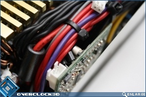

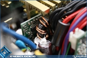

Although almost impossible to see, it would appear that the two vertically mounted PCB’s in the two pictures above are more than likely the DC-DC boards for dropping the main 12v output down to 3.3v and 5v for the other rails. Once again, without pulling the whole PSU apart it’s pretty hard to say for certain, but there’s definitely some solid state caps and chokes on there that look promising.

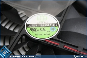

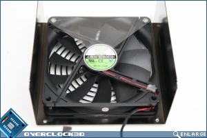

The 135mm fan is manufactured by Globe Fan and is rated at 1500RPM/106.86CFM/29.2dB. I have to say that the noise output does sound (no pun) a bit optimistic given the CFM output of the fan, but I’ll be sure to put my ear up to it on the next page as we enter the simulated load testing…
