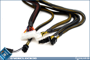

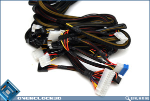

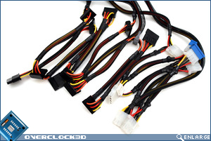

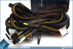

And here’s the bundle of cables now. As we can see you do really get quite a lot of cables with the Silencer 910, which of course is a good thing if you intend on putting the 910w of power to full use. Each and every cable is sleeved in a black mesh right to the tip and finished of with black heat shrink. Even the small amount of wire between each of the connectors on the Molex and SATA plugs is sleeved to perfection. Good job PCP&C.
But wait, maybe I’ve been deceived by the Silencer’s large bundle! According to the chart above you get a total of 4x PCI-E cables, 12x SATA Cables and 7x Molex cables. This is significantly less than the likes of Corsair’s recently reviewed HX850W, which weighed in with a total of 6x PCI-E, 12x SATA and 12x Molex. In fact, in it’s current form the Silencer 910 has the balance of Molex-to-SATA connectors completely the wrong way round for the average enthusiast who will more than likely require no more than four SATA connectors, but possibly more than seven Molex connectors.

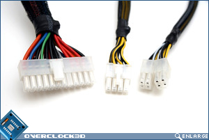

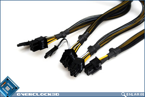

The ATX connector is of the 20+4 Pin variety meaning that a block of four pins can be snapped off the end of the connector to reduce it down to the older 20-Pin standards. Two EPS-12v connectors are also provided, one which can be snapped in half to support the 4-Pin P4-12v standard while the other is native 8-Pin. Similarly, two of the four PCI-E connectors can be switched between 6/8-Pin standards by use of an additional 2-Pin connector for supporting high-end graphics cards.
As a side-note, PCP&C you need to make up your mind if you’re going to use white or black connectors. Black would be my preference – white is so 90’s!

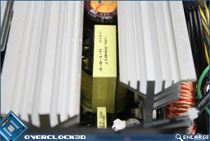

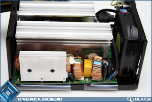

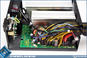

Moving on to the internals of the Silencer 910, the OEM is instantly recognisable as Seasonic with some slight similarities to the X900 reviewed back in 2007. Two large aluminium heatsinks span the length of the unit with horizontal fins designed to make maximum use of the air being pushed through the casing by the 80mm fan. All cables are neatly bunched together and there are some quite large voids inside the unit which will undoubtedly assist with cooling.

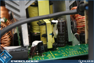

Buried beneath the heatsinks are the two main transformers inside the Silencer 910. The smaller of the two will more than likely be responsible for powering the 5VSB rail which is used primarily for USB devices and also for certain motherboard functions while the PC is in standby mode or indeed powered off. Whereas the larger of the two will have the sole responsibility of providing 12VDC which can then be stepped down via other DC-DC circuitry for poweing the +3.3v and +5v rails.

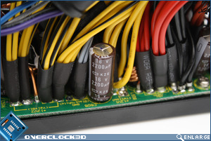

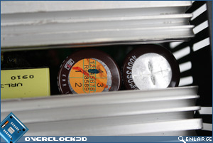

It looks like I caught quite a lucky break with ID’ing the primary capacitors as if it wasn’t for the markings just about visible on the folded part of the jacket, I’d probably be forced to get the soldering iron out. Japanese manufactured Nippon-Chemicon’s is the name of the game with specs of 400v / 330uF / 105°C. Similarly over on the secondary side more Nippon-Chemicon KZE’s can be spotted. This time with specs of 16v / 2200uF. All good so far.

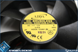

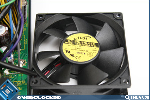

Lastly we come to the 80mm fan manufactured by ADDA. This is the same fan used inside both the PCP&C Silencer 750w Crossfire Edition and the Silencer S75EPS tested back in 2006. Some things never change eh? The spes of the fan can be seen below:
• Model: AD0812UB-A71GL
• Size (mm): 80x80x25
• Bearing: BALL
• Speed (RPM): 3900
• Airflow (CFM): 50.0
• Noise (dBA): 41.0
• Bearing: BALL
• Speed (RPM): 3900
• Noise (dBA): 41.0
