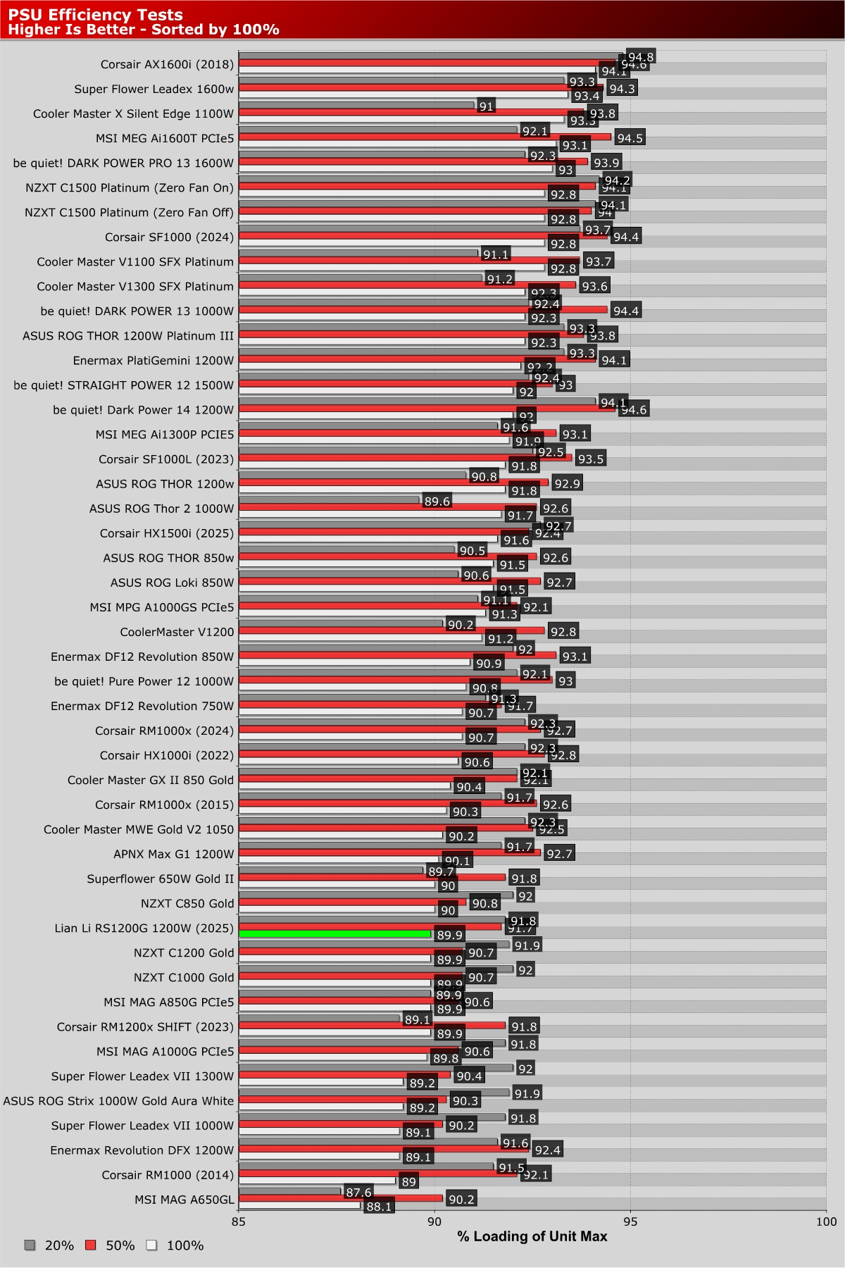

Power Efficiency
As an 80+/Cybenetics Gold-rated PSU, this unit delivers the efficiency results that we expect—around 90% efficiency at all times, with nearly 92% efficiency under lower loads.

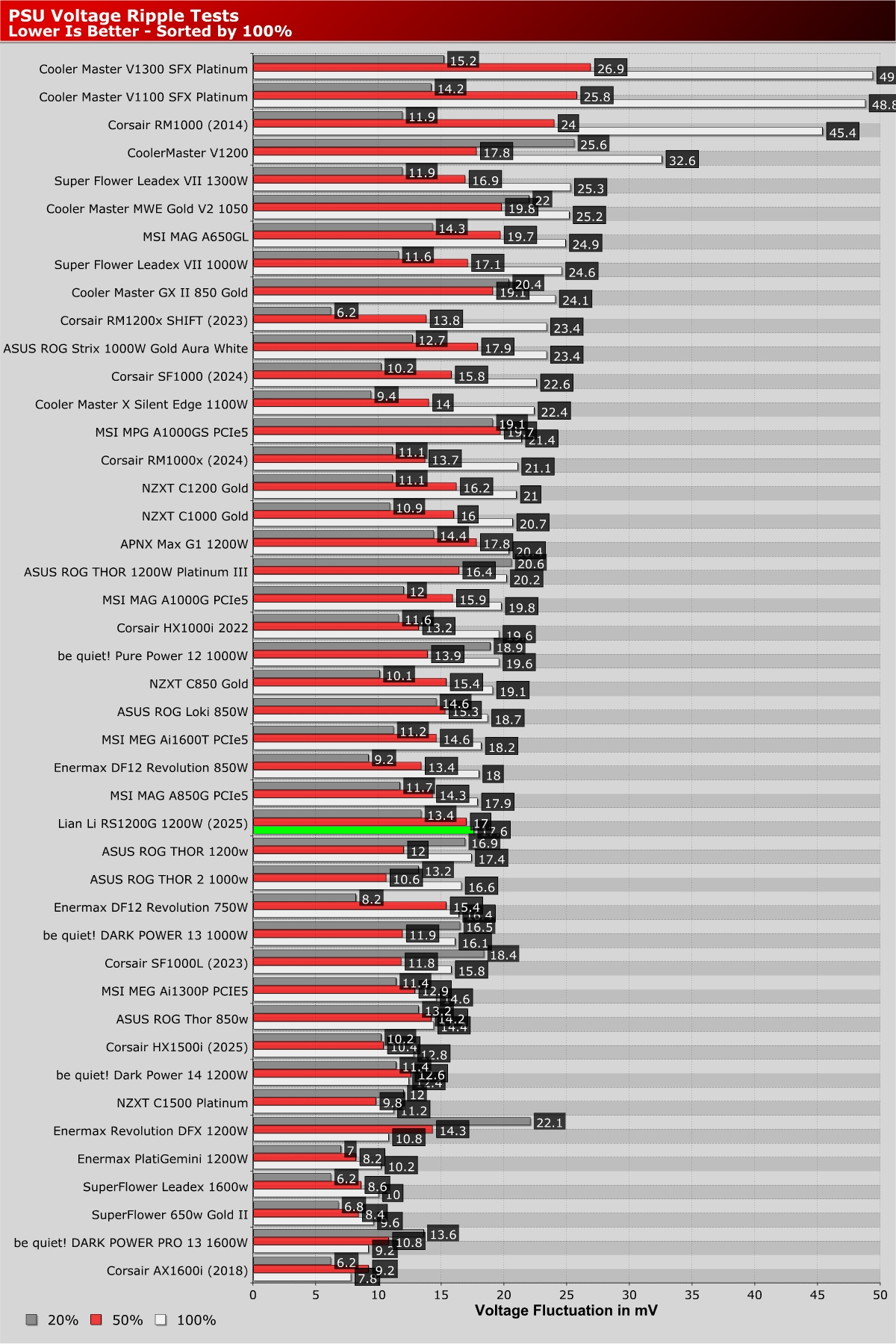

Voltage Ripple
Voltage ripple is often overlooked by consumers. It is best described as the stability of specific voltages that the PSU delivers. A PSU with bad ripple will see voltages vary a lot more. In extreme cases, this can damage components or shorten their lifespans. Voltage ripple stability is one of the many reasons you should buy a high-quality power supply. That means buying from a reputable brand and avoiding anything that isn’t 80+ certified.
An important thing to note here is that none of the PSUs in this graph are “bad.” Even units with the highest ripple in our charts, like the original Corsair RM1000 (from 2014), are usable within your system without any issues. We used this specific power supply within one of our main workstations for years and had no trouble with it. As we said before, only extreme levels of voltage ripple are dangerous. Regardless, we feel that these results are important, as we do not want to see PSU manufacturers moving backwards with this metric. We do not want to see the return of PSUs with high levels of voltage ripple.
Overall, the Lian Li RS1200G delivers solid ripple results. Ripple is always below 20mV, making it one of the better PSUs on our chart.
