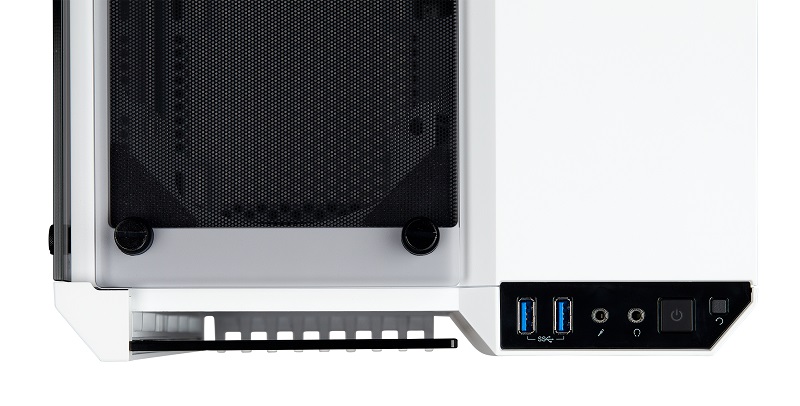

On the system’s front I/O, Corsair has included two USB 3.0 Type-A ports alongside audio in/out jacks and standard on/off and reset switches. In this image, we can also see how much space front-mounted fans have to breathe from the case’s front window.
