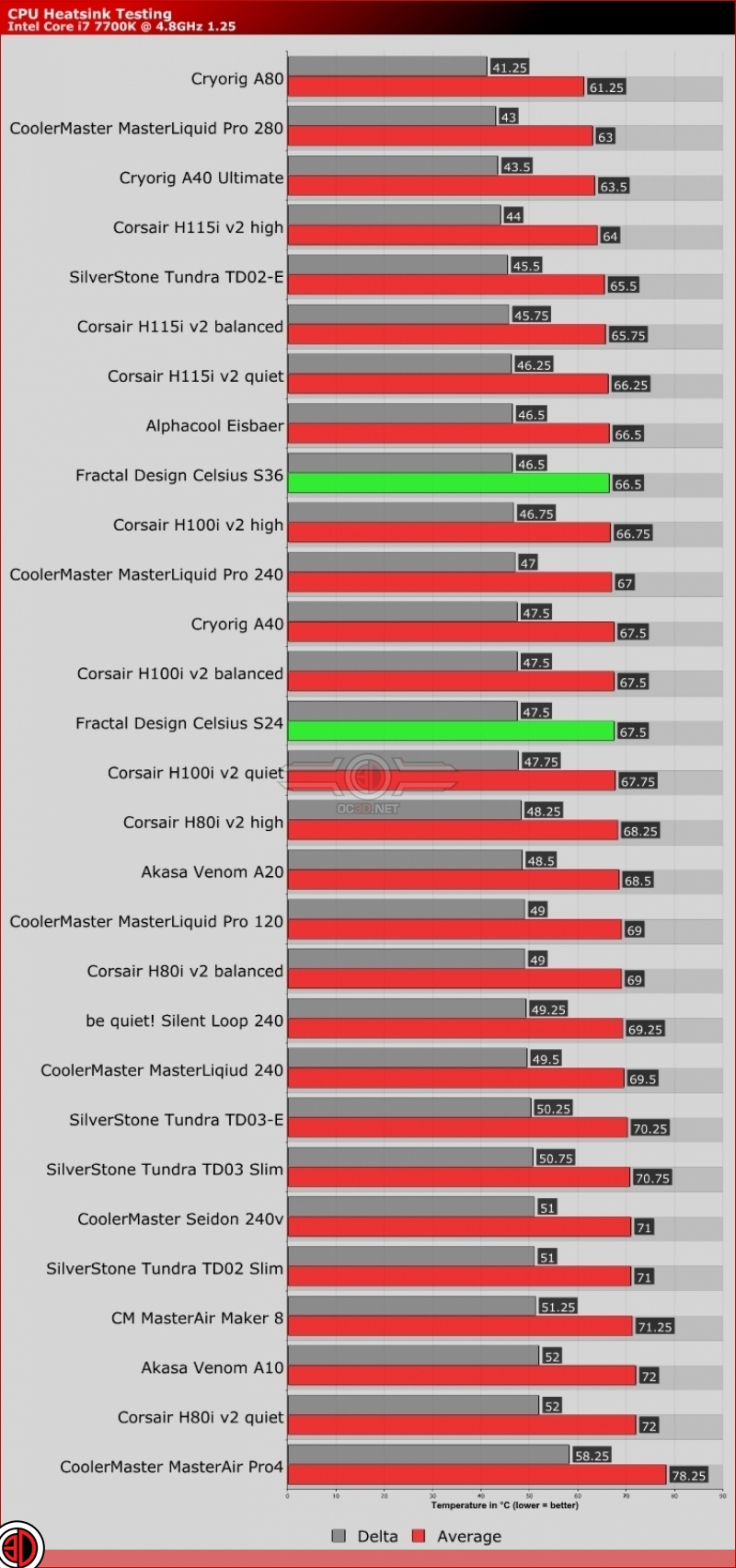

4.8GHz
Having had a fiddle with the volts we achieve a nice stable 4.8GHz overclock at 1.25 Volts (stock for most boards).  This level of overclock is going to give us a pretty good idea of how well coolers will perform when under a bit of stress.  We’d expect everything to make it through, however some may come close to the automatic 80 degree cut off wire.

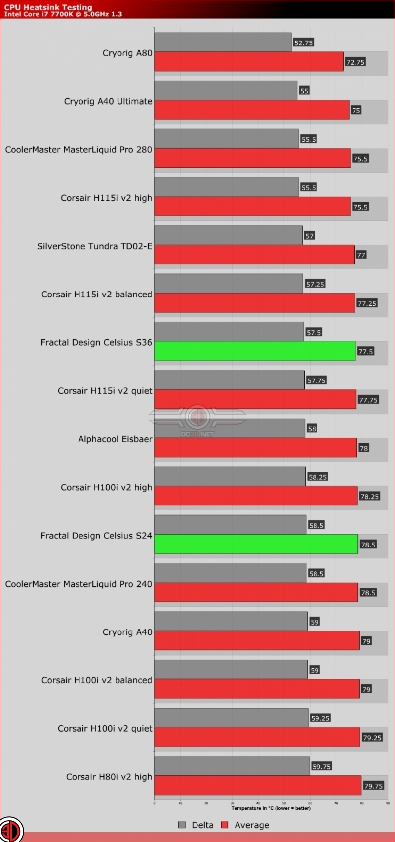

5.0GHz
A bump to 1.3v saw us acheive a solid 5.0GHz Overclock.  Only the very best coolers are going to perform well with this amount of heat being pumped into them, and even then, some of them will be close to the automatic cut off point.  5.0GHz might not seem like a huge increase on 4.8GHz, but the additional heat generated by that seemingly small bump in core voltage does seem to challenge the coolers that bit more, and so as before it’s here we start to separate the men from the boys, as lesser coolers may not able to disperse the increased heat effectively.  Only the cream of the crop will excel at this level,

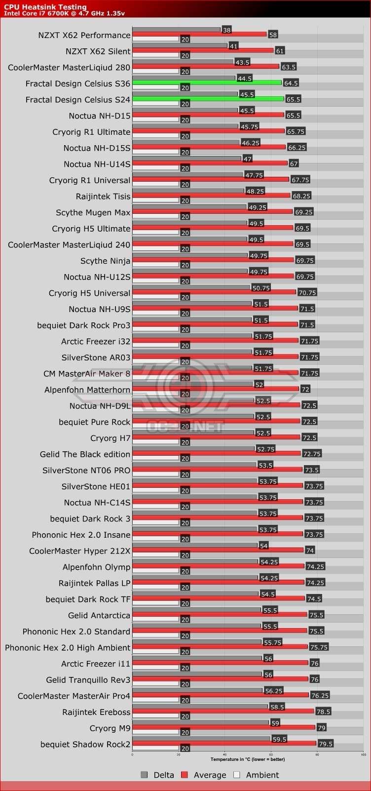

4.7GHz
Skylake if you remember didnt overclock as well as Kaby Lake and needed a fair few volts for what now seems like a ‘low’ 4.7GHz overclock. We only still run this because we can use the same test rig for it and it helps us still include a lot of results in the graph, if nothing else its great for cross referencing. To be very clear though only the cream of the crop will excel at this level.
