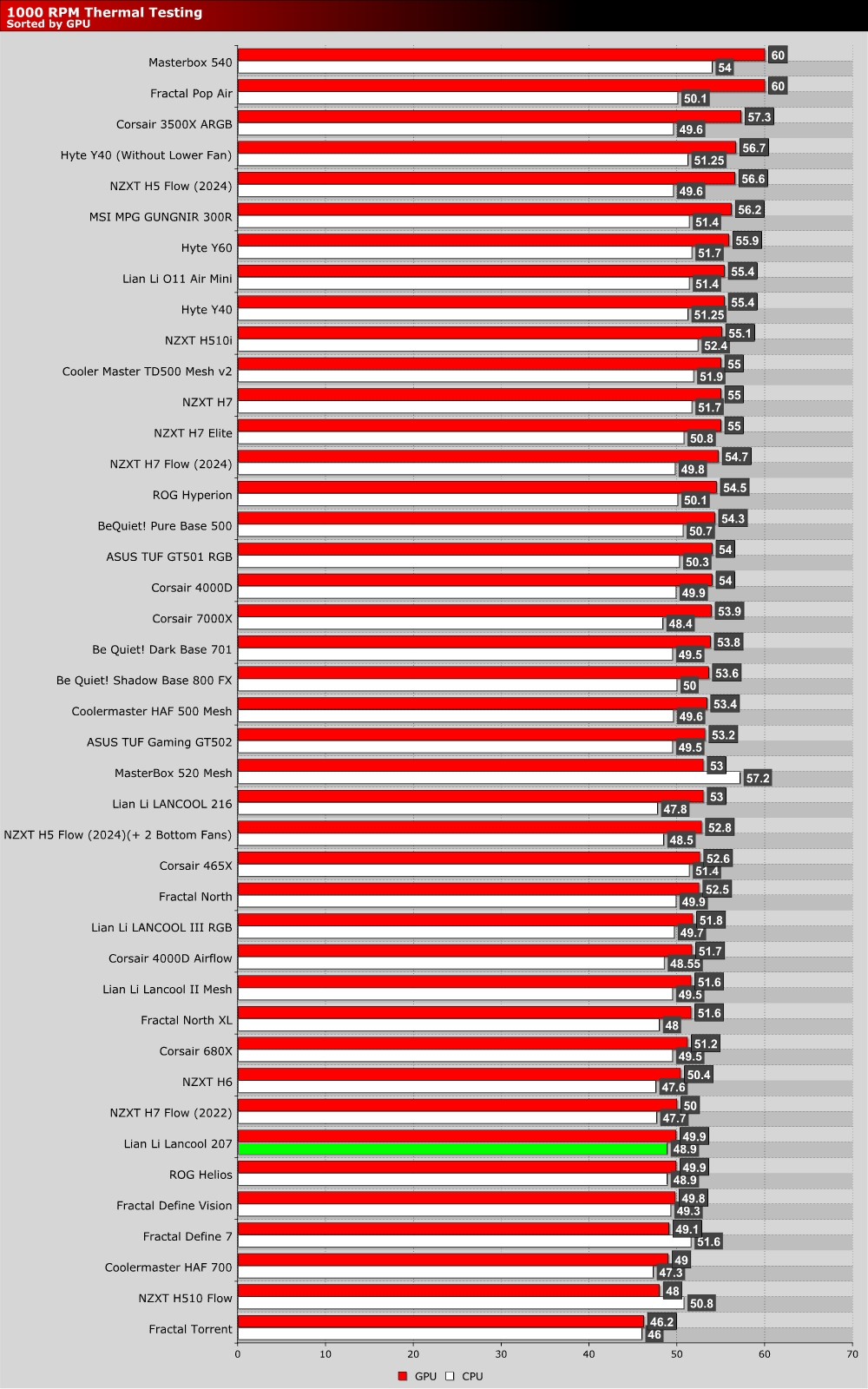

The graph below showcases Delta temperatures with a controlled ambient temperature of 20 degrees Celsius.
1000 RPM Fan Test
Lian Li’s LANCOOL 207 is one of the better-performing cases in our graphs, especially when it comes to GPU cooling. This makes a lot of sense, given this case’s fan layout. This case pushes a lot of airflow directly at your graphics card. This makes the LANCOOL 207 a great case for PC gamers, especially those who use higher-wattage GPU models.

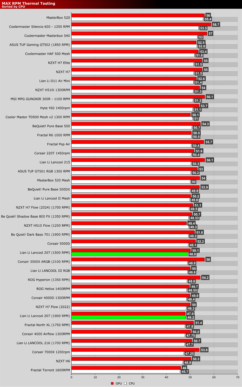

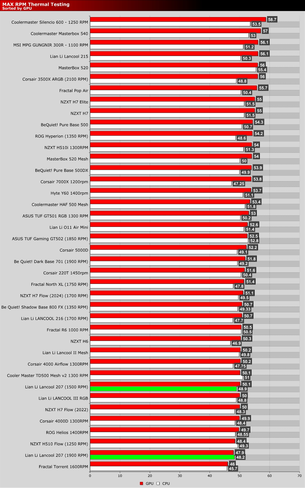

1500 RPM and Max RPM Fan Test
At higher fan speeds, we can see that the LANCOOL 207 continues to deliver strong cooling performance. Note that at 1900 RPM, this is the second-best case we have tested for GPU thermals. A strong result from Lian Li!
