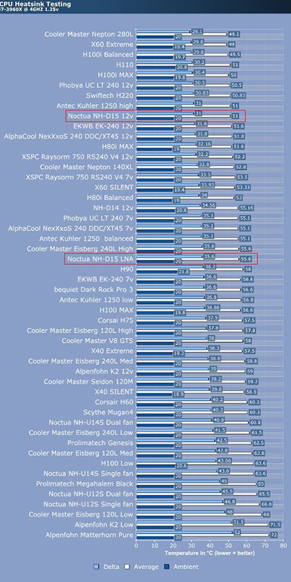

Turning now to the 4GHz test we up the voltage to 1.25 volts, this is what is deemed normally as stock volts. Something we are always harping on about on the forums is AUTO does not mean stock volts, and normally if you overclocking with “auto” volts the motherboard will be upping the volts much more than needed if you were to do it manually. By whichever means it happens, upping the volts (especially from our 1.1v undervolt) does have a big impact on temps, with an average increase of 10-15 degrees seen in the results.
At the higher levels of heat generated by the increase in voltage required for the 4.0GHz overclock, fan performance, although still a factor becomes less critical, replaced instead by a coolers ability to conduct the heat up the heat pipes and more crucially the total surface area of the fins enabling convection to the atmosphere. In the case of AIOs and water cooling the surface area of the radiator and the efficiency of the contact plate begin to play more of a factor.
We thought it might do well, but seriously we weren’t expecting it to beat three of the four custom 240mm rad loops in the charts. Even with the LNA fitted it still deports itself well, coming in only a degree or two behind the D14 at the full 12v.

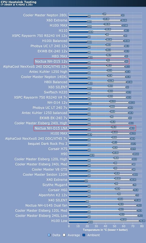

Upping the volts still further we achieve a stable 4.4GHz overclock at 1.35 Volts. It’s here we start to separate the wheat from the chaff, with lesser coolers not able to disperse the increased heat effectively. Again we see a jump of 10 degrees or so from the figures at 4GHz. Both the H100 and the well-respected D14 are creeping into the 70s here, indicating that only the cream of the crop will excel at this level.
This is what we’re really interested in isn’t it. The 4.4GHz test. It’s fair to say the Noctua NH-D15 is the new air cooling champion, bettering the D14 by 3 degrees. Not only that but it’s also beating a good few of the AIOs and the Alphacool 240mm Custom loop. With the LNA adapters fitted the D15 still romps home ahead of the bequiet Pro3 at it’s full 12v
