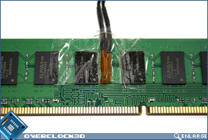

Measuring the temperature of the DIMMs is no easy feat. While some DDR3 modules do have an in-built digital temp diode, allowing the temperatures to be read from a software based monitoring program, the kit I have today does not so I will have to rely on a temperature probe which was affixed in the same place both with and without the coolers attached.

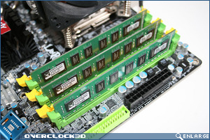

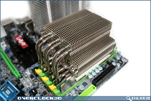

As you can see from the pictures below, the memory modules on their own (6GB pictured) look very basic. Add the Thermalright coolers and hey presto! A bog standard memory kit is transformed into a work of art. If bling is your think then you will certainly adore the Thermalright HR-07 memory coolers!

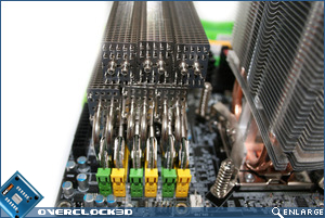

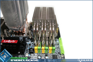

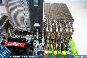

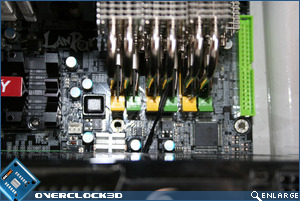

Fitting the modules to the motherboard was a tricky affair with a H-L-H-L-H-L configuration used. This allowed all six modules, three high and three low, to be fitted into the six DIMM slots. A small amount of wriggling the modules was needed to fit them all and they had to be fitted in a specific order to get them all to fit.

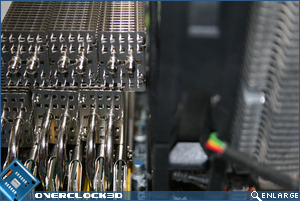

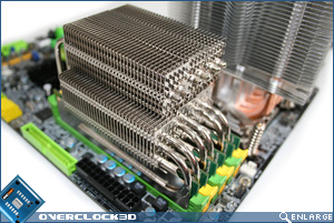

With the fan re-attached to our CPU cooler, space was very tight but all six modules were clear of fouling the fan. Larger CPU coolers (such as the TRUE will have to be orientated such that the width will have to be adjacent to the coolers rather than playing against them otherwise I cannot see how it will fit. Luckily for me I already had the CPU cooler fitted this way so not to intrude on the HR-07’s airspace. You can also see from the picture below that the coolers do not overhang the DIMM slot’s tabs nor interfere with the GPU spacing which is great news for those tight on space.
