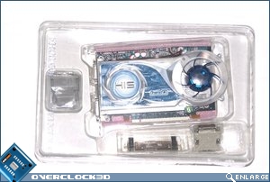

Once you have opened the initial packaging, you are presented with another box. This offers great protection to the card, ensuring it gets to you in pristine condition. Once you open the flap on the box, you can lift out the moulded plastic holding the card and accessories. Underneath the plastic is the driver CD and user manual.
HIS 4670 IceQ

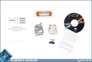

 There is a nice selection of accessories, although nothing out of the ordinary, such as the multi-function tool we saw with the 4850. Here you can see: User Manual, Crossfire bridge, D-Dub adapter, HDMI adapter, Warranty leaflet and driver CD.

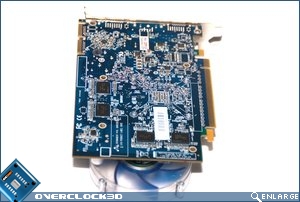

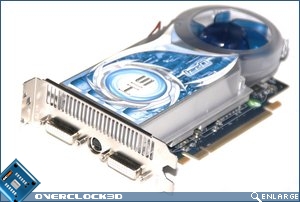

Once you have opened up the mould and taken the card out of its foam cushion, you can take a closer look at the card itself.
HIS 4670 IceQ HIS 4670 Up close
HIS 4670 IceQ HIS 4670 Rear view

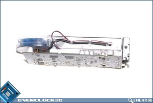

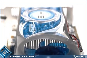

There was something that surprised us upon putting the card down – the cooler is longer than the card itself. Not only is it double the height of the stock cooler, but a good deal longer as well. The cooler is covered with an interesting graphic containing the HIS and IceQ logos. The fan is made out of transparent blue plastic; we were expecting it to contain an LED or two, but it seems HIS haven’t followed this trend.

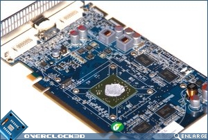

Something which we noticed on close examination was that the cooler did not seem to come into contact with the card’s memory modules.
HIS 4670 IceQ
Our suspicions seem to have been correct. As you can see, there is a fairly large amount of TIM on the core itself, yet the memory modules have none at all. The cooler doesn’t seem to have been designed to accommodate the memory – let’s hope this absence of cooling doesn’t effect stability in any way.
