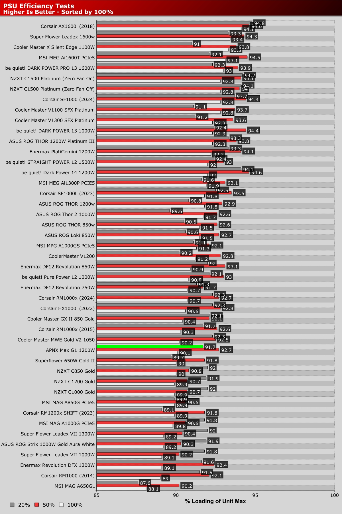

Power Efficiency
With power efficiency levels consistently above 90%, these are the performance levels that we would expect from an 80+ Gold-rated power supply. Today, you can get Platinum and Titanium-rated PSUs, which means that more efficient options are available. That said, this is a big step up from Bronze and Silver-rated PSUs. That efficiency means lower heat output and quieter operation under high loads. After all, less heat means that less cooling (lower fan speeds) are required.

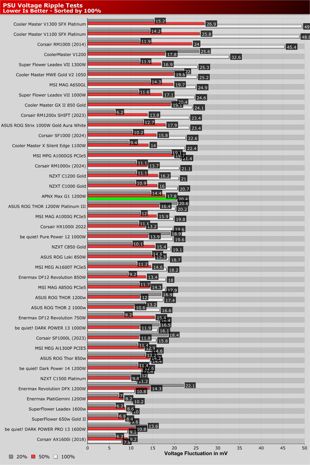

Voltage Ripple
Voltage ripple is often overlooked by consumers. It is best described as the stability of specific voltages that the PSU delivers. A PSU with bad ripple will see voltages vary a lot more. In extreme cases, this can damage components or shorten their lifespans. Voltage ripple stability is one of the many reasons you should buy a high-quality power supply. That means buying from a reputable brand and avoiding anything that isn’t 80+ certified.
An important thing to note here is that none of the PSUs in this graph are “bad.” Even units with the highest ripple in our charts, like the original Corsair RM1000 (from 2014), are usable within your system without any issues. We used this specific power supply within one of our main workstations for years and had no trouble with it. As we said before, only extreme levels of voltage ripple are dangerous. Regardless, we feel that these results are important, as we do not want to see PSU manufacturers moving backwards with this metric. We do not want to see the return of PSUs with high levels of voltage ripple.
APNX’s new Max G1 1200W power supply sits comfortably in the middle of our charts. Under most circumstances, voltage ripple is below 20 mV. That’s a solid result. It’s far from the best we have tested, but it is a solid result nonetheless.
