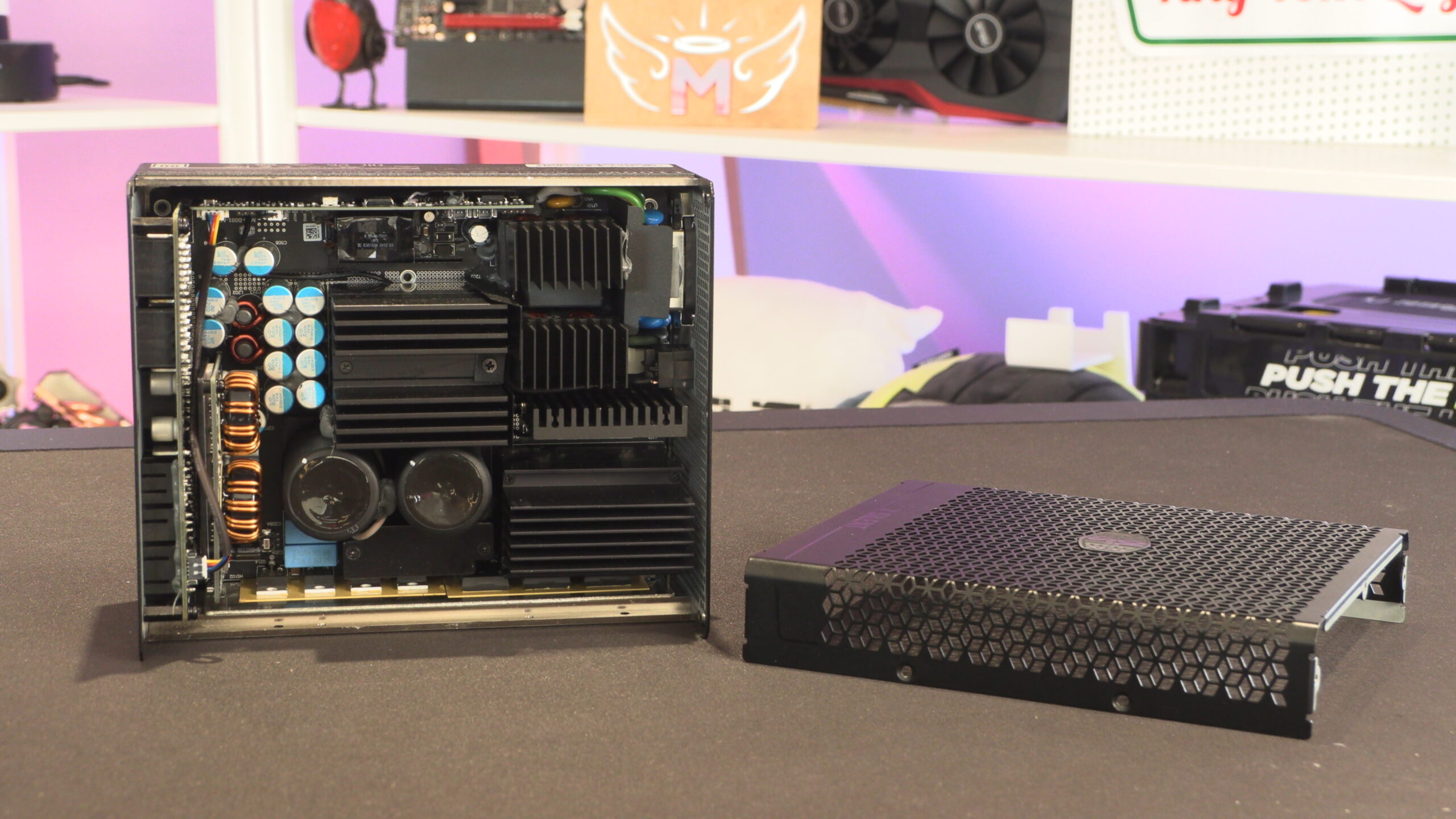

The Cooler Master X Silent Edge series is the result of technological innovations from Infineon. Cooler Master’s partnership with Infineon has allowed them to deliver their latest cutting-edge power supplies. The new semiconductors from Infineon and the cooling prowess of Cooler Master have come together in the X Silent Series to deliver fanless PSU cooling to eliminate noise issues and dust buildup.
Under this PSU’s top plate, we can see a series of large heatsinks, though there is more to this PSU design than large internal heatsinks. This PSU’s housing is made of aluminium and is filled with heatpipes. This makes this PSU’s coverings a large heatsink, allowing it to dissipate heat.

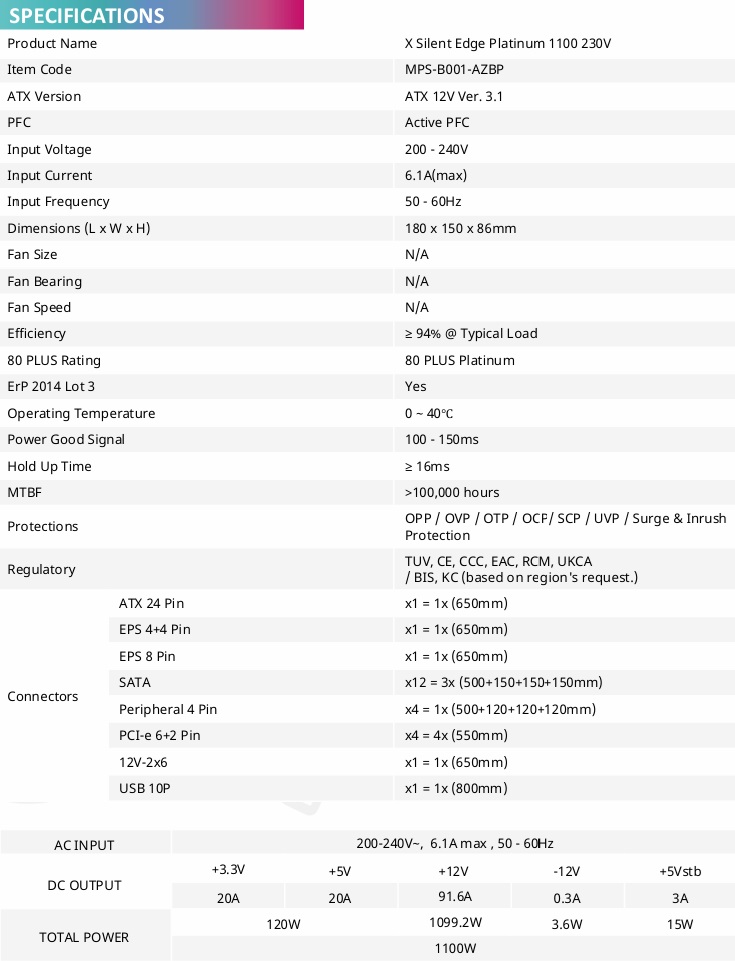

Cooler Master’s X Silent Edge 1100 is an ATX 3.1 and PCIe 5.1 certified power supply. This unit features Cooler Master’s custom 12V-2×6 power connector, which is designed to run cooler than standard 12V-2×6 connectors. Additionally, it features a 90-degree bend to minimise cable wear and eliminate the need for tight bending.
This PSU is an 80+ Platinum-rated power supply designed to run in environments between 0 and 40 degrees Celsius.
Cable-wise, this fully modular PSU features the following cable options. It was one ATX 24-pin cable, one EPS 4+4 cable, one EPS 8-pin cable, 12 SATA connections (across three cables), 4 Molex connections (on 1 cable), four PCIe 6+2-pin cables, one 12V-2×6 cable, and one USB cable (for Cooler Master MasterCTRL PSU monitoring).
