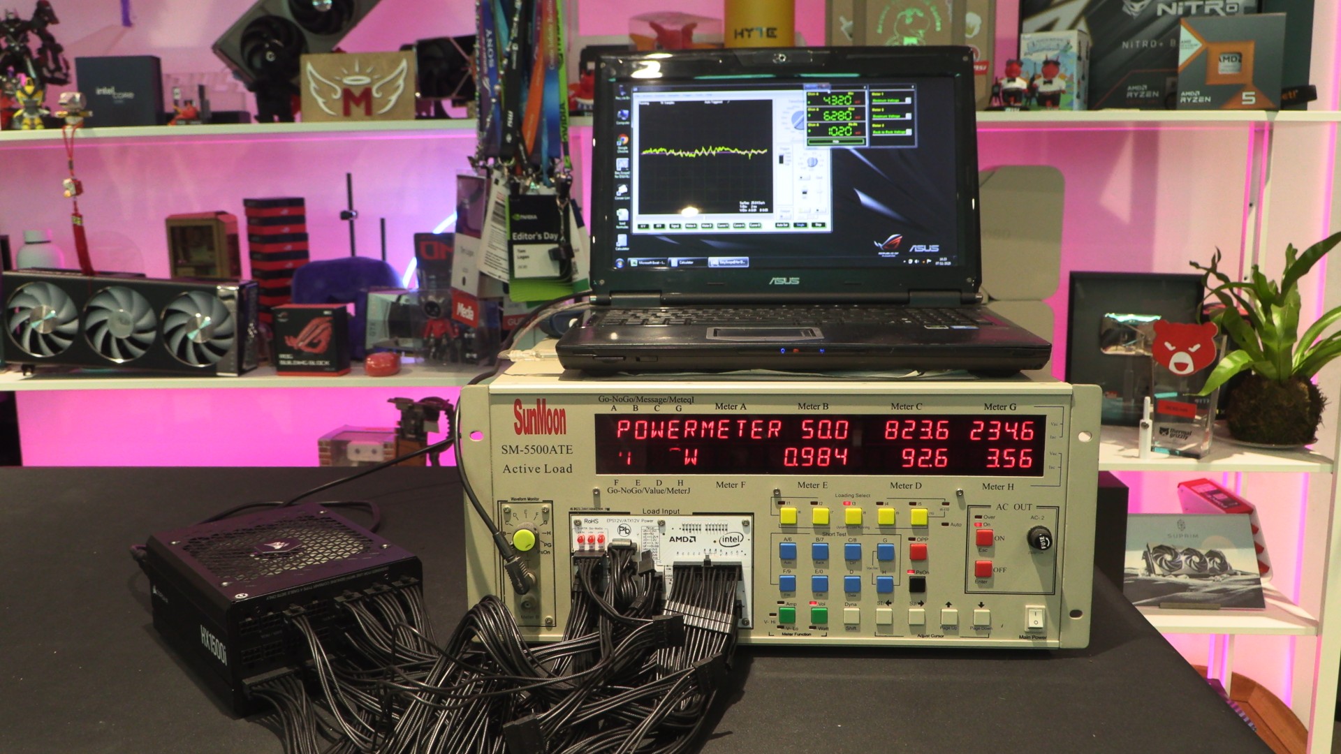

When reviewing new power supplies at OC3D, we use our dedicated SunMoon PSU Tester, one of the most expensive (if not the most expensive) tools in the company’s arsenal. Here, we can see exactly how well a unit functions. We look at both a PSU’s efficiency and power stability. To do this, we utilise bespoke PSU testing equipment to give us an in-depth look at each power supply’s performance. This kind of data collection is impossible when using a PSU with standard PC components.
Testing Limitations
Our power supply tester has its limits, and we dare not push this machine beyond them. The maximum power draw that we can safely test with this unit is 1200 watts. Unfortunately, for higher-wattage power supply units, we must limit our testing to 1200W. As such, your “100%” results display data with a 1200W power load, not the maximum load of 1500W that this PSU supports. Lower wattage power tests will be conducted as normal.

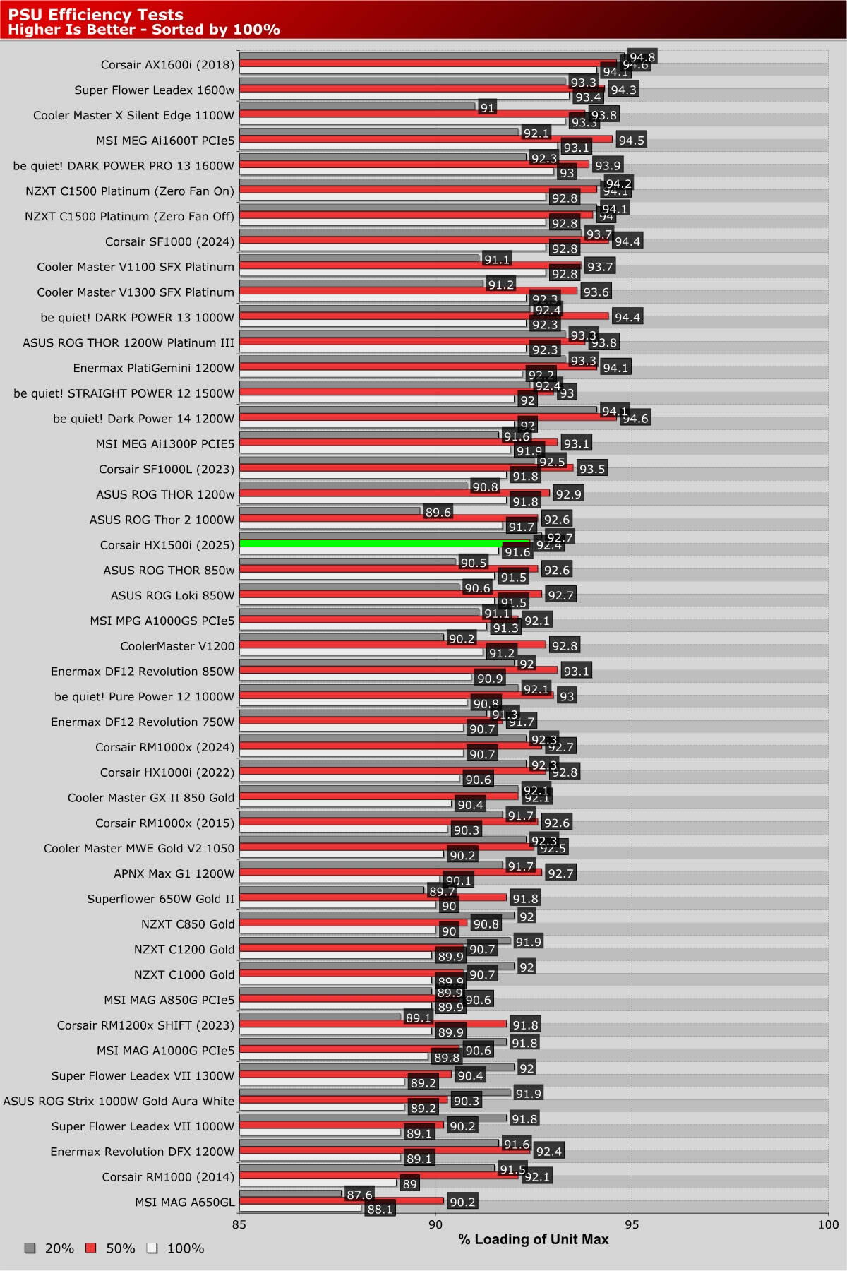

Power Efficiency
Corsair’s HX1500i performs as expected for a Platinum-rated power supply. The PSU consistently delivers power efficiency levels of over 91%.

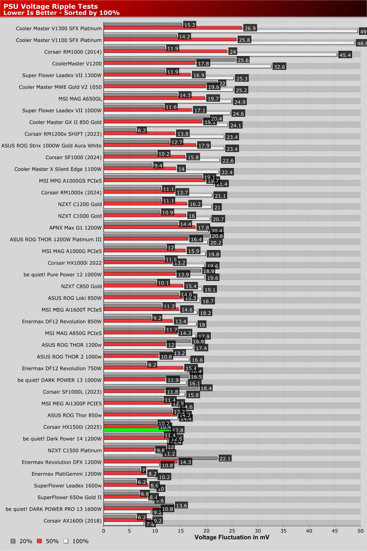

Voltage Ripple
Voltage ripple is often overlooked by consumers. It is best described as the stability of specific voltages that the PSU delivers. A PSU with bad ripple will see voltages vary a lot more. In extreme cases, this can damage components or shorten their lifespans. Voltage ripple stability is one of the many reasons you should buy a high-quality power supply. That means buying from a reputable brand and avoiding anything that isn’t 80+ certified.
An important thing to note here is that none of the PSUs in this graph are “bad.” Even units with the highest ripple in our charts, like the original Corsair RM1000 (from 2014), are usable within your system without any issues. We used this specific power supply within one of our main workstations for years and had no trouble with it. As we said before, only extreme levels of voltage ripple are dangerous. Regardless, we feel that these results are important, as we do not want to see PSU manufacturers moving backwards with this metric. We do not want to see the return of PSUs with high levels of voltage ripple.
Voltage stability is an area where the new HX1500i excels. It stands as one of our top ten results, with ripple levels that are consistently below 15 mV. This makes the HX1500i a great PSU for overclockers who demand strong performance in this area.
