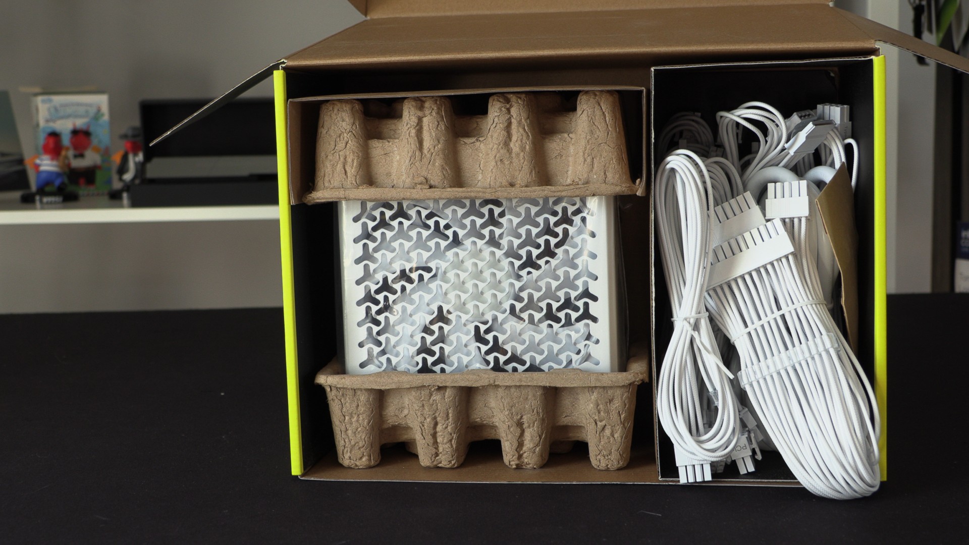

When it comes to packaging, the Corsair RM1200e’s is simple and effective. I doubt any careless courier could damage this PSU in transit. There’s plenty of cardboard between this PSU and the outside of its packaging. You’d need to be trying if you wanted to damage this PSU while it is inside its box.

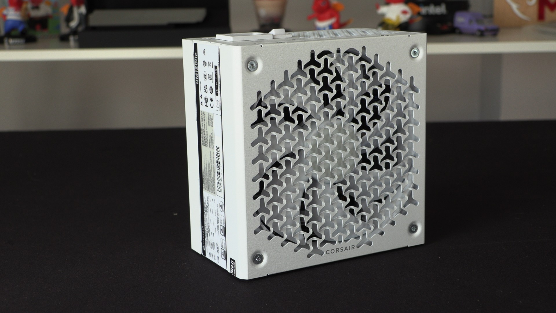

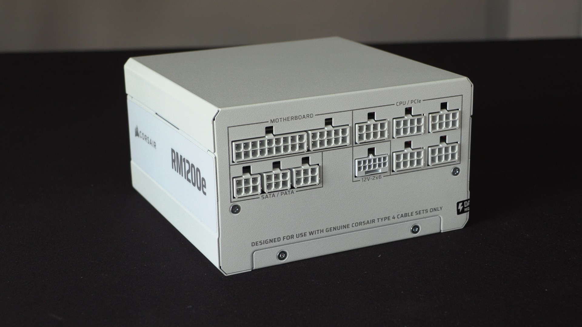

The new Corsair RM1200e is 150mm long, so it fits in any ATX PC case with plenty of room for cable management. The PSU features a 140mm fan and fully modular cables. This means that users only need to install the cables they need, simplifying cable management.

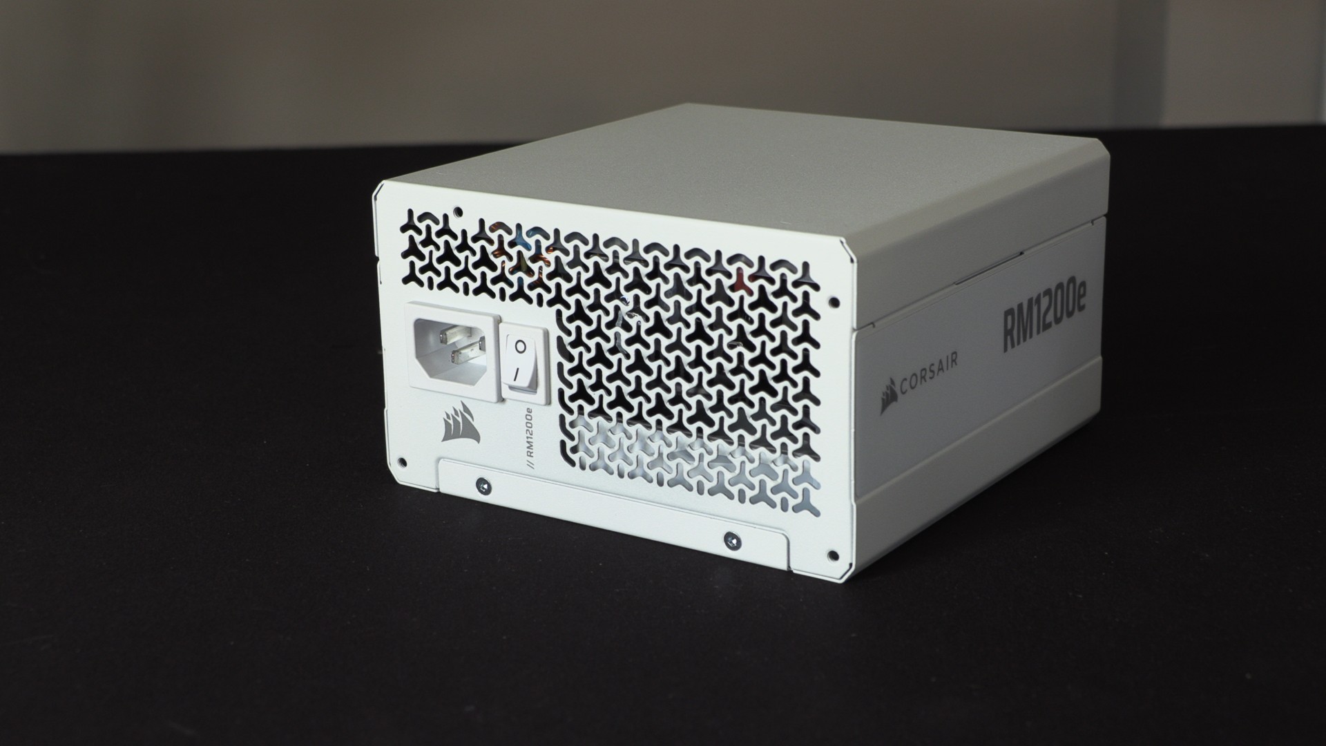

On the rear of the PSU, we have a simple power rocker switch and a power input. That’s as simple as a PSU gets. There is no optional 0 dB fan mode; it’s simply enabled by default. This PSU’s 140mm fan automatically switches on at 40% load (480W or higher). That said, poor PSU ventilation or ambient temperatures above 25 degrees Celsius can make this fan turn on early.
Under low load conditions, this PSU is silent.
Type 4 Corsair Cables
Corsair notes on its PSUs that they support Corsair Type 4 cable sets. Corsair sells aftermarket PSU cable sets in various colours, allowing enthusiasts to customise their systems while still using official Corsair parts. Note that Corsair mentions “genuine Corsair” cable sets on its PSUs. Yes, 3rd parties produce Corsair Type 4-compatible PSU cables. That said, only Corsair’s official cables are officially supported.

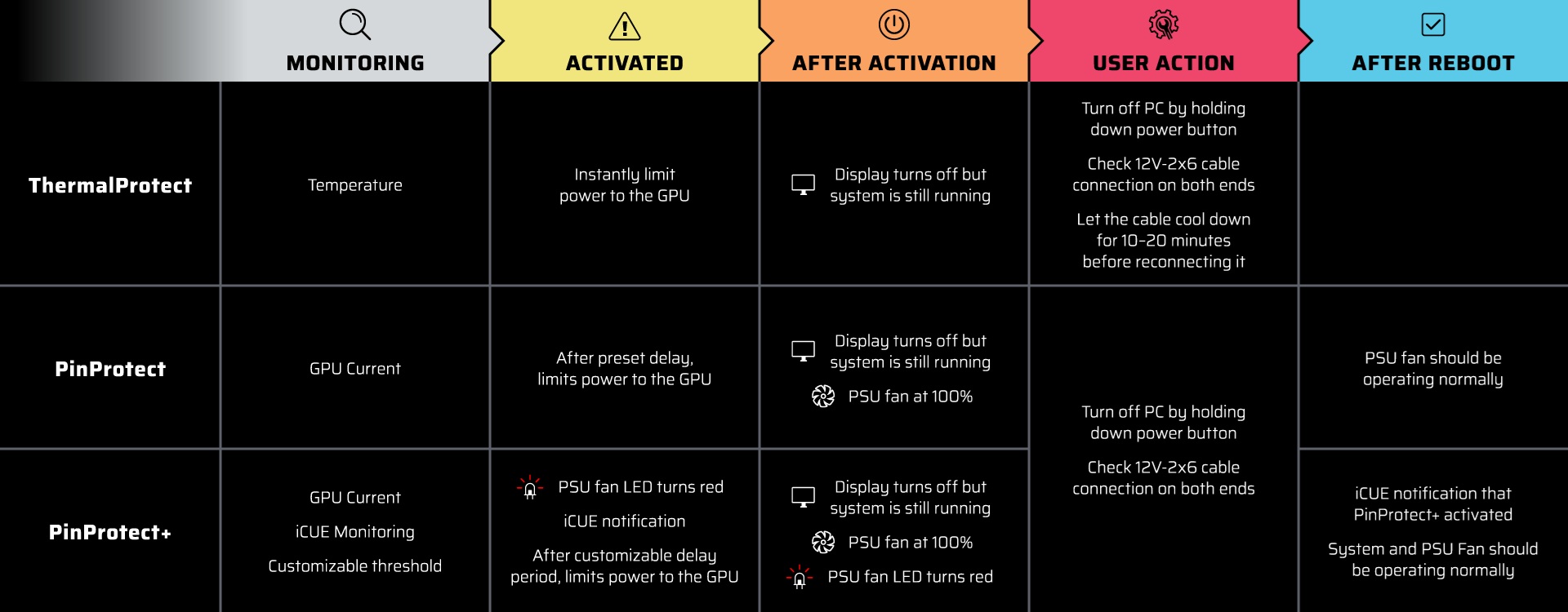

Corsair PinProtect – 12V-2×6 Protection
The RM1200e is the first Corsair power supply to feature “PinProtect” technology, a per-pin overcurrent protection mechanism. This tech helps to prevent modern GPUs from being damaged by excessive heat buildup or current when using a 12V-2×6 power connector. If current stays out of spec too long, the power supply reduces output across the 12V-2×6 connector, shutting down your graphics card.
This tech is built into the RM1200e and requires no software or configuration to utilise. This feature runs continuously to protect your graphics card. This tech will be coming to more Corsair PSUs in the future. The RM1200e is simply the first PSU to utilise this feature.

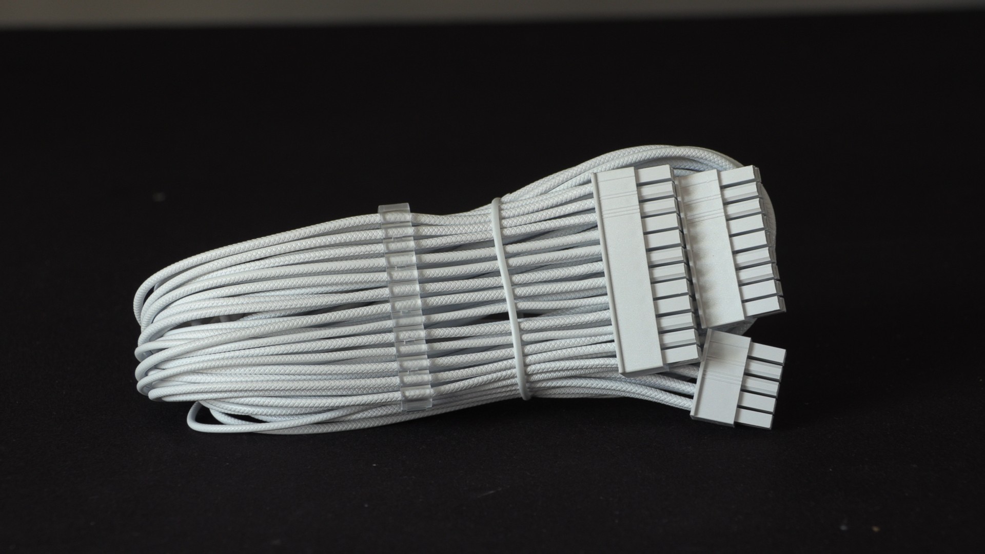

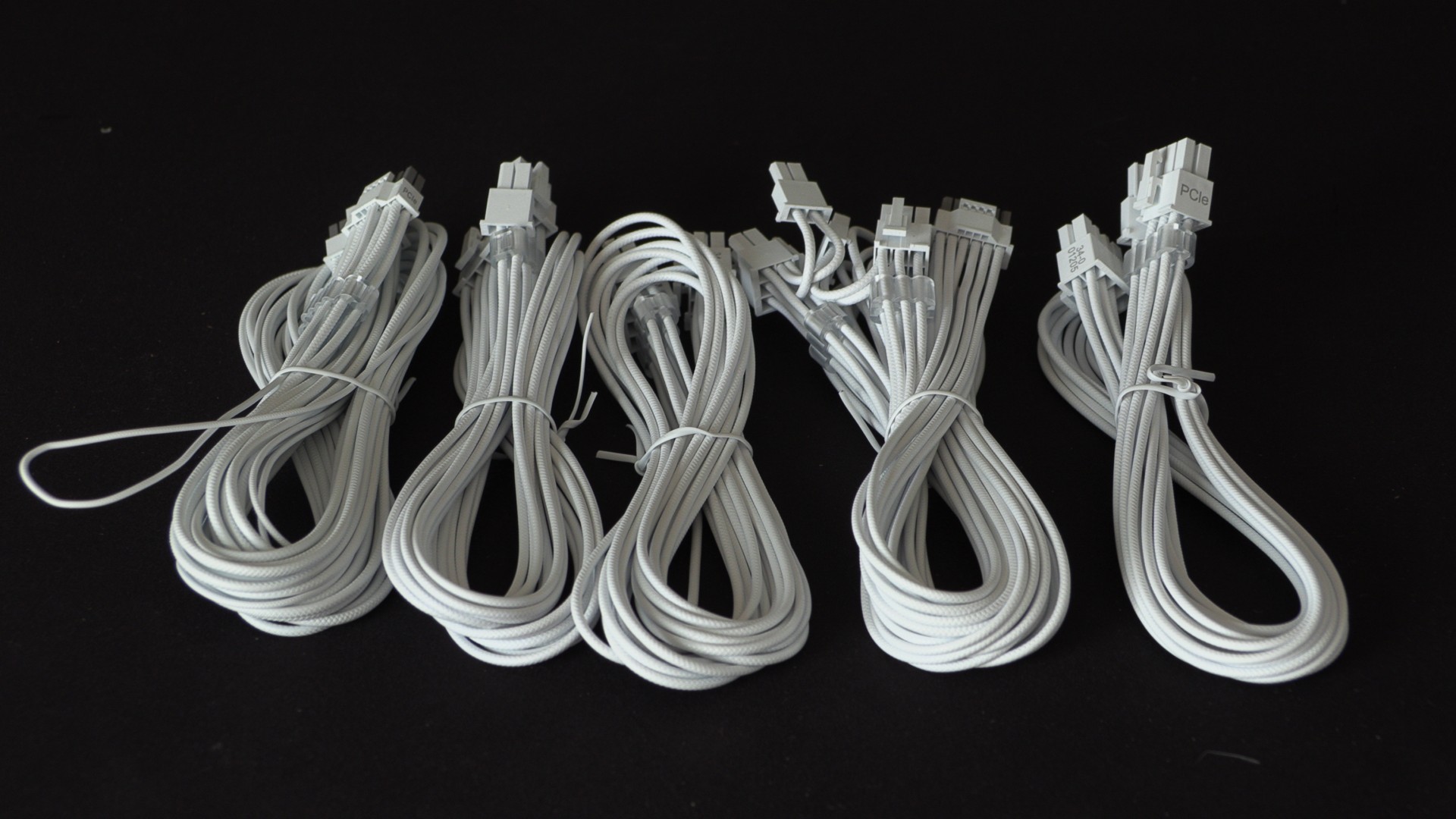

Corsair’s RM1200e PSU ships with debossed cables with integrated low-profile cable combs. These cables look braided, but without the associated concerns. Unlike braided cables, these cables won’t fray over time and can be easily cleaned when needed. On the white model, the cables are all white. Even the power connectors themselves are white, which is rather rare. Overall, these are some neat-looking PSU cables.
These cables are all Type-4 Corsair PSU cables. Note that the 12V-2×6 cable is a native 12V-2×6 cable and that it has grey power pins, which should help users see if the cable is fully seated or not.
