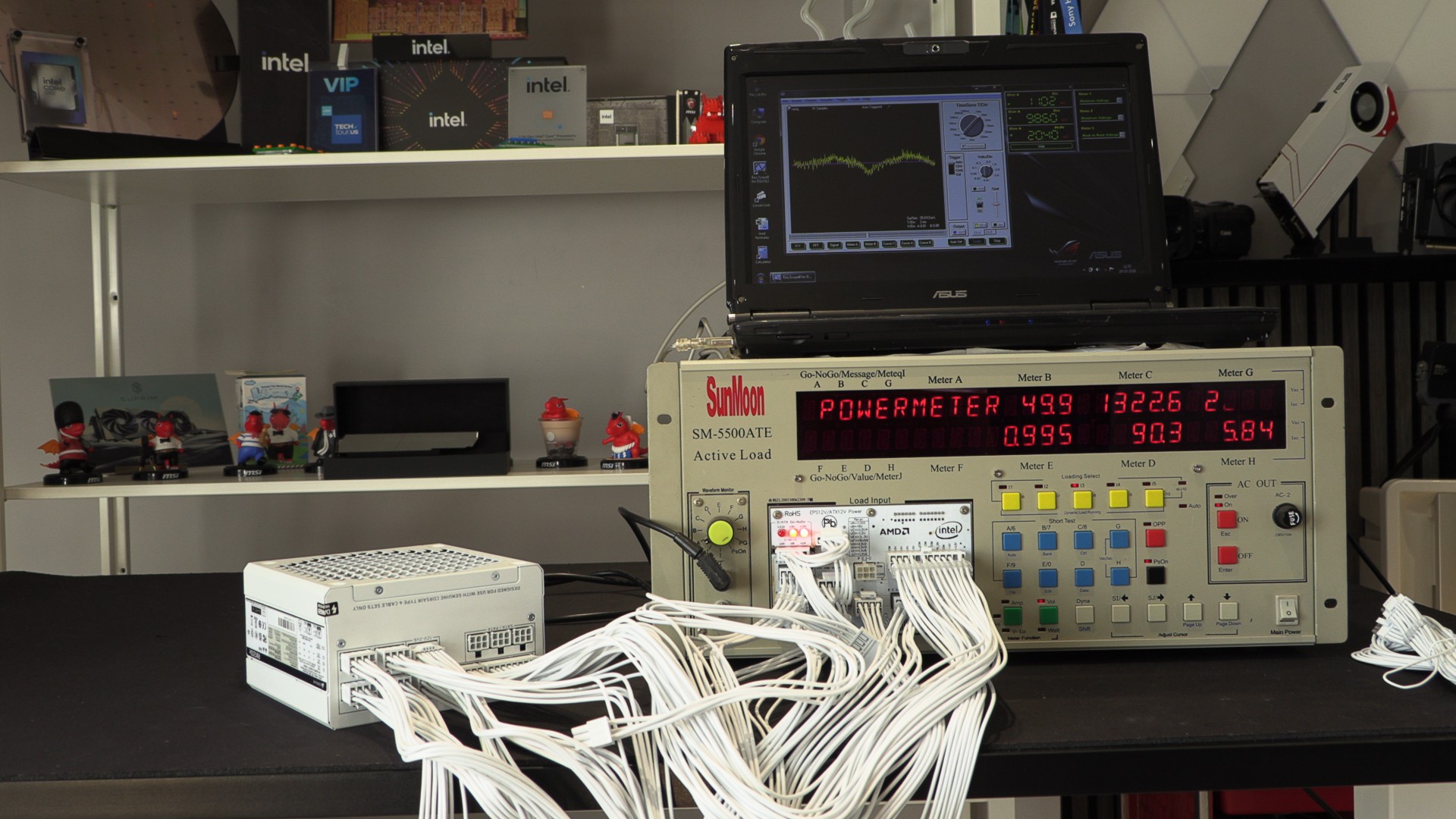

Voltage Ripple and Efficiency Testing
When reviewing new power supplies at OC3D, we use our dedicated SunMoon PSU Tester, one of the most expensive (if not the most expensive) tools in the company’s arsenal. Here, we can see exactly how well a unit functions. We look at both a PSU’s efficiency and power stability. To do this, we utilise bespoke PSU testing equipment to give us an in-depth look at each power supply’s performance. This kind of data collection is impossible when using a PSU with standard PC components.
For this PSU, it is worth noting that the maximum sustained load we can safely test is 1200 watts. As such, for 100% loads on this PSU, we will test 1200W, the maximum load our testing unit can handle. For 1200W and lower PSUs, we will test their maximum rated capacity.

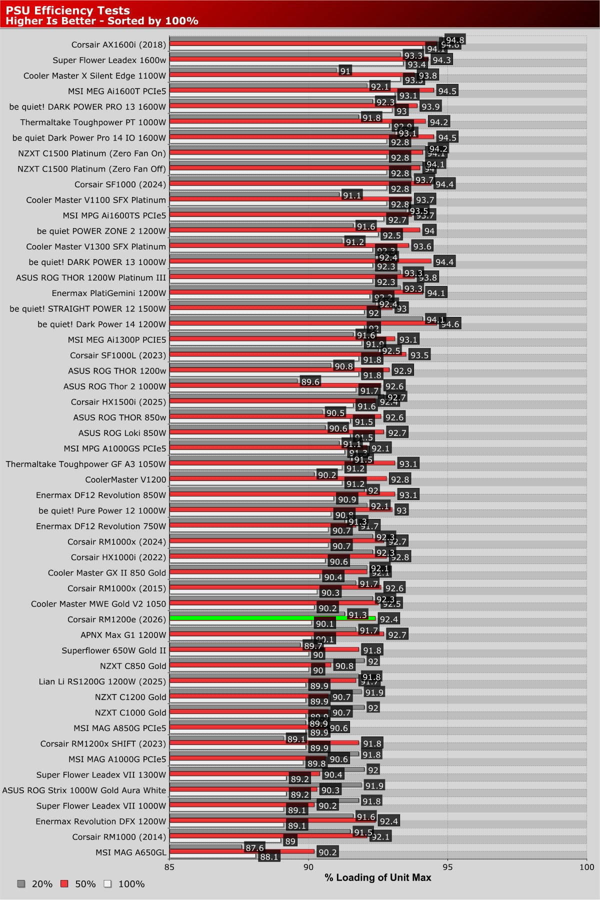

Power Efficiency
Across our testing, the Corsair RM1200e delivers efficiency levels between 90.1% and 92.4%, a solid result for a modern PSU. Yes, it’s on the lower end of our charts, but it’s worth noting that we rarely test a PSU that isn’t rated 80 PLUS Gold or higher.
If you value low PC noise levels and want a lower power bill, a high-efficiency PSU is worth investing in. Higher efficiency means less power is wasted, and less wasted power means lower heat output. That directly influences cooling performance and PSU noise levels. After all, efficient PSUs don’t need beefy cooling solutions and fast/noisy fans.

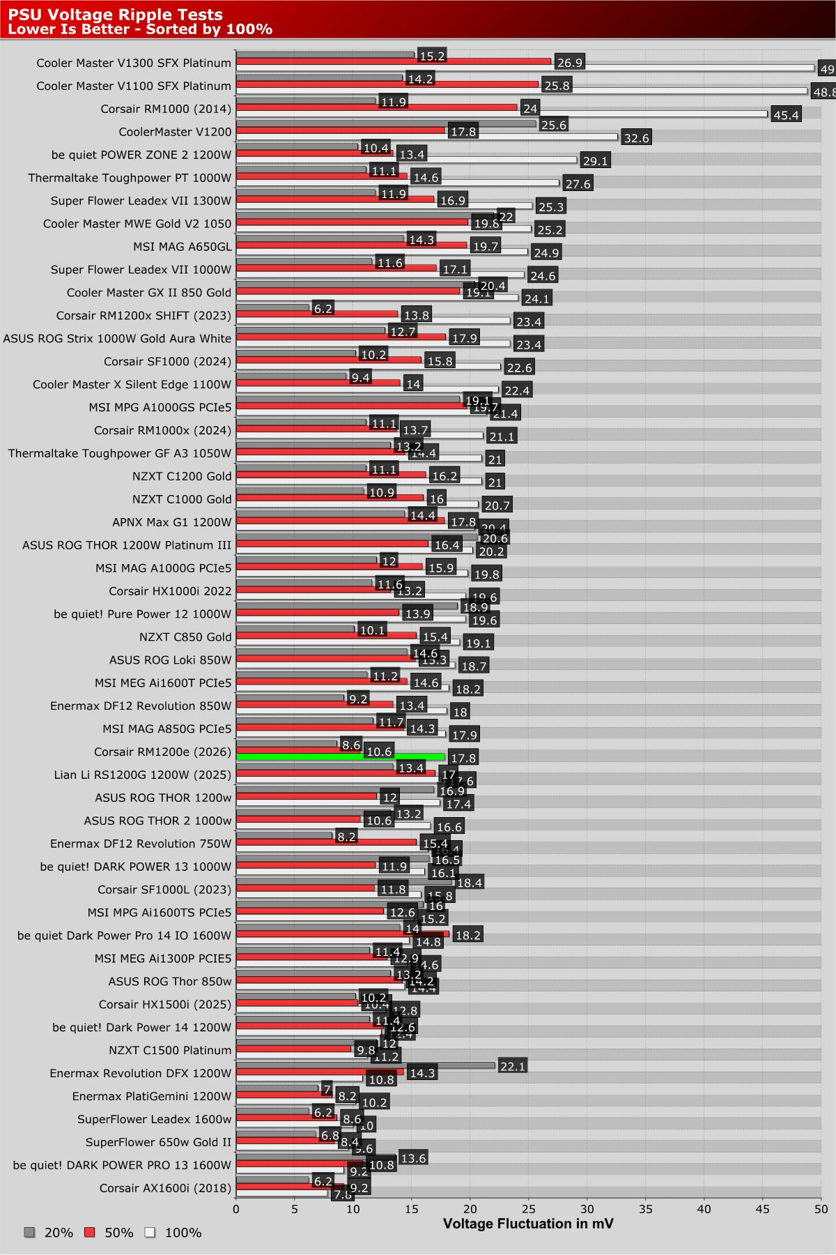

Voltage Ripple
Consumers often overlook voltage ripple. It is best described as the stability of specific voltages that the PSU delivers. A PSU with high ripple will see voltages vary much more. In extreme cases, this can damage components or shorten their lifespans. Voltage ripple stability is one of the many reasons to choose a high-quality power supply. That means buying from a reputable brand and avoiding anything that isn’t 80+ certified.
An important thing to note here is that none of the PSUs in this graph is going to kill your PC. Even units with the highest ripple in our charts, like the original Corsair RM1000 (from 2014), are usable. We used this power supply in one of our main workstations for years without any trouble. As we said before, only extreme levels of voltage ripple are dangerous. Regardless, we feel these results matter, as we don’t want to see PSU manufacturers moving backwards on this metric. We do not want to see the return of PSUs with high levels of voltage ripple. It’s easy to build a “gold-rated” PSU today, but it’s hard to build one with excellent ripple performance.
The ATX standard calls for less than 120 mV of voltage ripple on its 12V rail. Since the ATX standard is ancient by today’s standards, and modern PCs can consume much more power, we believe that lower ripple levels are a must. Feeding your PC a stable voltage means all your components won’t have to work as hard to stabilise their power. That results in greater component longevity and better voltage control when overclocking.
Corsair RM1200e Ripple performance
Corsair’s RM1200e achieves voltage ripple levels between 8mV and 18mV during our testing. In our view, voltage ripple below 30 mV is good, below 20 mV is great, and below 15 mV is phenomenal. With this in mind, the Corsair RM1200e is a great PSU.
