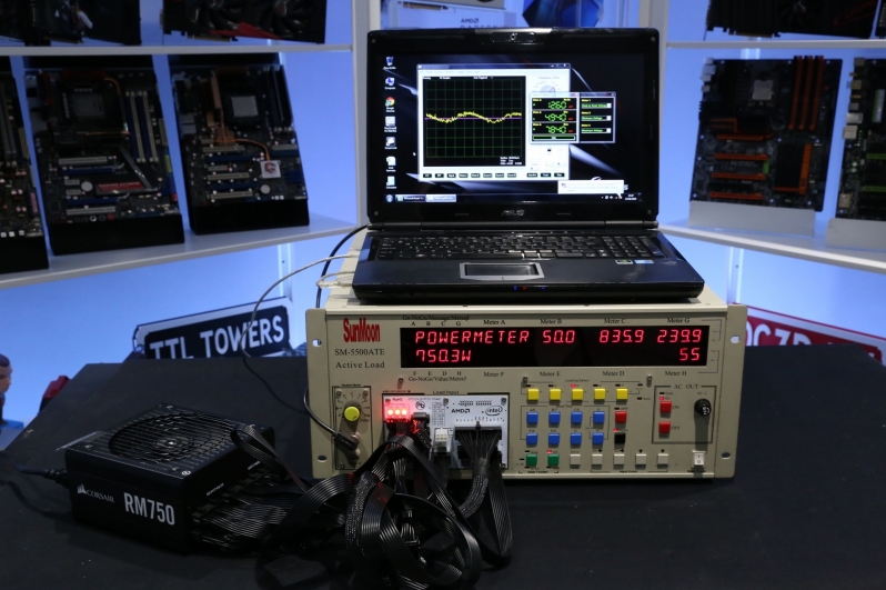

Voltage Ripple and Efficiency Testing
When reviewing new power supplies at OC3D, we use our dedicated SunMoon PSU Tester, one of the most expensive (if not the most expensive) tools in the company’s arsenal. Here we can see exactly how well a unit can function, looking at its efficiency and power stability, giving us a more in-depth look at the performance of power supply than is possible when using it with standard PC components.
In our video review (next page), Tom will show you this unit in operation, with Corsair’s RM750 hitting its peak wattage output of 750W, showcasing the unit’s efficiency as we tested it at 20%, 50% and 100% loads.
