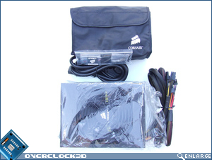

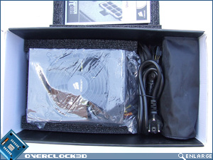

Corsair HX 1000W Box Open Corsair HX 1000W Contents
The HX1000 comes in a rather long double walled cardboard box that actually got us quite worried as to just how long the PSU would be once we’d unpackaged it. Thankfully on opening the box our fears were alleviated by a large quantity of Styrofoam padding along with a collection of cables and accessories neatly tucked at the end of the box.

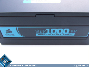

Corsair HX 1000W Bottom Corsair HX 1000W Top
Corsair HX 1000W Back Corsair HX 1000W Side

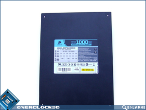

Out of the PSU’s we’ve covered so far in this review, the HX1000w is definitely the most professional looking of the bunch.  With a matt black, slightly coarse powdercoated finish along with blue specification stickers, there’s something about the HX1000W that makes it stand out for wanting to do exactly the opposite.

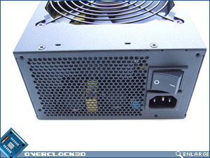

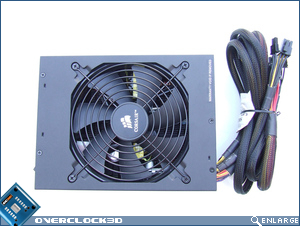

Corsair have made full use of all available space and have opted for a 135mm fan. As with all PSU’s of this design, the air is drawn up from inside the PC case, pushed over the heatsinks inside the PSU and allowed to exit out the back of the unit via a meshed grill.
Also worthy of a mention is the absolutely huge power switch used on the unit. While most manufacturers’ tend to skimp and save, using rocker switches that look like they were stolen from a school electronics project. The switch used on the HX1000 looks more than capable of dealing with the extremely high current that this unit will be pulling from the wall socket under heavy load.

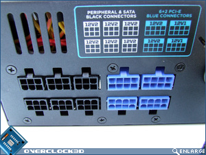

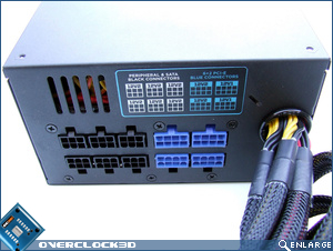

Corsair HX 1000W Front Corsair HX 1000W Modular Plugs

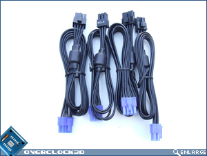

Corsair have kept the modular connector system extremely simple: PCI-E cables go in the blue sockets, everything else goes in the black ones. In addition, a small sticker detailing which of the two +12v rails each of the sockets is connected to internally; makes the decision of where to insert the modular plugs even easier.
Corsair HX 1000W Cables Corsair HX 1000W PCI-E
Corsair HX 1000W Wires Corsair HX 1000W ATX

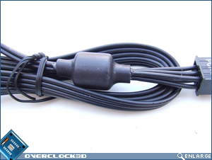

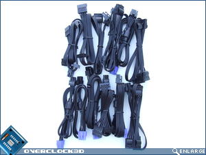

The collection of modular cables is plentiful, and certainly far more than you could plug into the unit all at the same time. However, what really sets the HX1000’s cables apart from those used on the rest of the modular units in this review is the total lack of sleeving.
Rather than opting for the cumbersome and often untidy look of fabric mesh finished off with heatshrink and cable ties, Corsair have decided to use black wires arranged in a ribbon cable style. This not only makes routing of the cables around the inside of the PC much easier, but also looks extremely cool.

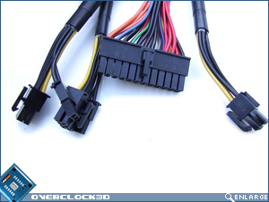

Unfortunately the ATX, P4-12v and EPS12v cables hard wired into the unit don’t follow the clean look of the modular cables and are sleeved in much the same way as the rest of the units on review. We can only assume that this is because the sleeveless modular cables are something that are added by Corsair after the unit has left the CWT factory.

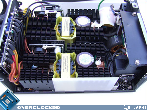

Corsair HX 1000W Inside Corsair HX 1000W Dual Caps + Transformers
Corsair HX 1000W Modular Corsair HX 1000W Power Filter

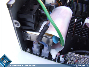

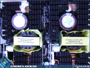

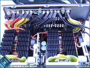

Looking inside the HX1000, the layout of the internal components is so distinctive that it is instantly recognisable as coming from the same OEM that Thermaltake also use for their 1.5kw Toughpower series. However, if we compare the Toughpower unit side-by-side with the HX1000 it is clear to see that Corsair have not only upgraded the capacitors, but also changed over the transformers, upgraded the cooling and made several slight alterations to the layout as well.
What makes the unit so unique is that it is essentially two 500w PSU’s placed side-by-side. This means that each of the two  +12v rails in the unit is powered by a totally independent circuit, offering unmatched stability. Not only this, but Corsair have also assigned one of the circuits to power the +5v rail, and another to power the +3.3v rail, once again offering much greater stability than any single circuit power supply could provide.
