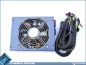

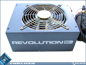

Measuring in at 190mm in length the Revolution is significantly shorter than it’s 220mm elder brother, making the unit much more suitable for the ‘standard’ sized PC case. Most of this space saving is undoubtedly down to the removal of the 80mm fan at the rear of the PSU which is no longer required due to the increased efficiency and lower heat output of the components.

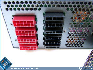

In much the same style as the Be-Quiet unit seen over on page #2, the modular connector system of the Revolution uses both PCI-E style connectors as well as a flat 5-Pin style connector. Previous experience has told us that both of these systems work well, providing extremely robust connections than don’t work their way loose or cause arcing due to ill-fitting plugs.

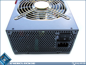

At the back of the unit you’ll find the usual honeycomb grill along with the mains lead socket, a beefy power switch and a status LED. At this point it is also worth mentioning that Enermax have gotten rid of the annoying buzzer that was present on the early versions of their Galaxy and Infinity series. Having owned both of these units, the lack of ‘beeping’ when switching the unit on/off is a welcome ommision.

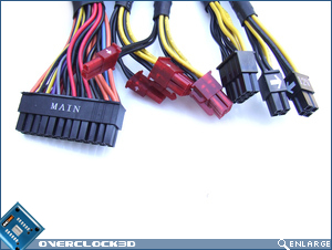

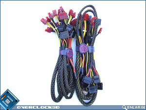

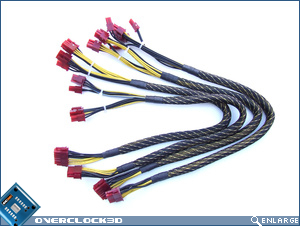

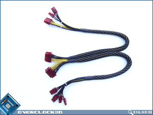

While we need to remember that the we’re not looking at the retail version of the Revolution, the two large bundles of cables sent to us with the unit certainly look promising for those of us who have problems getting the PSU leads to reach certain parts of their full-tower cases. Furthermore, the unit is most definitely well suited to multi-GPU setups with a total of eight PCI-E connectors being provided via four modular cables.
Of course no Enermax unit would be complete without its trademark gold and black sleeved cables, and as we can see from above, the Revolution certainly doesn’t disappoint. Unfortunately in some places where there are too many cables coming out of a single socket, Enermax have had to start the sleeving up to 10cm down the cable making things look a little untidy – but this is only a minor gripe.

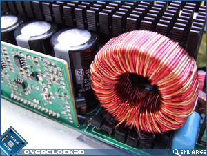

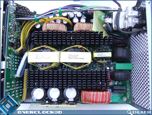

Lifting the hood on the Revolution reveals a very tidy internal layout with minimal cable clutter and plenty of room for air to flow over and around the internals. This is surprising considering the Revolution actually has the largest number of primary components out of any of the units we’ve tested in this roundup.

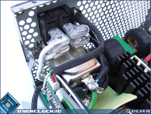

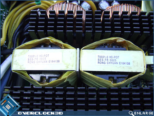

Two beefy transformers located in the middle of the unit provide the power for the six +12v rails with a smaller transformer located just to their right dealing with all other rails such as +3.3v and +5v. Smoothing out the power are three medium sized capacitors rated at 400v / 220uF along with an AC filter fitted to the mains socket for filtering out voltage spikes and line noise.
