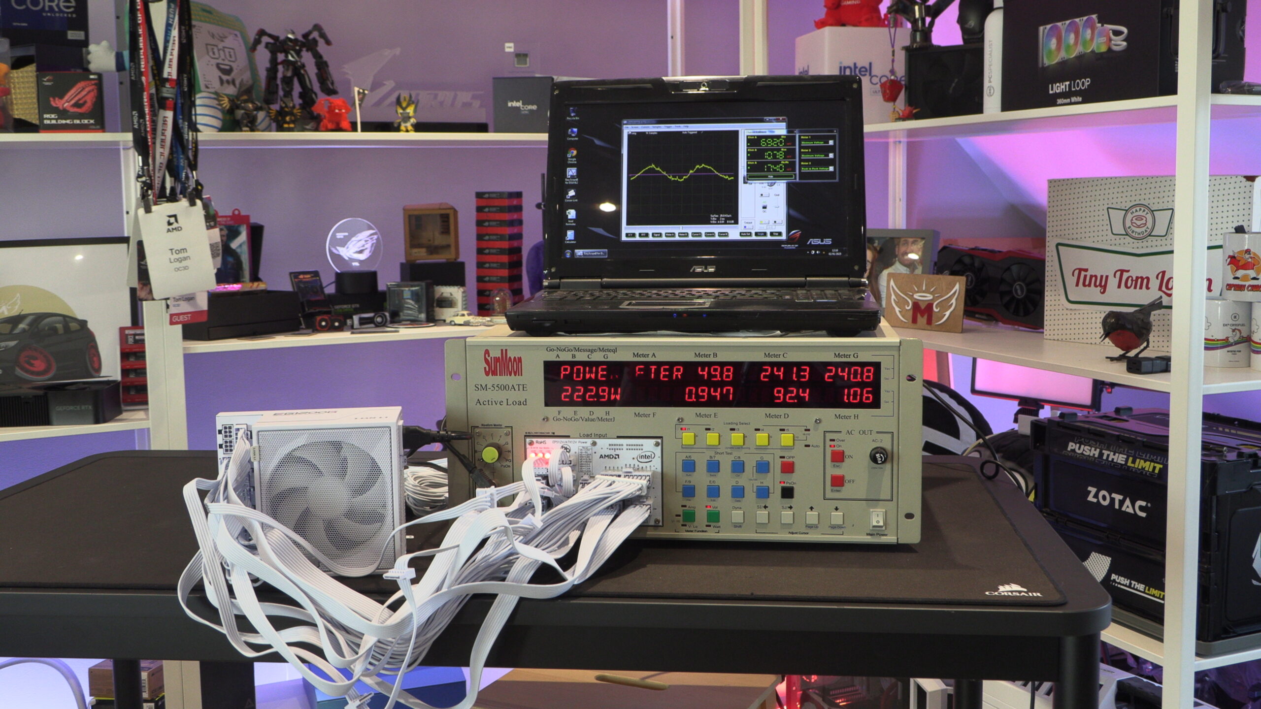

When reviewing new power supplies at OC3D, we use our dedicated SunMoon PSU Tester, one of the most expensive (if not the most expensive) tools in the company’s arsenal. Here, we can see exactly how well a unit functions. We look at both a PSU’s efficiency and power stability. To do this, we utilise bespoke PSU testing equipment to give us an in-depth look at each power supply’s performance. This kind of data collection is impossible when using a PSU with standard PC components.

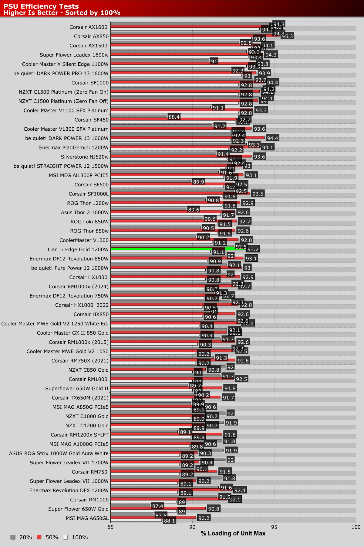

Power Efficiency
The Edge Gold 1200W delivers efficiency levels that are higher than what we expect from a gold-rated PSU. In fact, it beats many 80+ Platinum-rated PSUs on our charts (like the Corsair HX1000i). This PSU punches above its weight class when it comes to power efficiency, which is a great thing for buyers.

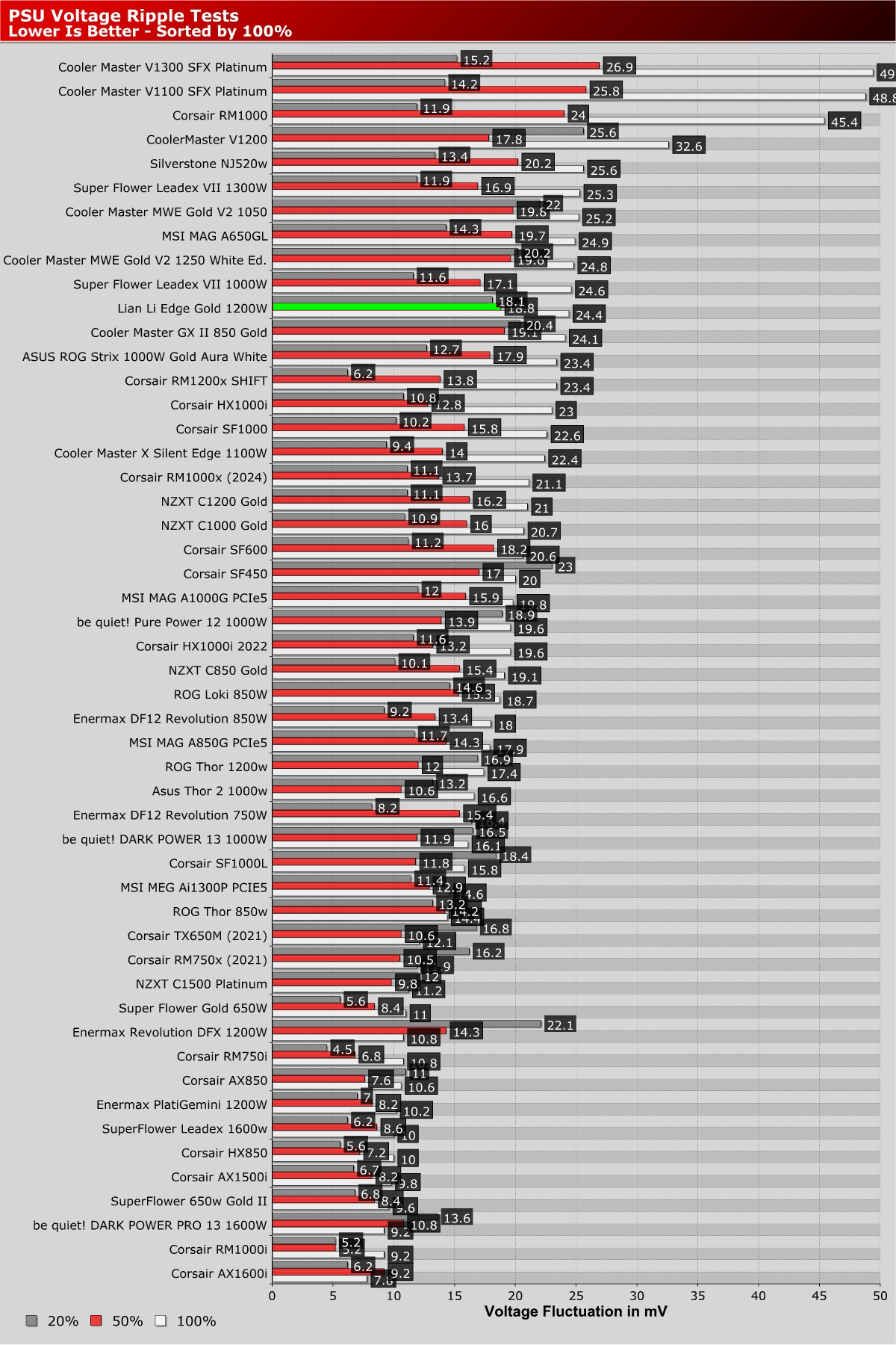

Voltage ripple is often overlooked by consumers. It is best described as the stability of specific voltages that the PSU delivers. A PSU with bad ripple will see voltages vary a lot more. In extreme cases, this can damage components or shorten their lifespans. Voltage ripple stability is one of the many reasons you should buy a high-quality power supply. That means buying from a reputable brand and avoiding anything that isn’t 80+ certified.
An important thing to note here is that none of the PSUs in this graph are “bad.” Even units with the highest ripple in our charts, like the original Corsair RM1000 (from 2014), are usable within your system without any issues. We used this specific power supply within one of our main workstations for years and had no trouble with it. As we said before, only extreme levels of voltage ripple are dangerous.
While the voltage ripple on the Lian Li Edge Gold 1200W isn’t the worst we have seen, it is far from the best. We would like to see higher levels of voltage stability from a modern high-end power supply. Regardless, this PSU is more than good enough for any gaming PC or workstation.
