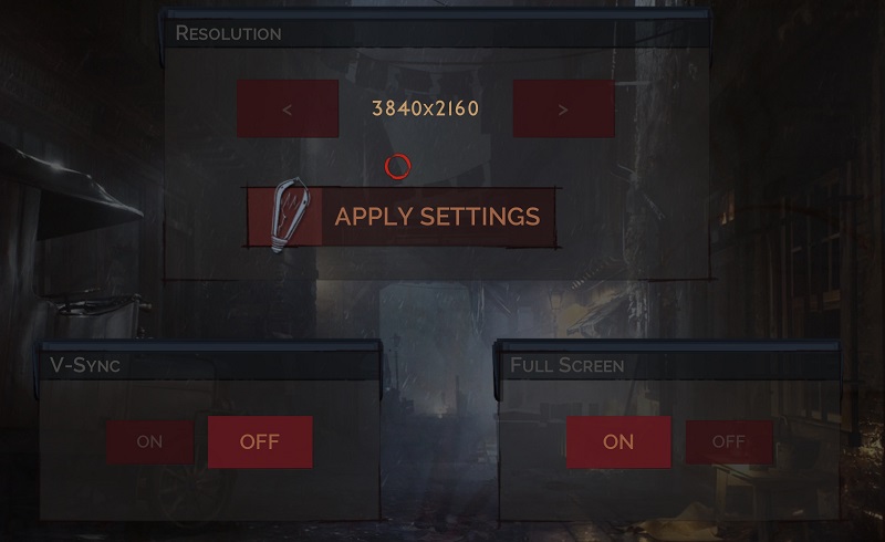

To start off, we can confirm that Vampyr has a locked framerate on PC, with the game providing a strange framerate cap of 62FPS on our initial test system, preventing us from achieving higher framerates. We have found a way to eliminate this cap (details below), though we will have to report back in our full report whether or not the change has and adverse effects on the game’s stability. So far, things seem to run normally at higher framerates.

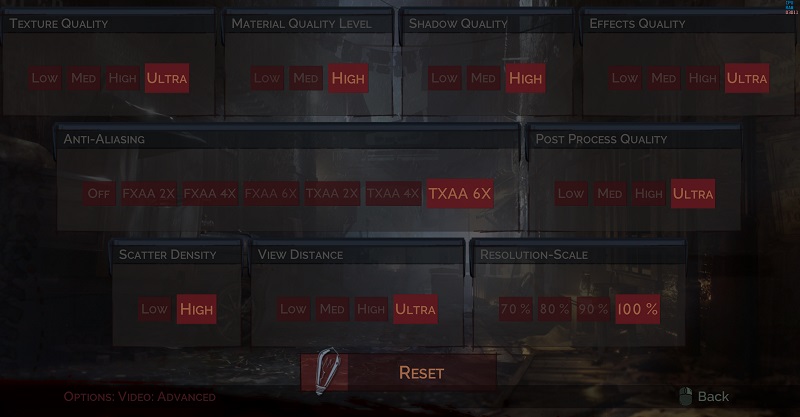

Looking at the graphical options menu we have a mixed bag, we have plenty of options, especially in the Anti-Aliasing department, but we also have no dedicated options for FOV adjustment or Anisotropic Filtering, though AF could be available under the vaguely names Post-Processing Quality setting.
So far it looks like Field of view adjustment is available by modding Vampyr’s .ini files, though again this is something that we will look further into in our full report.

Unlocking the game’s Framerate
To unlock Vampyr’s framerate, players must find and edit the game’s configuration file, Engine.ini, which is located in the following directory.
%LOCALAPPDATA%AVGameSavedConfigWindowsNoEditor
Once found, you must edit the file using a program like Notepad and add the following lines at the bottom of the file.
[/script/engine.engine]
bSmoothFrameRate=false
Once this change has been made, you will find that Vampyr’s framerate will no longer be capped at 62.
