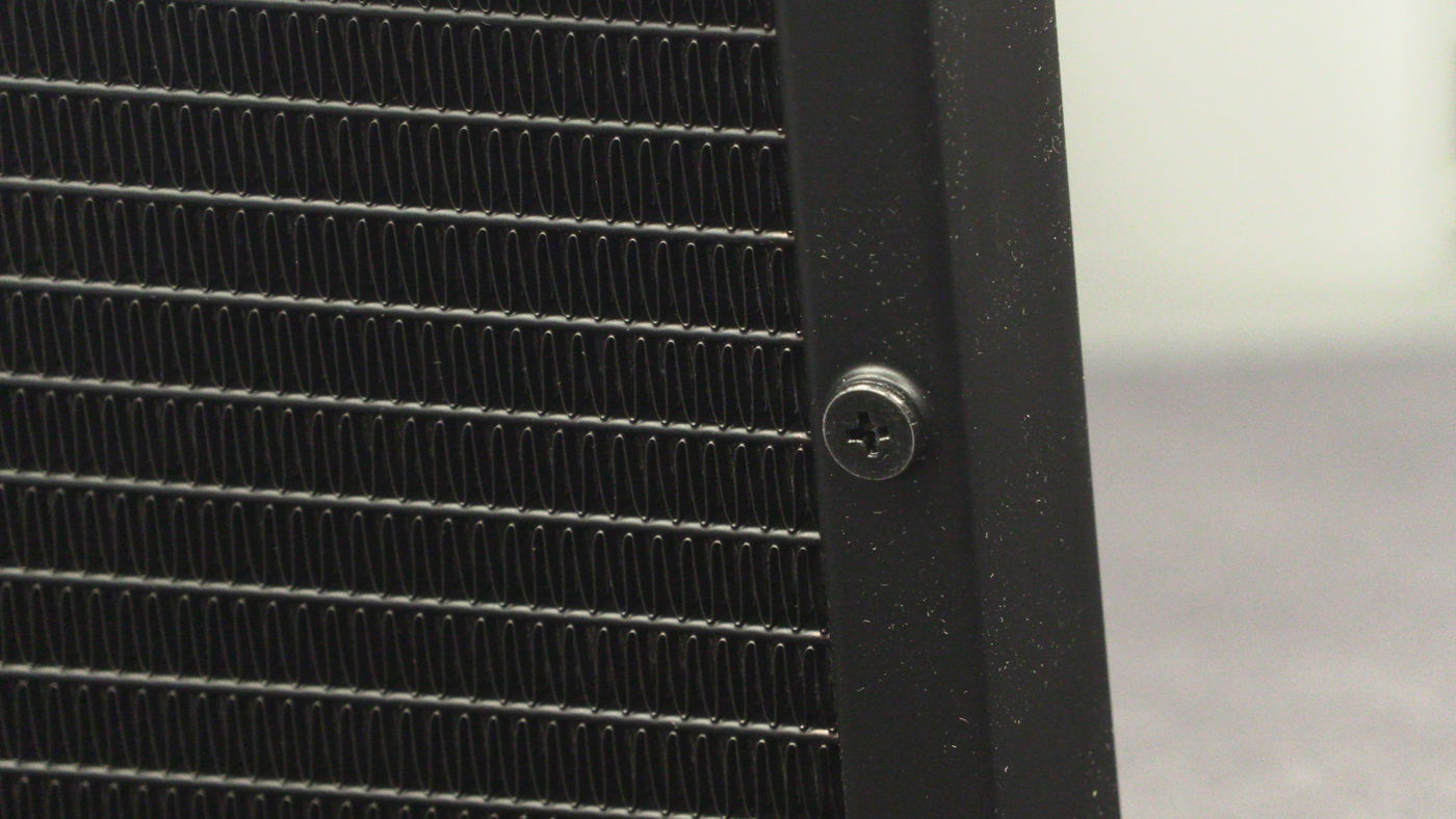

By now you’ve seen enough AIOs to get the jist of how they look. We like the understated aesthetics of the be quiet! Pure Loop 2 AIO, even the simple white identifier on the side of the radiator.

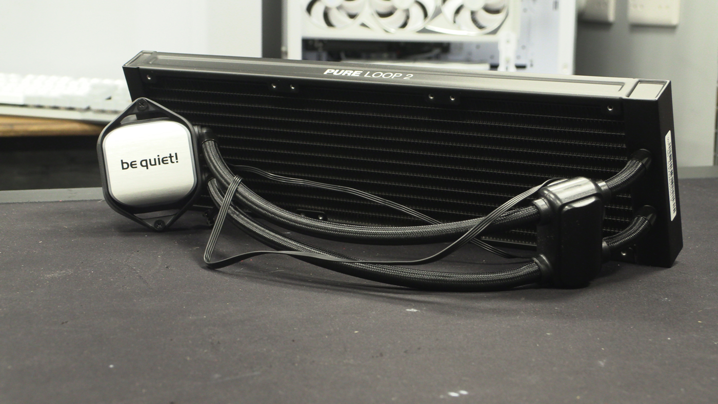

By decoupling the pump both at the pump housing and here in the tubing, the Pure Loop 2 promises to be as quiet as it’s possible to make an AIO pump. We’d expect nothing less from the masters of quiet PC systems. It’s in their name after all.

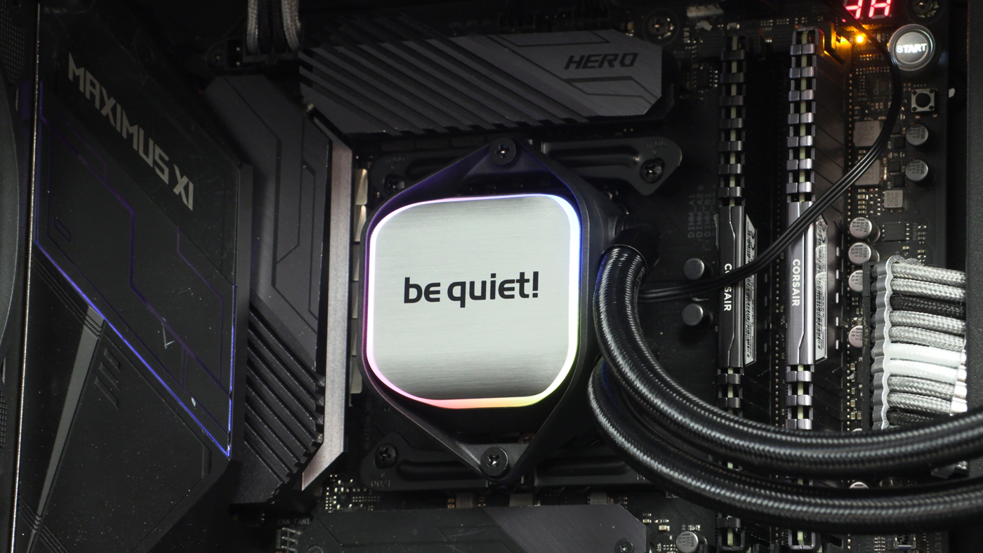

Installed into our famous Maximus XI and the toasty Core i9-9900K we’re all ready to find out how the Pure Loop stacks up against the competition in a number of fan speeds. You can also see how the decoupling of the pump tidies up the CPU area by greatly reducing its footprint.
