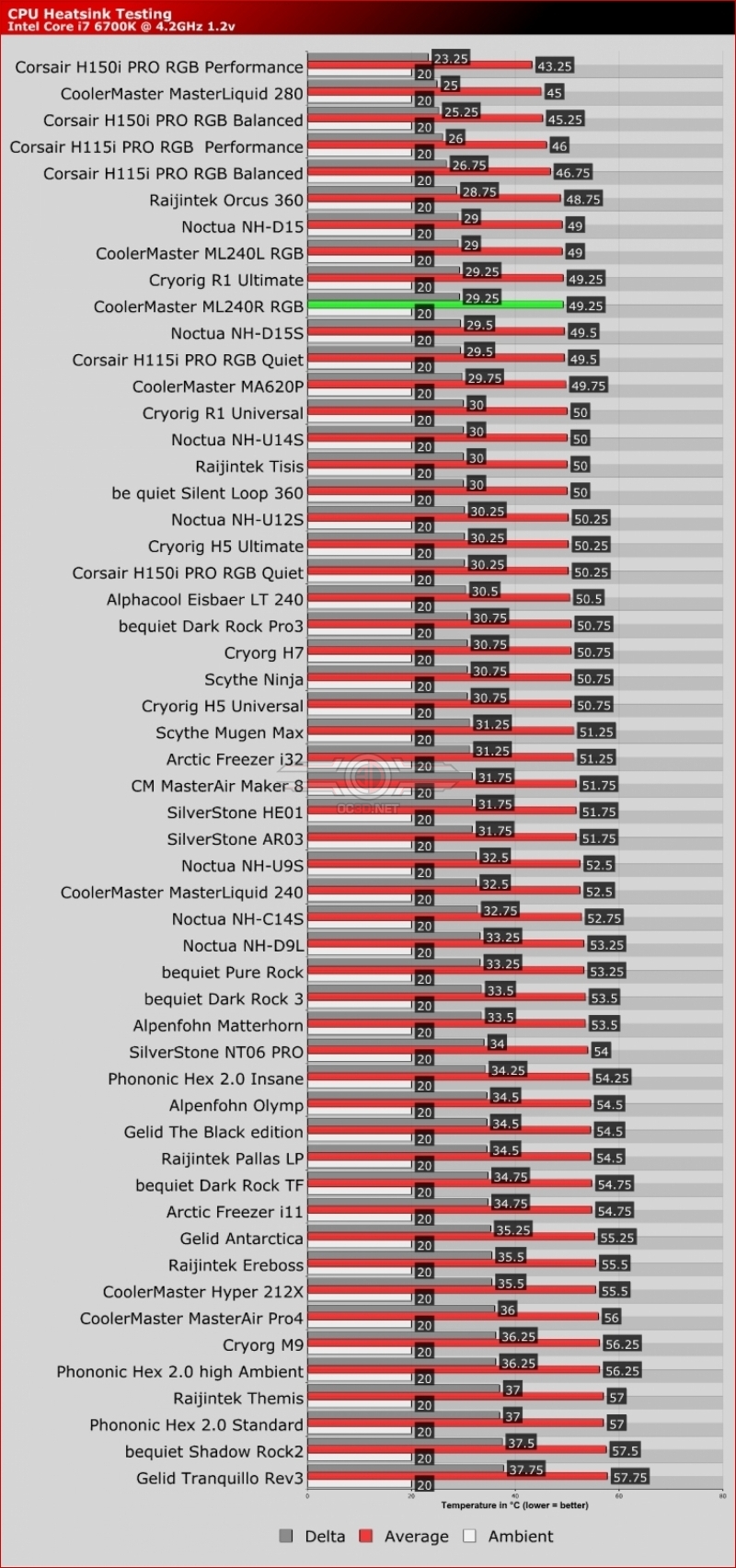

4.2GHz
It makes sense to start with the stock speed, and with stock volts, as this represents a good baseline from which to measure our results. As always, rather than leave the setting on Auto, we’ve actually dialed in the stock voltage we require, in this case it’s 1.2 volts for a nice stable vanilla 4.2 GHz. Although these low volt low overclocks represent a good baseline to start from, they’re not where the actions at, so for that we’ll need to add more volts.

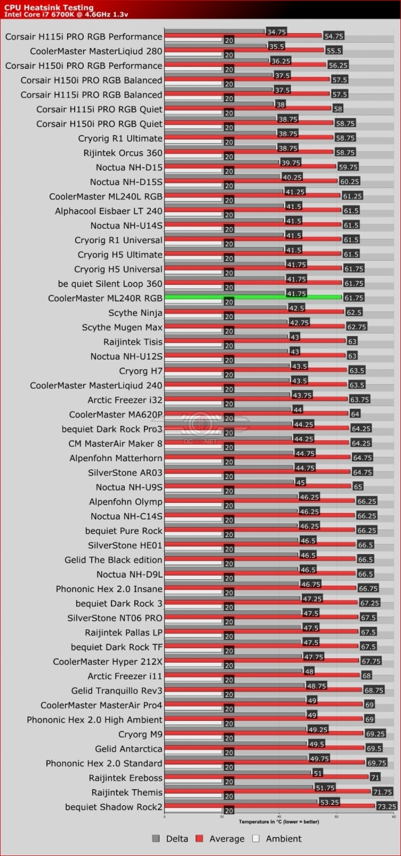

4.6GHz
To get to 4.6GHz we had to up the volts to 1.3Volts At the higher levels of heat generated by the increase in voltage required for the 4.6GHz overclock, fan performance, although still a factor becomes less critical, replaced instead by a coolers ability to conduct the heat up the heat pipes and more crucially the total surface area of the fins enabling convection to the atmosphere. In the case of AIOs and water cooling the surface area of the radiator and the efficiency of the contact plate begin to play more of a factor.

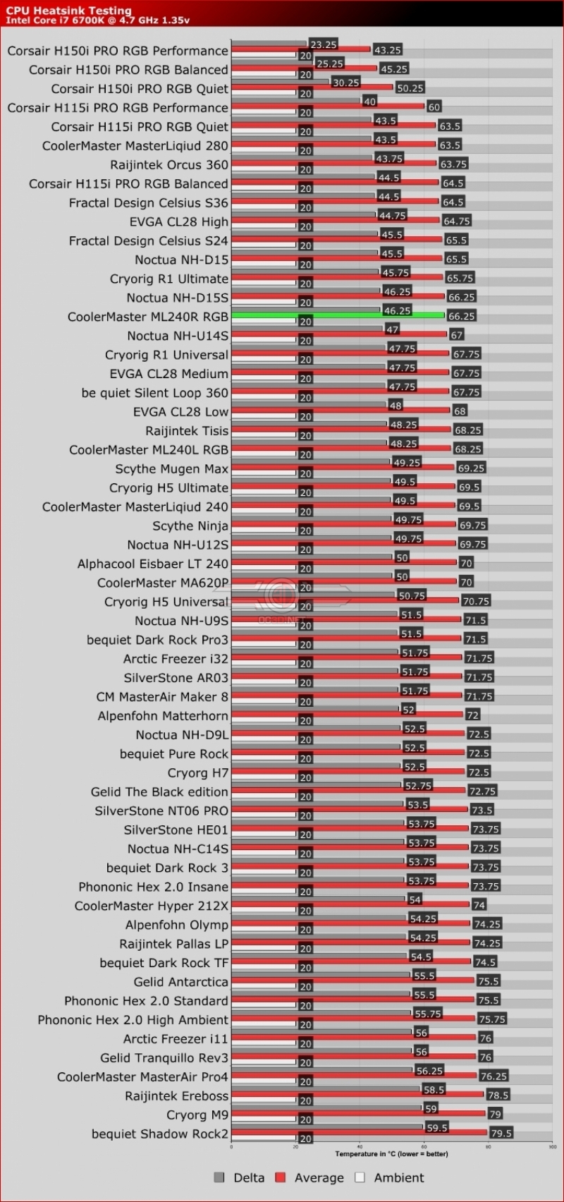

4.7GHz
Skylake if you remember didn’t overclock as well as Kaby Lake and needed a fair few volts for what now seems like a ‘low’ 4.7GHz overclock. We only still run this because we can use the same test rig for it and it helps us still include a lot of results in the graph, if nothing else its great for cross referencing. To be very clear though only the cream of the crop will excel at this level.
