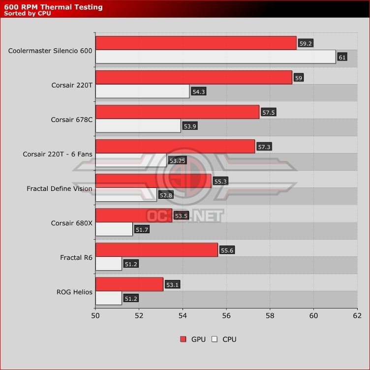

Starting with 600 RPM, we find that Corsair’s 220T RGB Airflow and its included SP120 Pro RGB fans don’t push a lot of air. Both our CPU and GPU temperatures are amongst the highest that we have seen with our current test suite, highlighting the pitfalls of Corsair’s static pressure oriented fan designs. Perhaps airflow-oriented models would have been a better fit.
With this case, we also wanted to see what happens if we fit three additional SP120 Pro RGB fans into this system. Sadly, these fans did relatively little to improve the case’s thermal performance. Scroll down to see how things fare when fan speeds are cranked up.

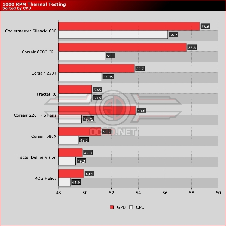

At 1000 RPM, Corsair’s SP120 Pro RGB fans are able to push a lot more air, enabling our CPU and GPU temperatures to drop by a few degrees. Having the case’s three front fans running at 1000 RPM performed better than having six fans at 600 RPM, revealing the weakness of Corsair’s SP120 Pro RGB fans at low RPMs.
When we install three extra fans we find that the thermals of this case remain constant on our GTX 980 graphics card and drop for our CPU.
