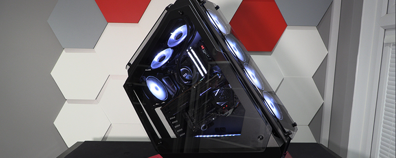

The Kolink Big Chungus is a marmite case; you’ll either love it or hate it based on its looks. Perhaps you are a buyer that just wants a flashy chassis, or someone who wants to say that they have a Big Chungus, all we can say is that it isn’t functionality that will draw you to this colossal enclosure.
We can see a lot of people liking this case’s bulky frame, thick steel construction and tempered glass exterior, especially when combined with the case’s inclined design and out of the box RGB support. For £209.99, this is a flashy case, and it’s rare to get five ARGB fans, and two ARGB LED strips inside a single chassis.

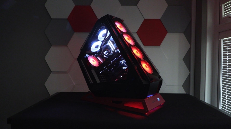

For an asking price of £209.99, we know that this case will never sell in huge volumes. That said, the Big Chungus is designed for those who want to show off, not those who want to build PCs on a budget. For its scale, its integrated RGB support and its incredible amount of tempered glass, the Kolink Big Chungus actually represents great value to the right customers. ARGB fans are expensive, as are LED strips, tempered glass and large steel structures.
We have mixed feelings about the Big Chungus. It has achieved its design brief of “look flashy and support large components”, but it does little else to impress us. The fan controller issues are an obvious downside, and the complex angles in the case can make large water cooling setups challenging, but we know that you can make a great looking system within this case, and if that’s all that matter to you, then go for it.
A lot of case reviewers put function above everything else, but art isn’t always functional. The Big Chungus will be used to create plenty of stellar showpiece systems, but some of the unique aspects of this case can also be seen as downsides, making this a case that’s difficult to recommend.
