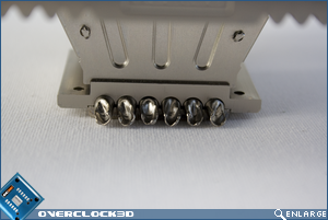

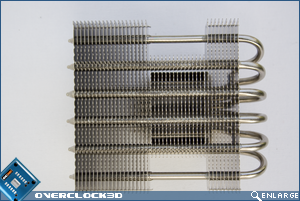

All 6 heatpipes enter the same side of the base and travel fully through it before being pressed shut. The joints between the fins and the pipes is direct and very cleanly soldered. One thing I also noticed was the use of bracing bars traveling through the width of the heatsink, improving its strength and solidity.
Heatpipe Ends  Base Heatpipe Ends
Size wise, the heatsink has a pretty large footprint (towards the top) but is not particularly tall, which would make it a perfect candidate for desktop and HTPC systems, both passively and actively cooled.  With the fan attached the whole cooler does become a bit more substantial and was actually slightly troublesome to install due to the size of other components in the computer, but we will discuss that later.
Heatsink  Heatsink Underside

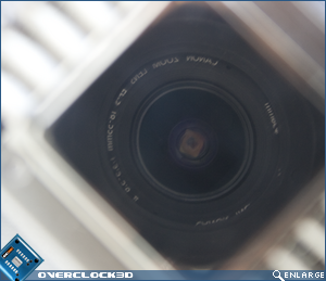

The base of the cooler, while not bare copper, is extremely well polished and when tested with glass and a drop of water, looks to be very flat.
Base
