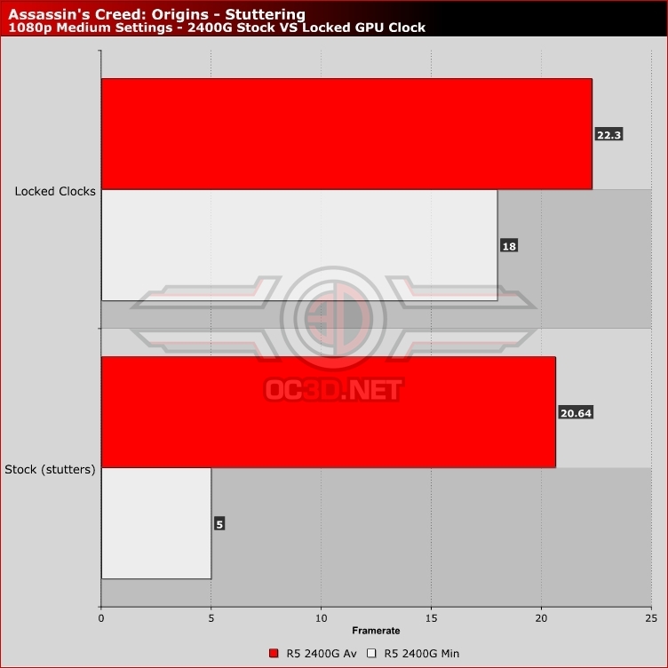

What we found was that AMD’s Ryzen 5 2400G APU suffered from frequent stuttering issues when playing titles which placed a lot of stress on both the CPU and GPU portions of the APU, with Assassin’s Creed Origins acting as a prime example, where frequent stutters would ruin the gameplay experience.

The stuttering here is caused by rapid GPU clock speed reductions, decreases which cause frametimes to spike, causing a momentary judder in gameplay. This issue is not caused by thermal throttling, with our Ryzen 5 2400G sitting nowhere near the APU’s thermal limit. Even with aftermarket cooling, we found that there were no thermal problems to be had.
Right now it looks like this issue is with Raven Ridge’s power management, though the fix for this issue is relatively straightforward. All Raven Ridge users have to do is to go into their BIOS and tell the APU to run at its stock clock speed, with no voltage adjustment required.
In the case of our Ryzen 5 2400G, the GPU’s stock clock speed is 1240MHz, at least then the GPU isn’t in a low power state. All Raven Ridge users will need to do is enter their BIOS and set the GPU’s clocks to 1240MHz manually. This way the APU will maintain a constant clock speed, with the only disadvantage being that the unit will not enter a low power mode at idle.
On our ASUS B350-PLUS motherboard, this setting is under Ai Tweaker in the motherboard’s advanced mode, where the APU’s “GPU Boost” can be defined. Simply change this setting from Auto to Manual and then change the “GFX clock frequency” to 1240MHz. Below is an image which showcases this setting ins ASUS’ BIOS.
This change will force the APU to maintain a constant clock speed, solving our stuttering issue.
