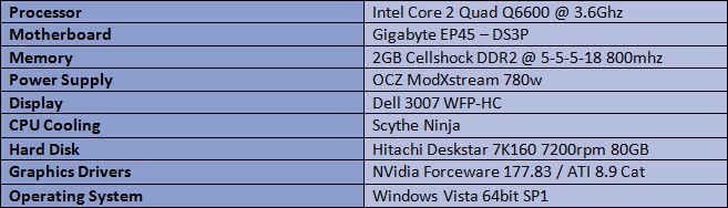

Test Setup
For this review, we will be using a test setup consisting of parts normally found in a mid- to high-end PC. A common mistake made when benchmarking graphics cards is that the rest of the PC system isn’t sufficient enough to test the GPU to its limits. This results in a bottleneck situation, where the system can only run at the speed of its slowest component. For this reason, the test configuration chosen below has been specially selected to give each of the graphics card on test the headroom they require in order to produce the best results. To ensure we had no CPU bottlenecks we also overclocked the Q6600 to 3.6ghz for all of the tests. A fresh Vista installation along with Service Pack 1 updates were installed for each video card, along with the latest video card drivers available at the time of the review.
