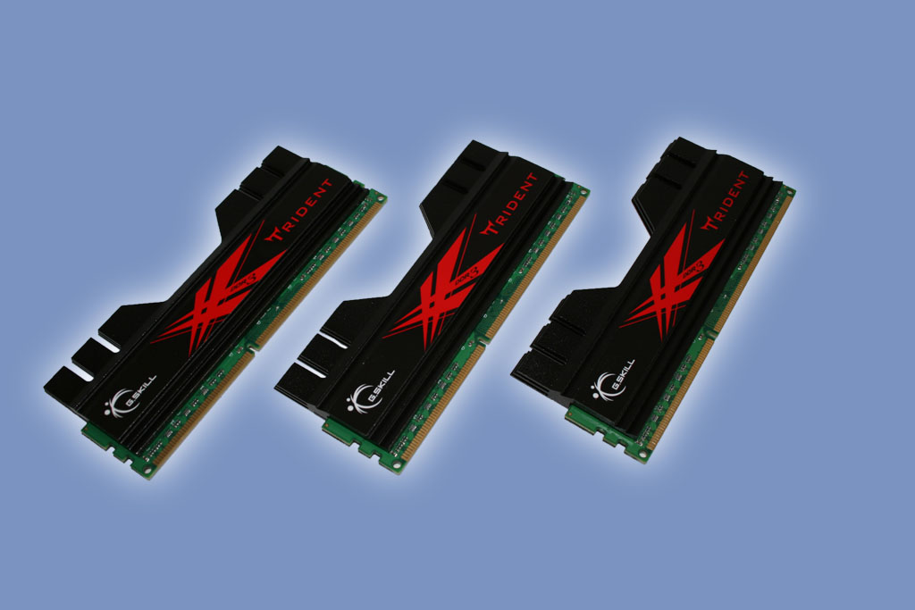

The G.Skill Trident kit does, to coin a phrase, ‘exactly what it says on the tin’. At 2000MHz, nobody can dispute the fact that it is certainly and extreme performance kit. It excelled in all of the benchmarks we ran only failing to beat our current no.1 kit, the OCZ Blade. However, here’s the kicker; it does this at more than half the price! Sure, some might claim that for the best you have to pay top Dollar and for the most part that is true. But one should also consider that there is a point of diminishing returns. Put both of these contrasting comments and what do you get? The G.Skill Trident. The kit hit’s the sweet spot where performance versus cost is concerned.
The kit is is very cheap as far as extreme performance kits go and it wasn’t too long ago that enthusiasts were being asked to stump up the thick end of £300 for a 6GB kit of this calibre. A few months on and kits such as the G.Skill Trident are on the brink of dropping below the £100 mark for the kit I reviewed today can be bought for £118 which is an absolute bargain all things considered.
I was disappointed in the overclocking department as these sticks were as stubborn as anything I have tried. No amount of coaxing would get any benefit over stock despite my best efforts. Were this an average, run-of-the-mill memory kit I would have expected at least a little flexibility but it just goes to show that G.Skill have maximised the potential of this kit.
While the timings are slack, this did not have too much of an effect on the benchmarks I ran today and while this kit is not the flagship product from G.Skill, I think I have shown it to be the kit where the wise money would go if you are looking for cost versus performance. In short, G.Skill have thrown down the gauntlet to other manufacturers to lower the price of high end DDR3 kits by producing what is in effect one of the fastest 6GB kits on the market for a mid range price. So if you are not looking to pay the premium prices that tight latency demands, you could do a lot worse then lay down your hard earned for 6GB kit of G.Skill’s Trident memory.

– Price
– Gorgeous heatsinks
– Stock performance
– Lifetime warranty
The Mediocre
– Green PCB
The Bad
– Overclocking headroom – there is none.
