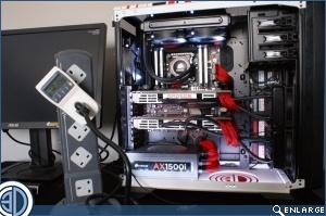

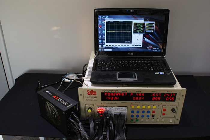

As you’d expect with any high quality unit, the AX1500i carries the 80 Plus efficiency rating. However, this is one of the few units that carries the Titanium rating. This is one of the highest ratings we’re ever seen on a power supply. The previous AX760i, AX860i and the AX1200i all carry the 80 Plus Platinum rating which has previously been the best efficiency rating that we’ve seen, and it’s incredible to see that Corsair have managed to gain an extra few percentage points (up to 94%) of efficiency out of the AX1500i. Also, in our testing, when we were pulling 1200w from the AX1500i, we saw only 9mv of voltage ripple. The rated specfications for an ATX power supply is currently 120mv, which really shows just how much of a high quality product this is.

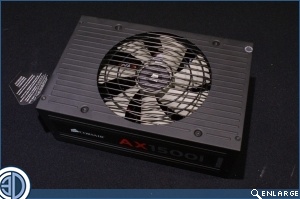

Another feature that we’ve been accustomed to on the power supplies from Corsair has been a silent fan mode. This means that up to 30% of load, the power supply’s fan won’t spin up at all. Of course, if you’re running a 500 watt unit, this means you’ve only got headroom up to around 150w before the fan kicks in. However, with a unit as large as the AX1500i, the 30% gives you up to 450w whilst remaining entirely silent. This means you could be running a reasonably high end gaming system on the AX1500i and even under load the fan may never need to spin up.

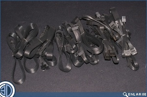

Of course, the AX series has always been fully modular, and this is no exception here. The fully black cables allow for the PSU to colour match with almost any system, and as with all modular Corsair units these days, options for coloured individually braided cables will be available if you did want to make your system even more unique.

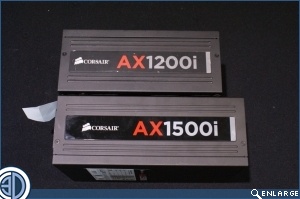

We think Corsair going up from 1200w to 1500w has been an interesting decision. Of course to the vast majority of PC users, they’ll never consider anything of this high calibre. However, it definitely does serve its purpose. Benchmarkers may benefit if they’re wanting to run the latest high end system with mutliple graphics cards, along with everything overclocked as high as possible. Also, with the recent influx of Bitcoin mining systems which can run even more than four graphics cards in the same system, a 1500w power supply may be a perfect option for that. Also, people like this will have efficiency in mind if running any form of system like that, and the AX1500i’s Titanium efficiency at 94% definitely makes Corsairs latest flagship PSU more attractive.
