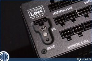

We’ve seen on the AXi series how helpful the Corsair Link connectivity can be for users who enjoy monitoring every aspect of their PC. The software allows you to check the fan speeds of the unit, as well as real-time monitoring of the voltages and watts that your system is pulling from the wall. If this is used with other Corsair products such as the H100i, or the Corsair Link Commander, you can also monitor and control many more components in your system.

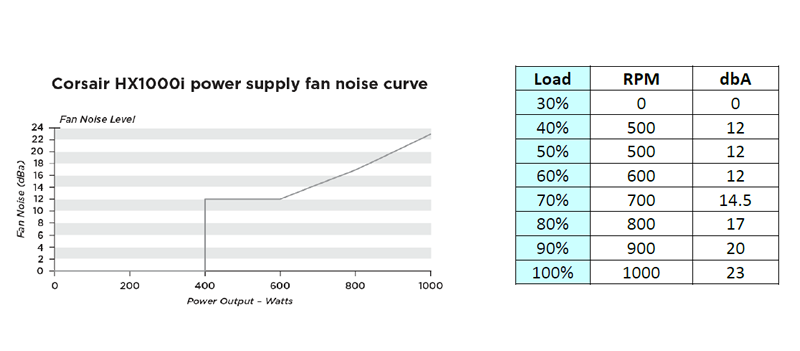

The HX1000i comes with an 80 Plus Platinum Rating with all Japanese capacitors meaning it’s efficient up to 92% at 50% load, and close to 90% efficient at both 20% and 100% loads. Along with this, we also see the zero RPM fan feature that we’ve seen on many other units which allows your PSU to run completely passively up to around 40% of its load. This means in most cases the fan in your power supply will remain entirely silent until you do something particularly strenuous on your system such as gaming or benchmarking.
