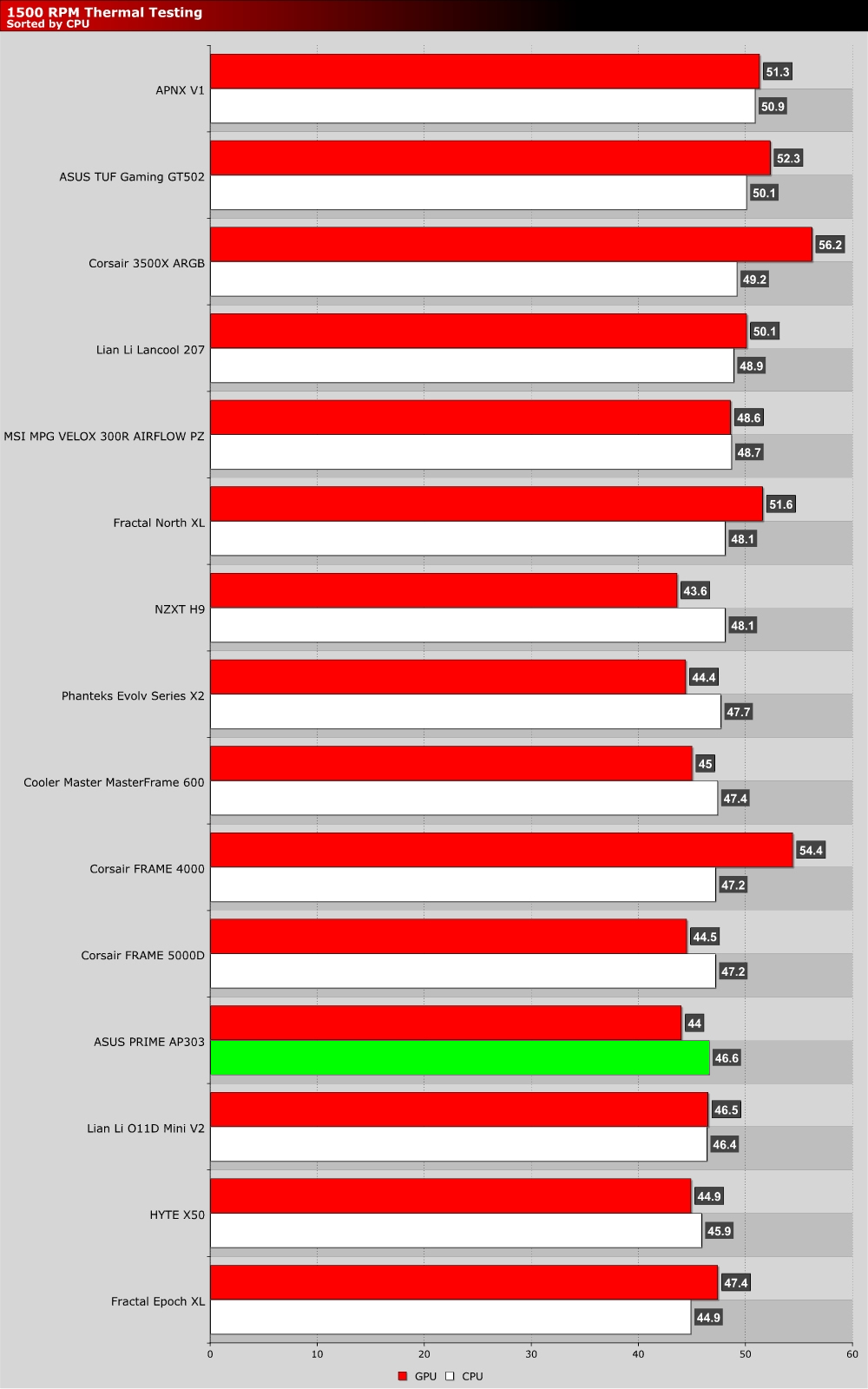

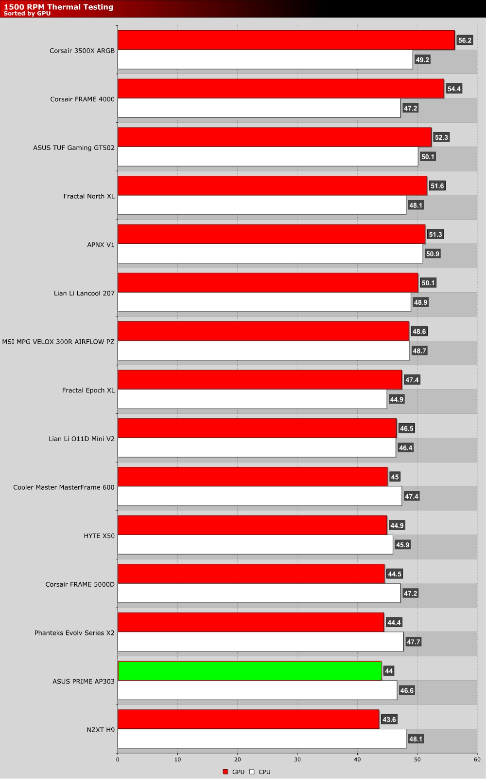

1500 RPM Testing
At 1500 RPM fan speeds, the ASUS PRIME AP 303 is one of the best-performing cases that we have tested. Great results.

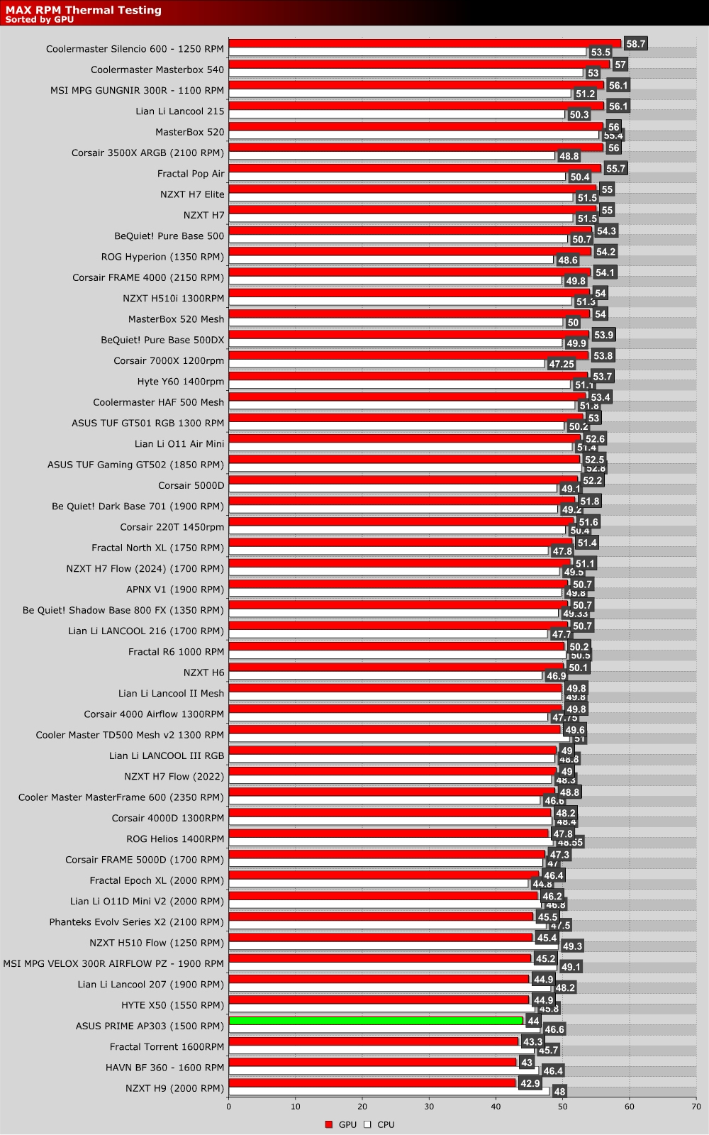

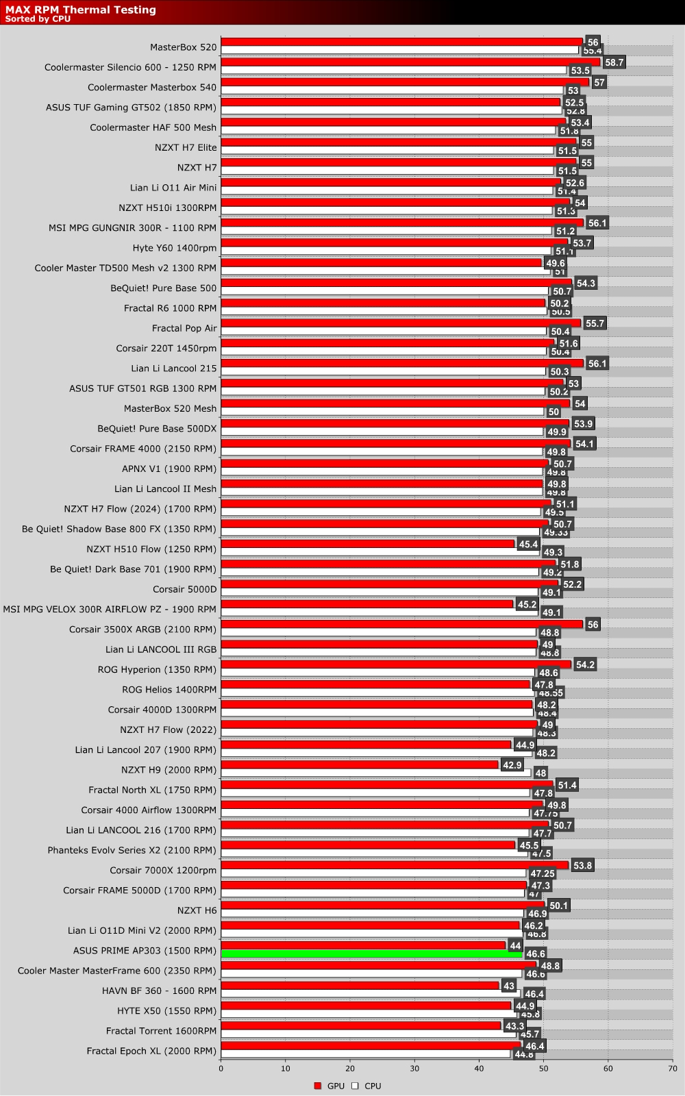

Max RPM Testing
The maximum fan speed for the fans we used was 1500 RPM. That means that the ASUS PRIME AP303’s performance is unchanged from the above graphs. That said, every other case got to benefit from higher fans RPMs. Despite this, the AP303 delivers strong results. It remains one of the better-performing cases on the graphs below.
