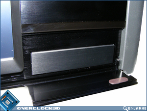

Located at the bottom of the front panel is a drop down cover, which is opened by pressing on it at the bottom right. It opens smoothly to reveal the front I/O sockets and a single 3.25″ drive bay. The available sockets are:
- 2x USB2.0
- 1x IEEE1394
- 1x Audio in
- 1x microphone

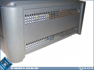

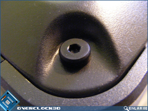

Moving around the case, we will now take a look at the sides. Each side is finished in the same colour as the top panel and metal corners. Next, the top panel, which is the access point for the case innards, and is secured in place by four hex nuts in each corner. Considering the likely placement of the built system is going to be under your display on a stand, there was no need for the bling factor on the top and sides, and the finish of these does tie in well with the rest of the case. The side panels are vented, using a square cutout pattern, which should help with air flow within the built up PC.
