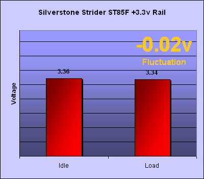

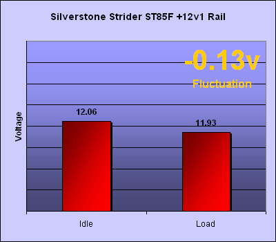

In order for the results from all current and future PSU reviews to remain fair and comparable, Overclock3D uses a custom built Power Supply load stress tester. The tester will be placing the following loads on each of the Strider’s rails:
| Idle | Load | |
| +3.3v Rail | 10a | 20a |
| +5.0v Rail | 10a | 20a |
| +12v1 Rail | 5a | 20a |
| +12v2 Rail | 5a | 20a |
As some power supplies produce obscure voltage outputs when running with 0% load, the Idle testing simulation will be produced by placing each rail under a small load similar to what would be expected from a mid-range PC. Load testing results are obtained by placing the unit under the maximum load selectable on the OC3D equipment without tripping the OLP (Over Load Protection) on the power supply.

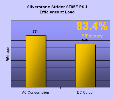

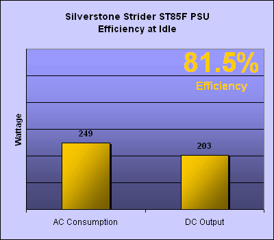

Efficiency Testing
Efficiency tests are performed by measuring the wattage consumed by the power supply at the mains against the power (in watts) consumed by the OC3D power supply stress tester. These results may not be 100% accurate, but have proven to be extremely close to results obtained from professional equipment.
Increasing the load on the unit produced even more favourable results, with the ST85F managing 83.4% efficiency when being placed under a total load of 646 watts.
