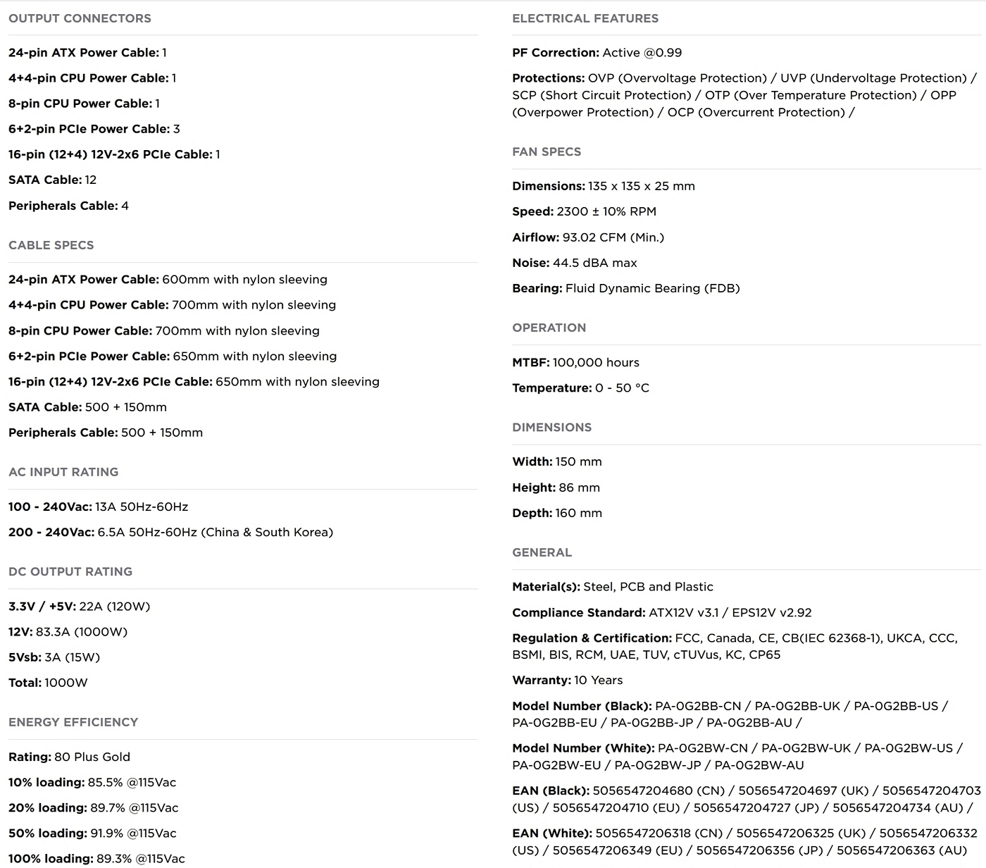

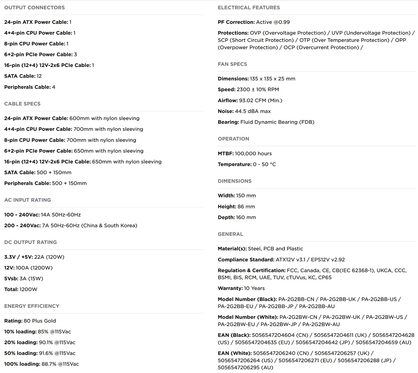

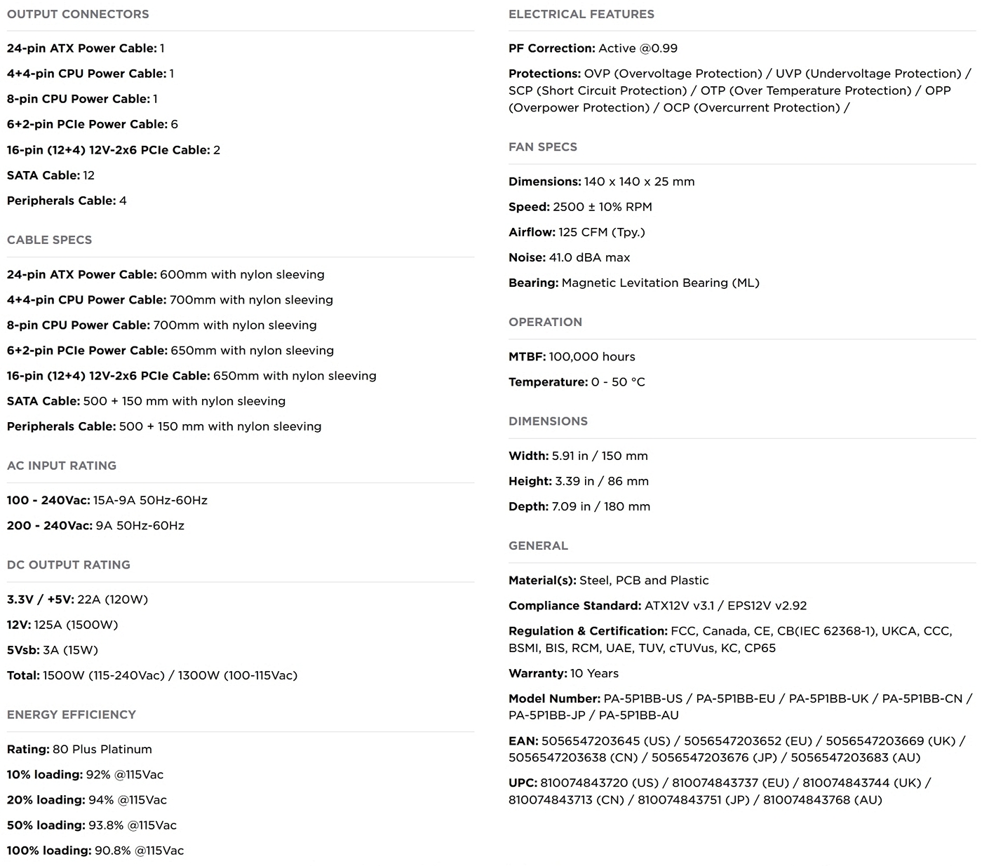

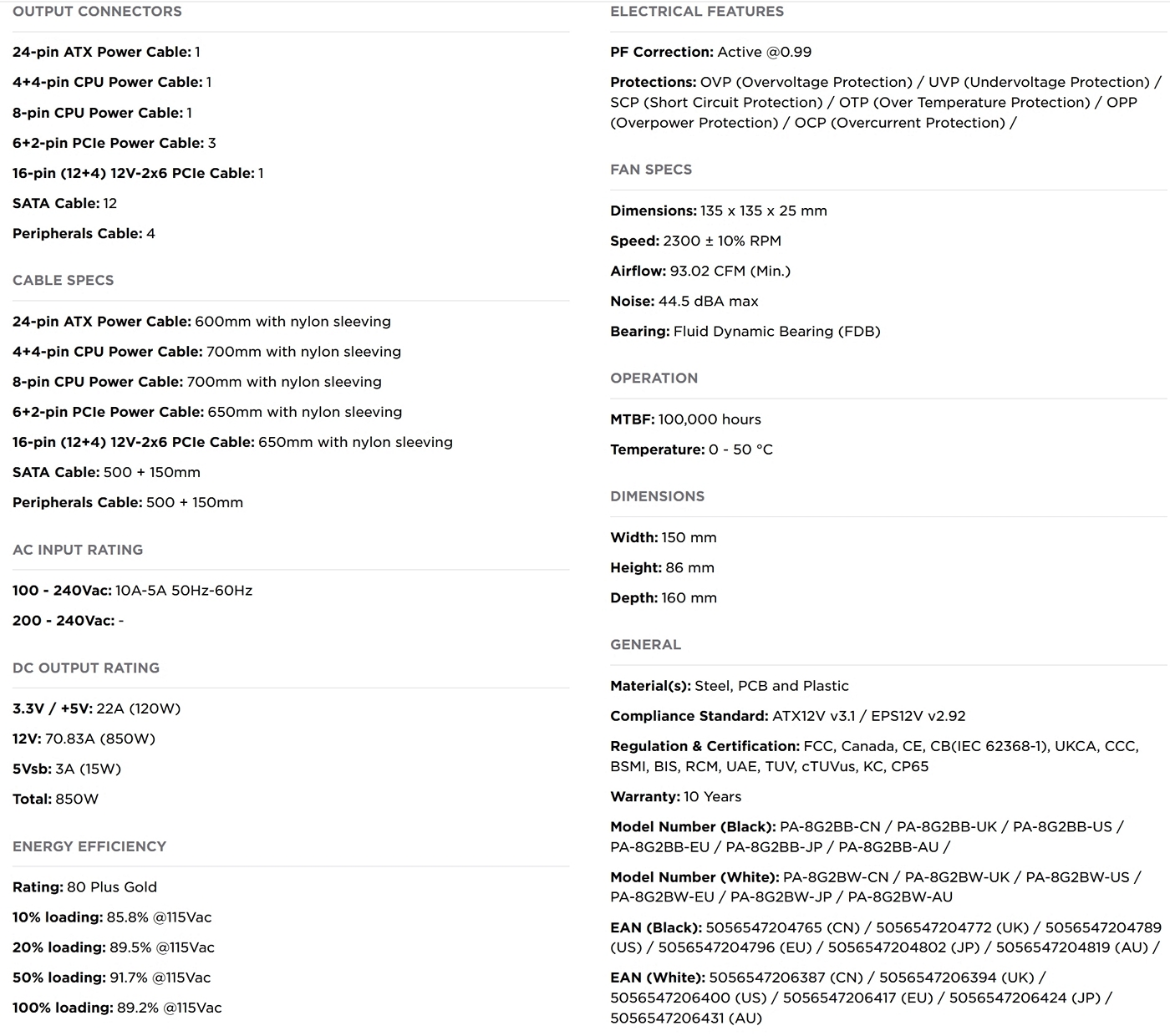

There is very little to choose between the three C Series Gold power supplies, other than the total wattage and the energy efficiency (found on the bottom left of this table). Nonetheless we’ll show you them all in case you prefer to see how identical they are with your own eyes. The C1500 Platinum at the bottom is a step up, with a bigger chassis and better efficiency.
Things that are worthy of note. The C850, C1000 and C1200 are all available in both black and white, whilst the Platinum C1500 is black only. Secondly we get a lot of people asking about cables. NZXT very kindly provide the number and lengths of the cables in the box in the specs. As you can see below. The C850 for example has three 6+2 pin PCIe power cables of 650mm length. So if that’s your bag, pay attention to the tables below.
